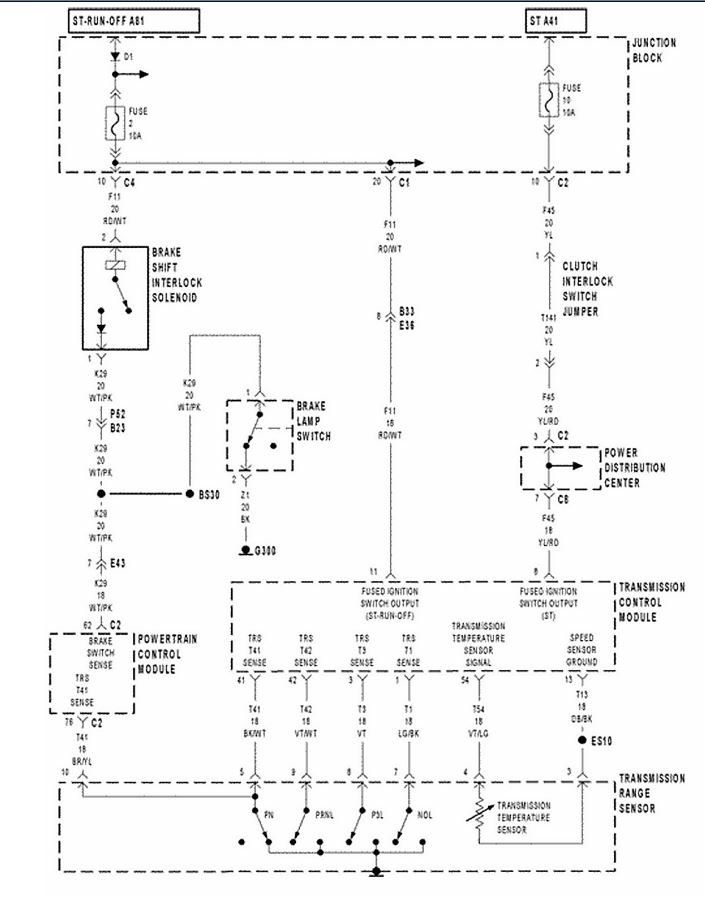

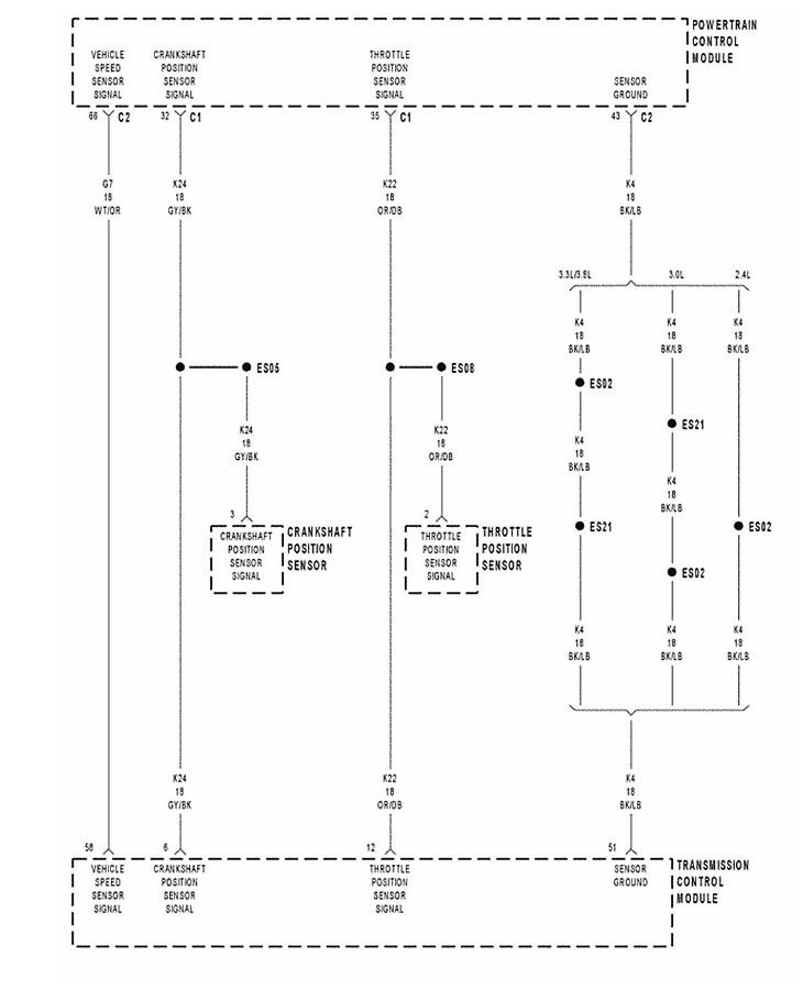

I am looking for the transmission harness diagram for the car listed above base model.

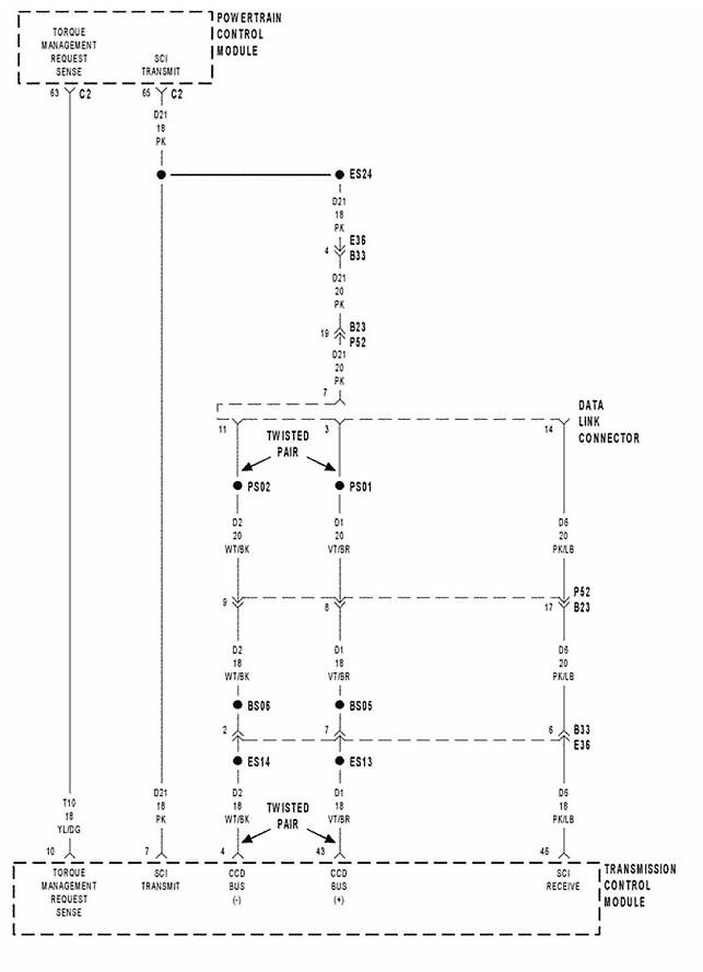

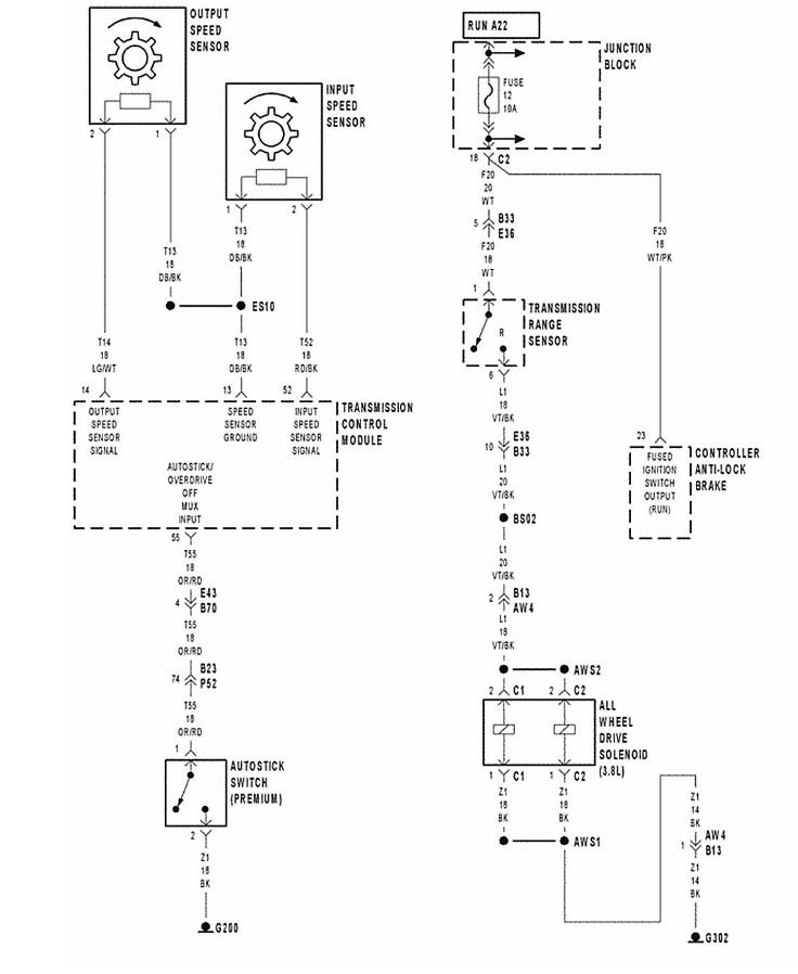

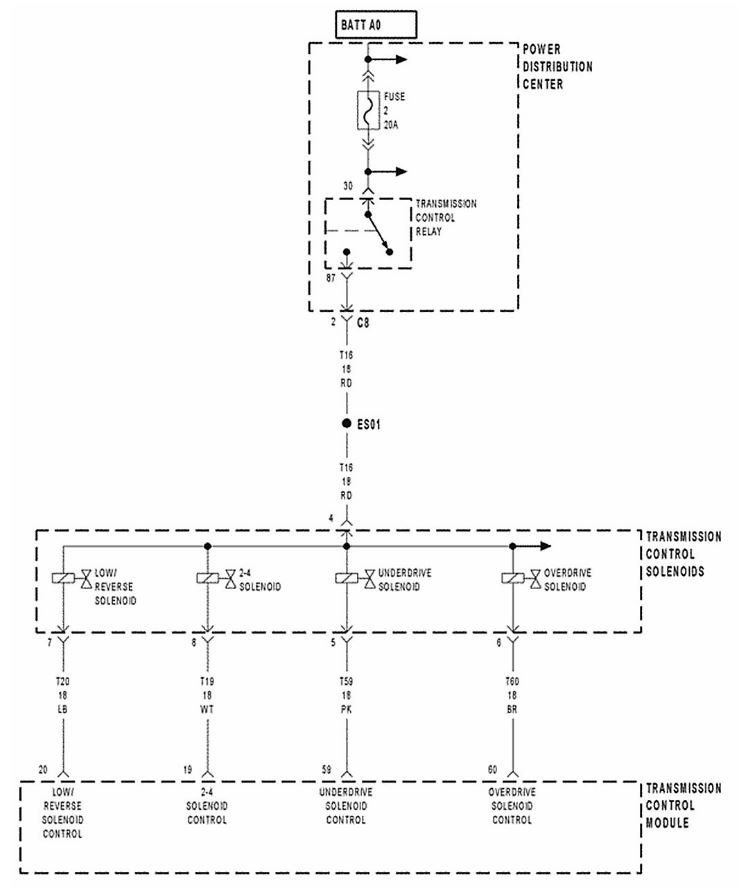

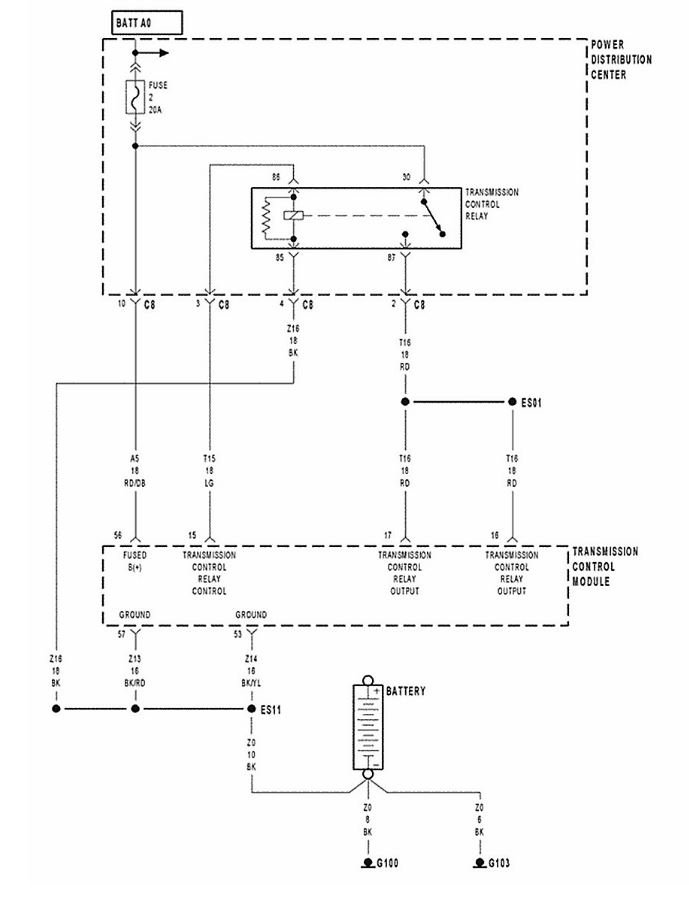

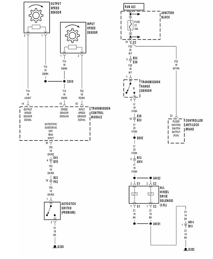

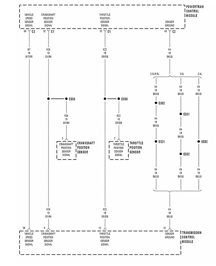

Welcome to 2CarPros. This is the transmission control harness. There are other wires in that harness as well. but these are the transmission controls. Check out the diagrams (Below). Please let us know if you need anything else to get the problem fixed.
