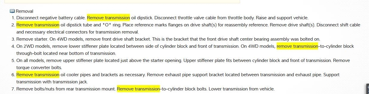

I just want to know if you have to remove the engine to take out the transmission. I have to replace the rear main seal.

Trans comes out independent to engine see pic for details.
Image (Click to make bigger)
