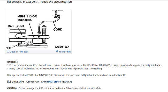

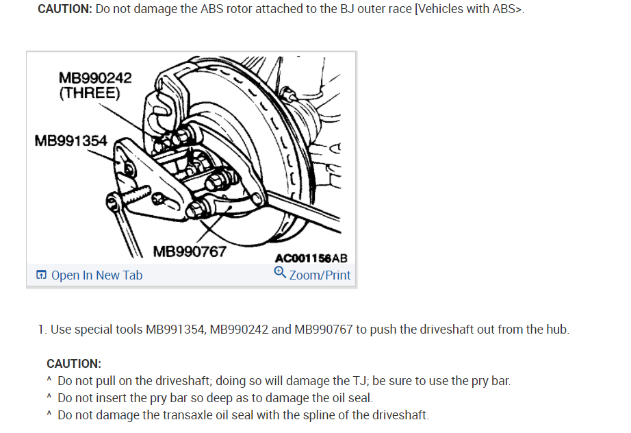

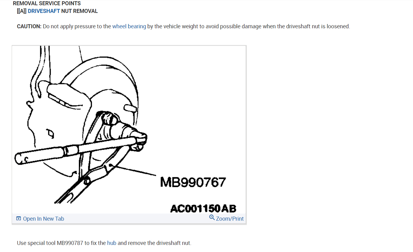

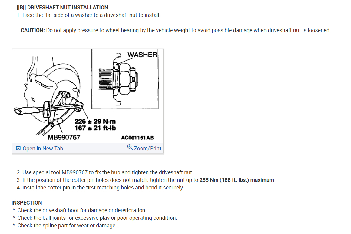

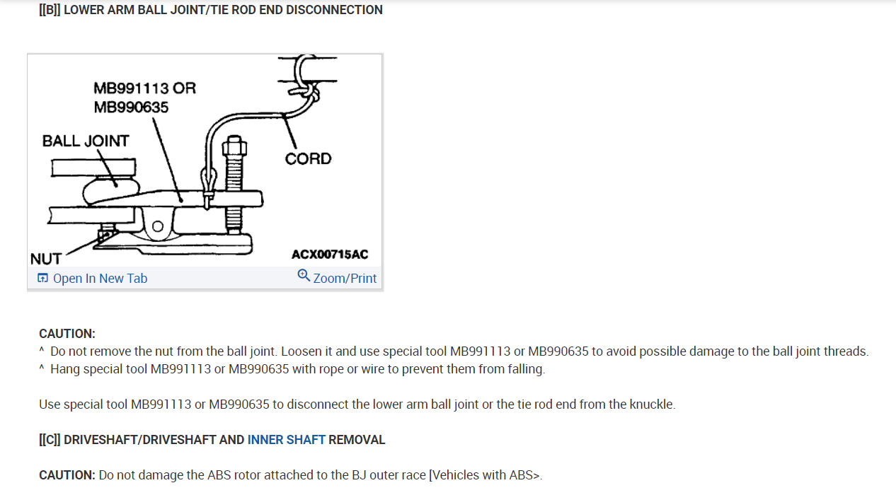

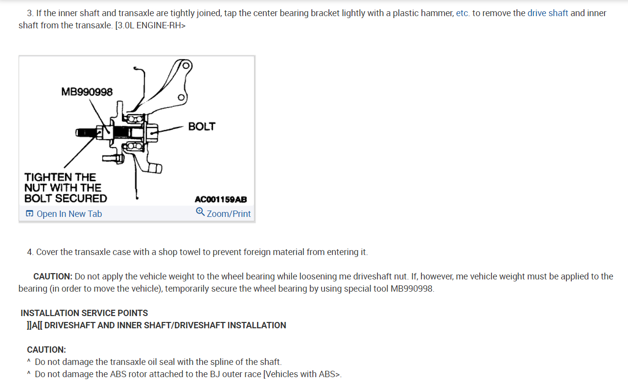

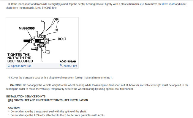

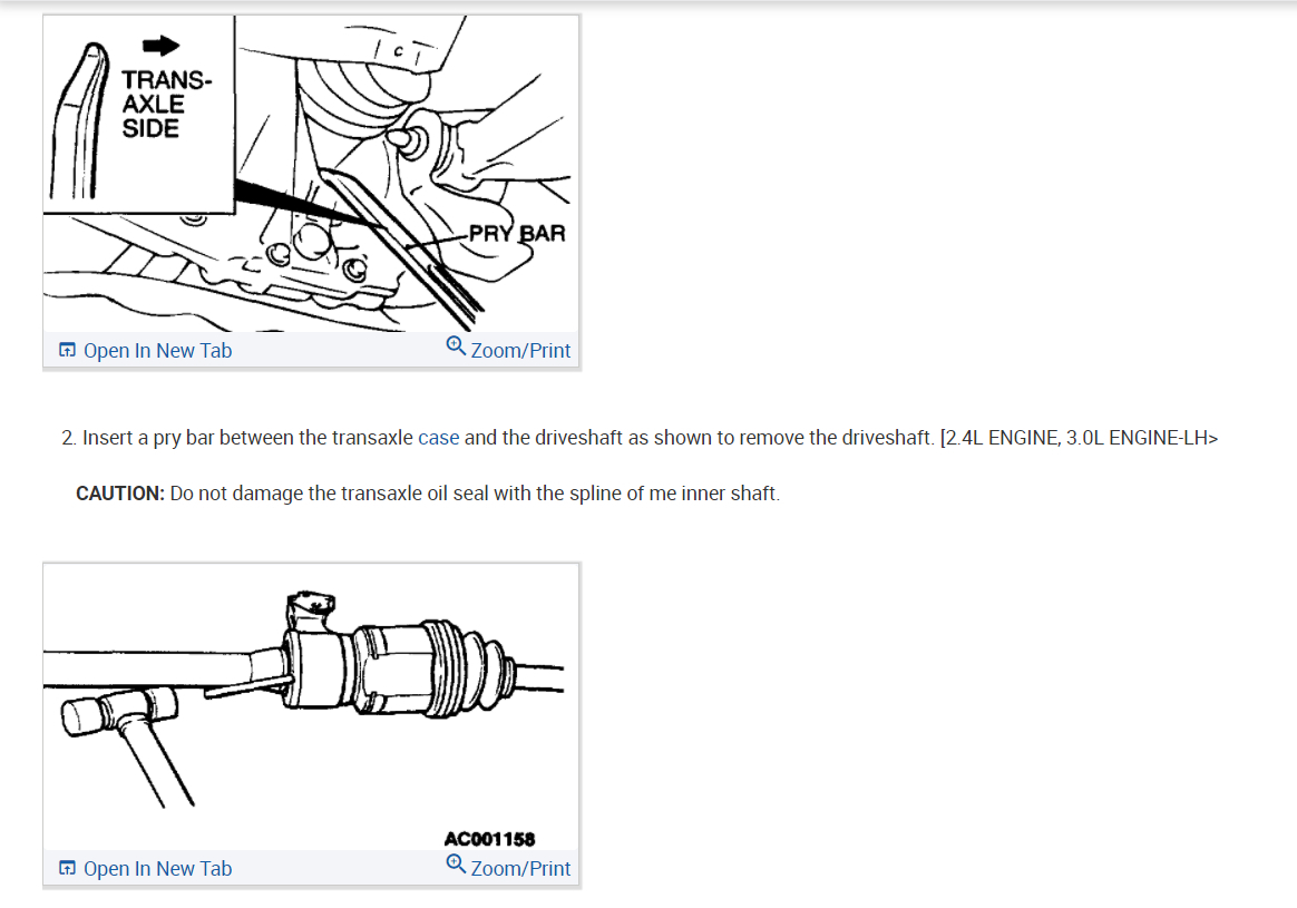

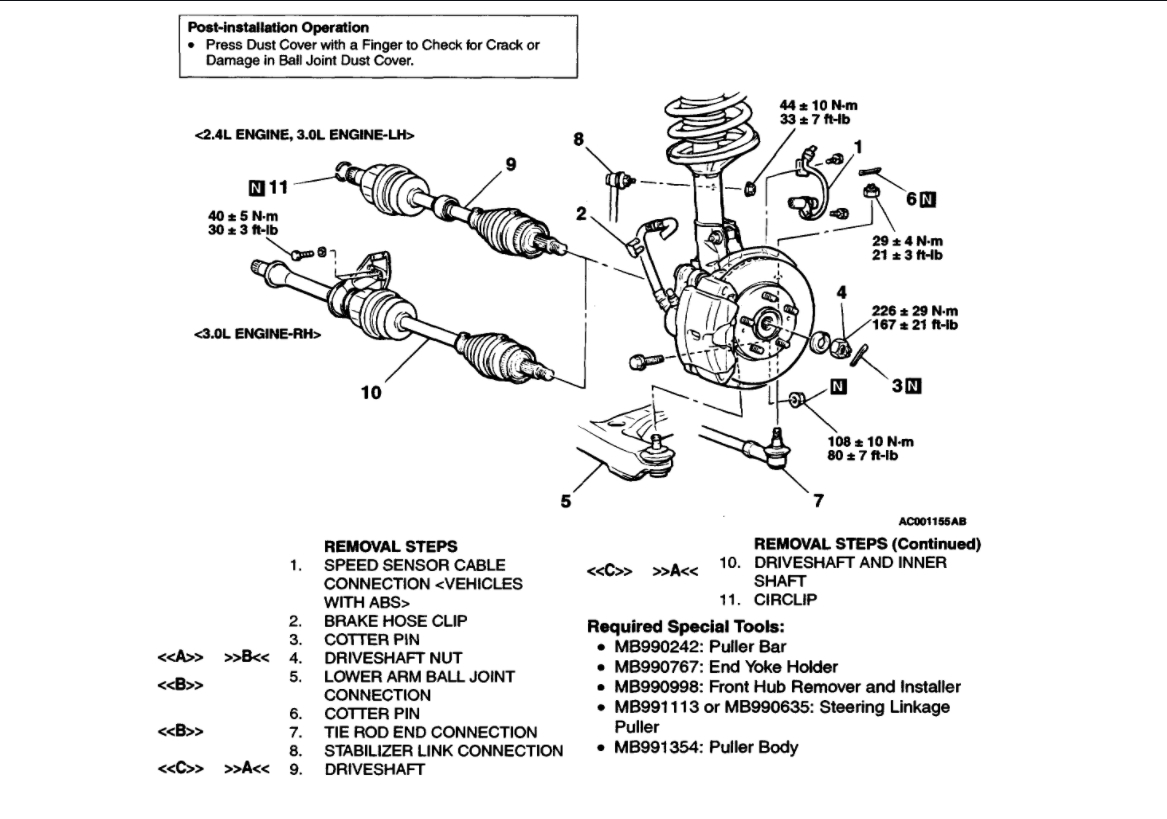

The most common issue with this grinding and no movement is one of the front axles has failed. If one axle is bad, it will not allow the car to move at all.
https://www.2carpros.com/articles/replace-cv-axle
I attached the procedure for replacing the axle shafts below. Inspect the axles to determine which one has failed.
Make sure you get it aligned when you are finished.

You can just replace the failed axle. Check the boots for any damage or leaking
You need to jack up the front end and put it on jack stands. Then start it up and put it in gear and see which axle is turning but the wheel is not turning.
