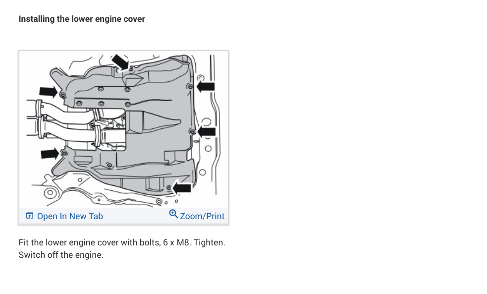

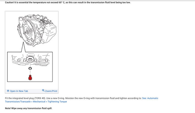

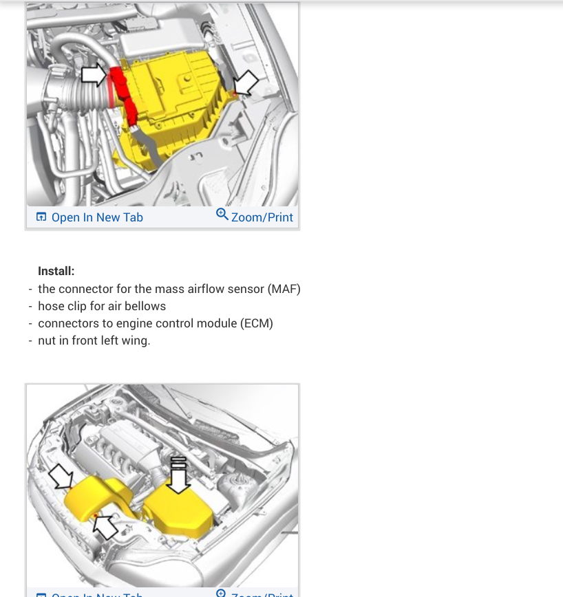

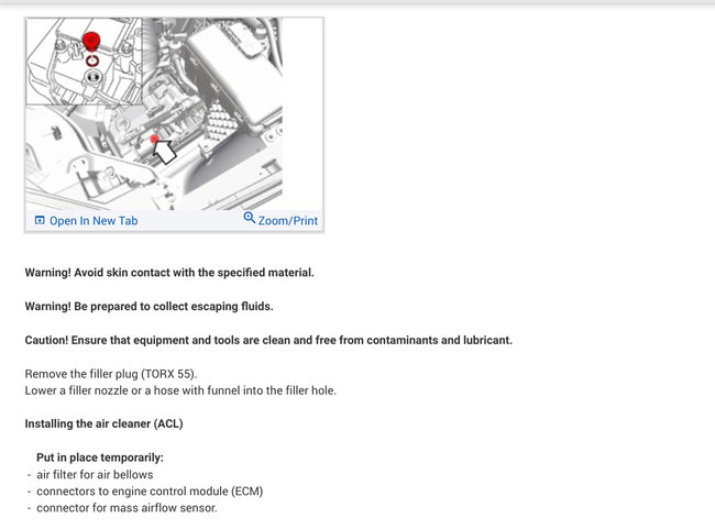

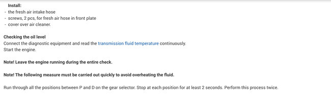

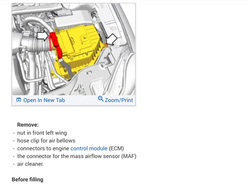

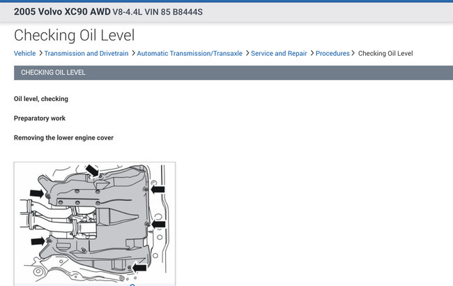

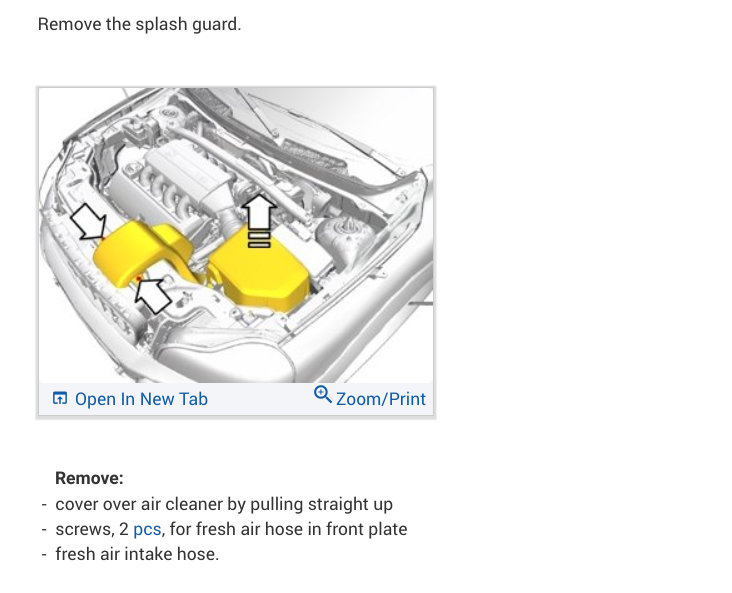

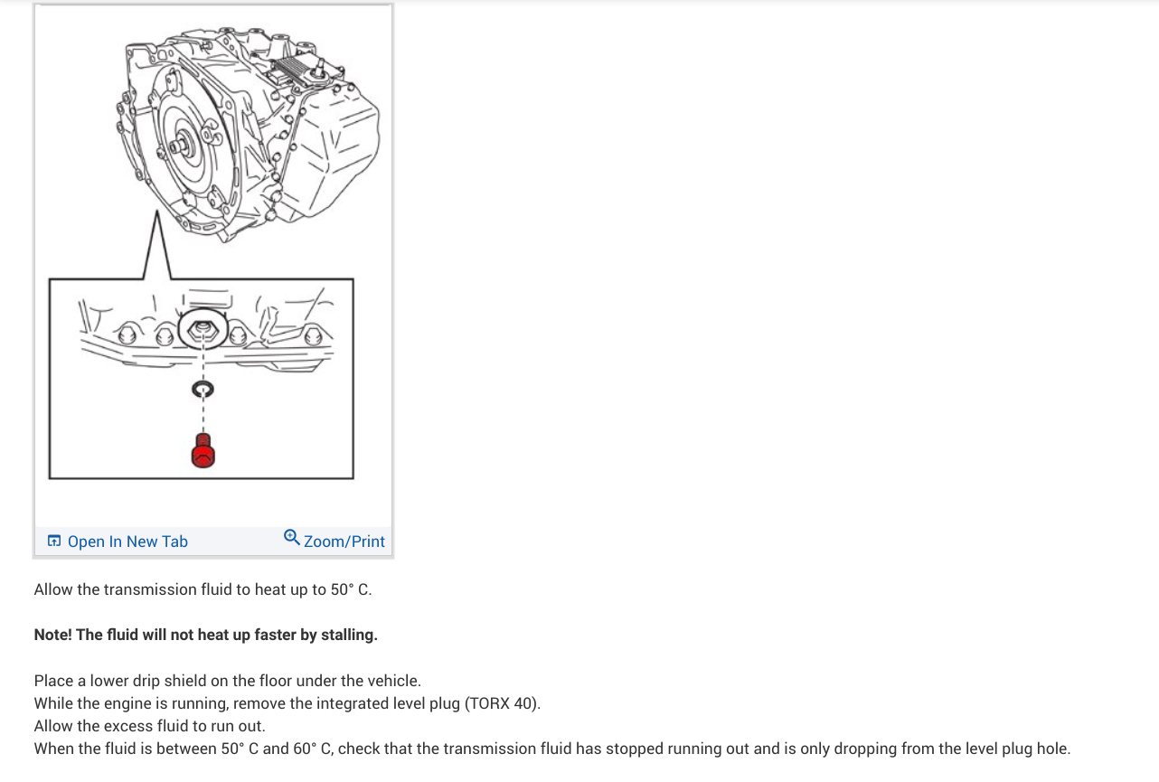

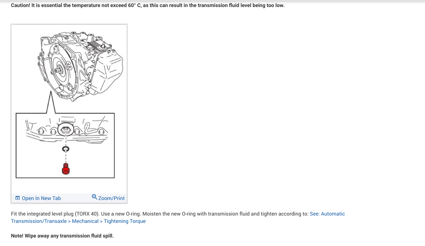

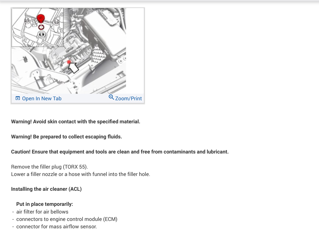

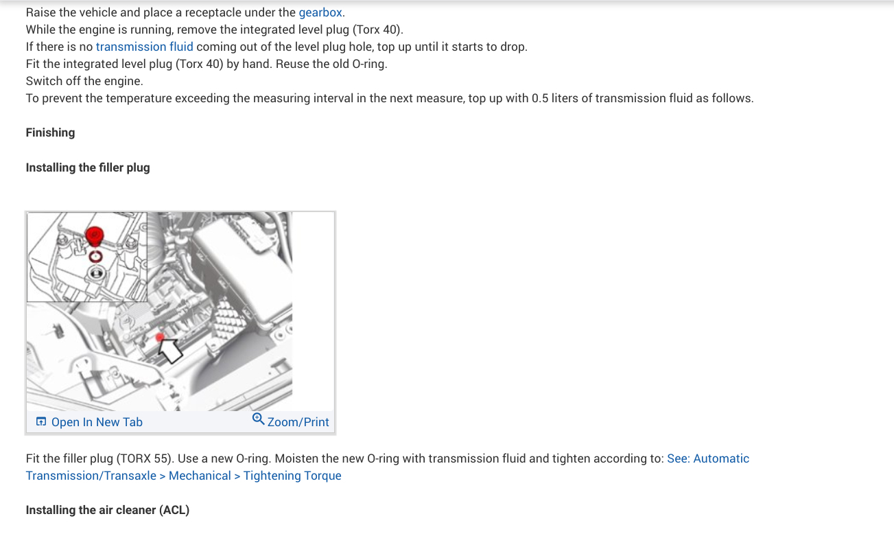

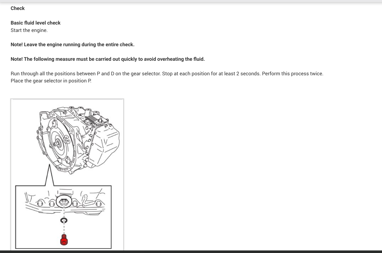

Trying to find the right temperature after filling cold before i can remove the small torx and fill more. can you find it for me?
Dec 18, 2019 at 6:31 AM
SCGRANTURISMO
  • 4,897 POSTS
In the diagrams down below I have included the instructions from the vehicle manufacturer for checking and filling the transmission fluid in your vehicle. Please go through this guide and get back to us with how everything turns out. I hope that this helps.
