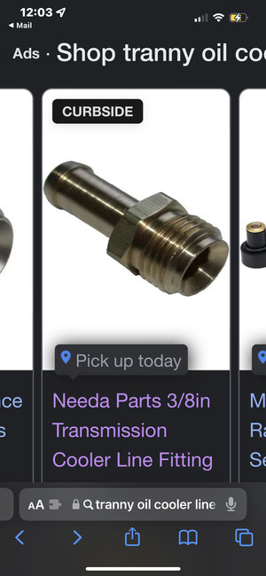

Is there an adapter or some type of connector to help with this? Something like the picture below? Or would it not connect from the end of the cooler line into the radiator inlet?

The lines should just push in, it's possible they put the wrong fittings on the radiator, do you still have the old one? Maybe measure both to see if they are wrong or if you can swap them over to make it work. There are a lot of different sizes of tubing but the most common thing would be if they installed an SAE sized connector when the Benz uses metric.
