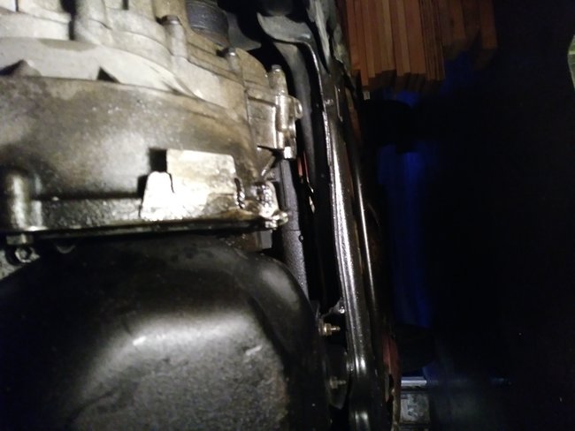

Put gear oil in and now leaking from bell housing.

You need to remove the transmission and install a new input shaft seal. This should cost about 700.00 if you were to take it into a shop.
