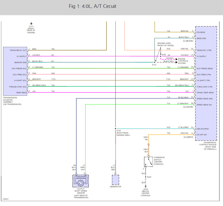

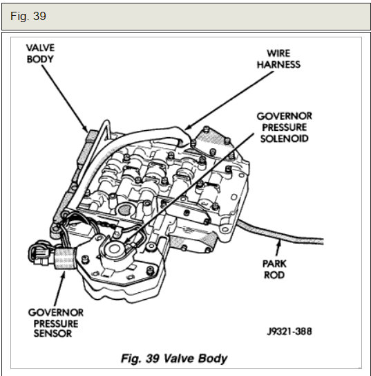

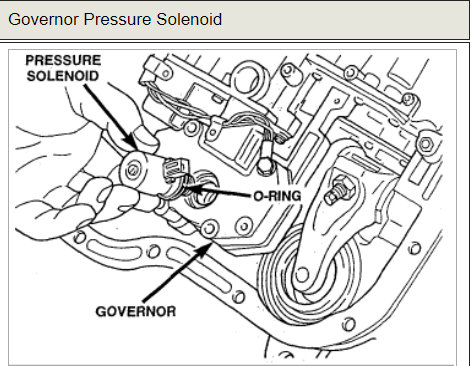

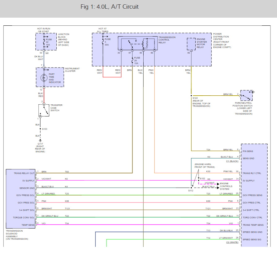

Possible shift solenoid, leaking transmission fluid and will not shift from second to third. Any help is appreciated and if you have instructional pictures on repairing the problem please send those too.
Jan 22, 2018 at 7:36 AM
  • 55,748 POSTS
These transmission had a problem with the governor solenoid you must remove the pan which is sounds like it is leaking away here is a guide to help you see what you are in for when doing the job.
