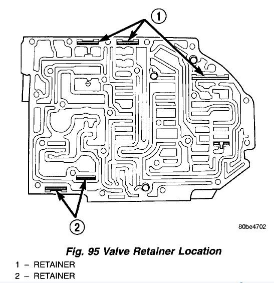

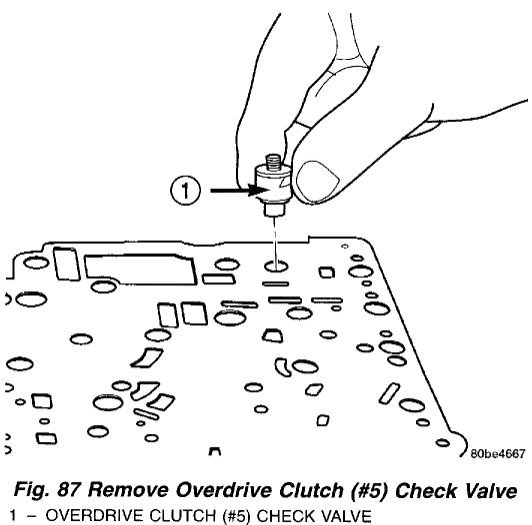

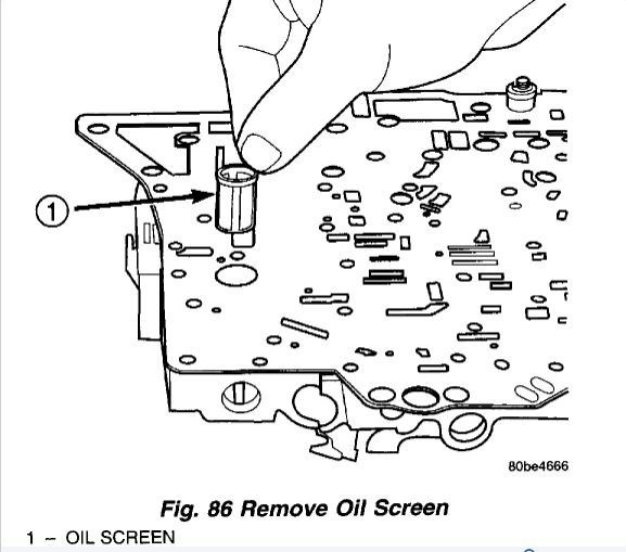

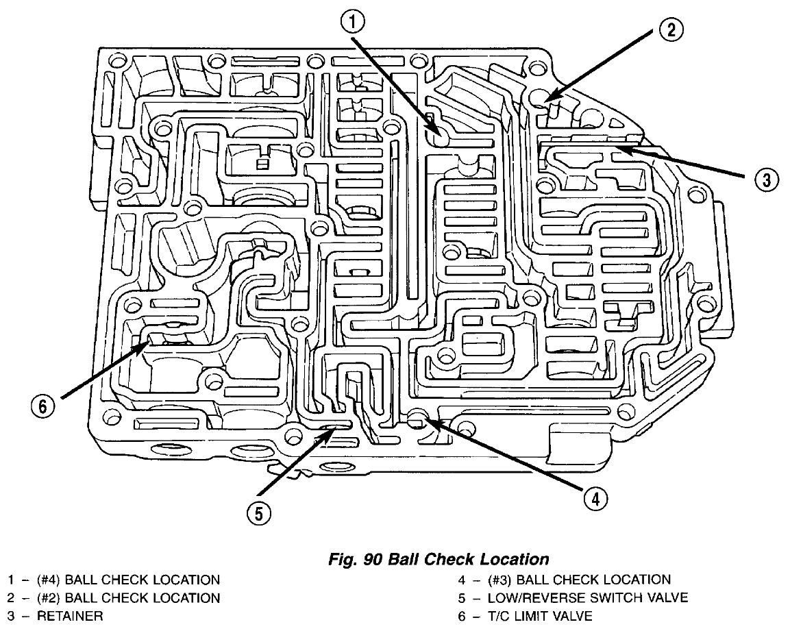

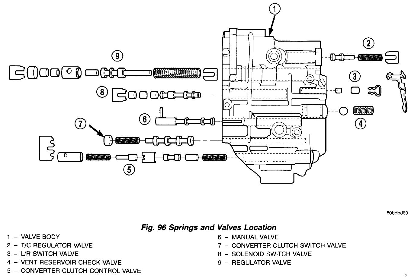

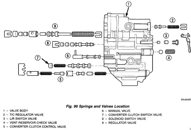

had to drop valve body to replace now I can't get the valve body back together
2000 DODGE CARAVAN
87,000 MILES • 3.3L • 6 CYL • 2WD • AUTOMATIC
DENNISGALEN

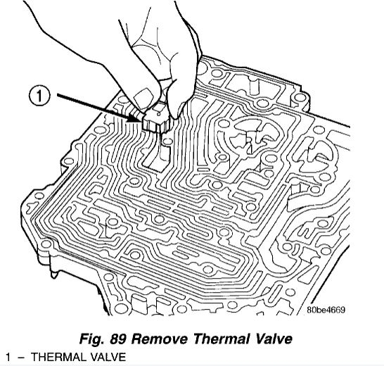

Replaced neutral safety switch had to drop valve body to replace now I can't get the valve body back together. some retainers came out and some type of little balls. need diagram on valve body to see where these parts go.
Mar 15, 2020 at 8:23 AM
STEVE W.
  • 15,200 POSTS
This should help, it's the check ball and retainer as well as other parts in the valve body.
