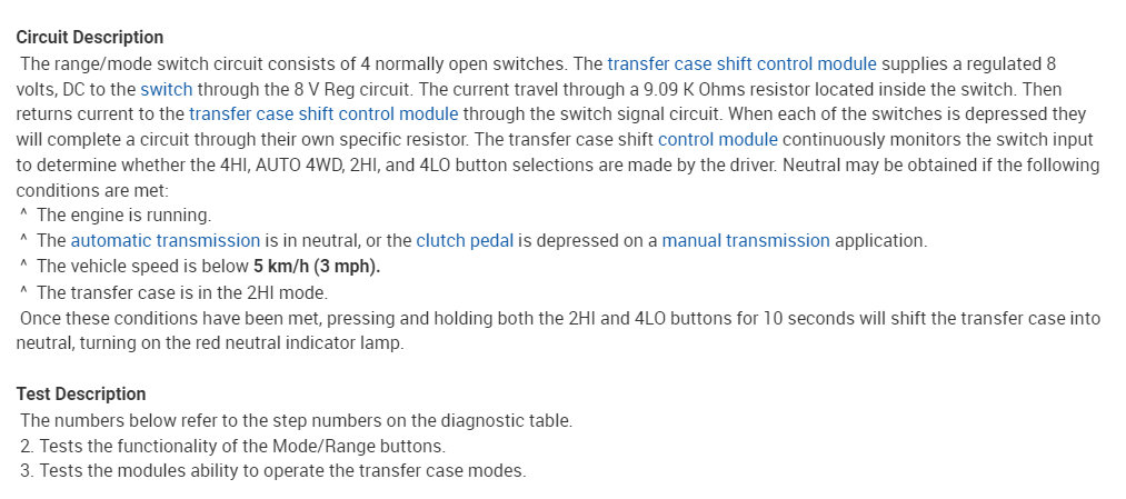

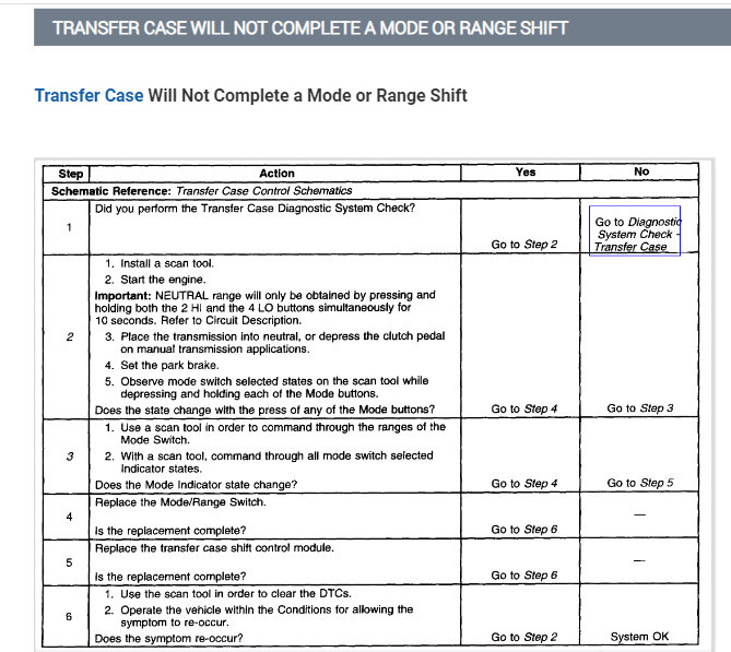

Transferase does not engage in 4-wheel low.
Sep 12, 2022 at 4:16 PM
  • 110,194 POSTS
If it will shift into 4wd high but not low, it could be a couple things. For example, it could be the mode switch or the shift motor itself.
To diagnose this, I have attached the directions below which also include a description of how it works. However, it does require a scan tool to perform the tests.
Take a look through them and let me know if you are comfortable performing them.
