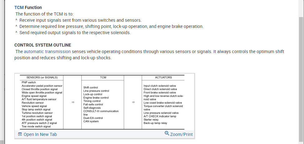

I have the vehicle listed above it should be automatic or manual as far as Goodyear ships. now recently it just started hesitating when I go to accelerate Airgas once stopped at stop sign or red light. well, when I press the gas to go it hesitates so I took it into a shop and he said a code was coming out for the UTCM it was popping up those are with a TCM. so once he went in and took off the transmission he said it was the torque converter. I believe that I guess broke causing metals go in the transmission now with that is there a way he could have fixed the torque converter or do I still need to have a transmission rebuild rather than a transmission flush and will then fix the misread of the TCCM wants to torque converters fixed.
Jun 22, 2021 at 8:17 AM

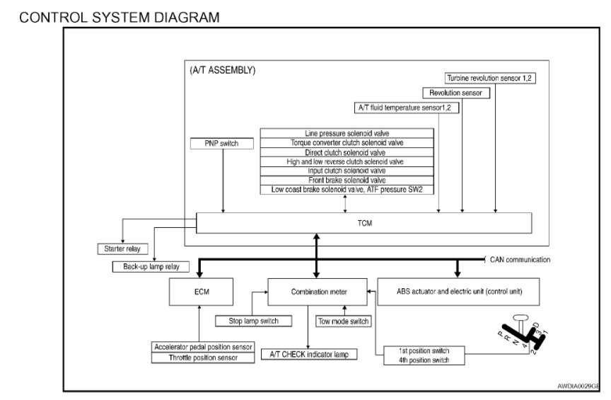

Unfortunately it is unlikely that the flush of the fluid would fix this at this point.
What it sounds like happened is he found the codes that he did and that caused him to need to go into the TCM which is inside the pan. So he would have dropped it down and found the metal. This caused him to go further into it and found that the torque converter was faulty as well.
This issue did sound like a failed converter so you may get away with a converter, TCM, and a fluid flush but if he is there with the unit out of the vehicle it would be cheaper to rebuild it now.
I attached the info below that you can run through that explains the TCM. Please let us know if you have other questions on this. Thanks
