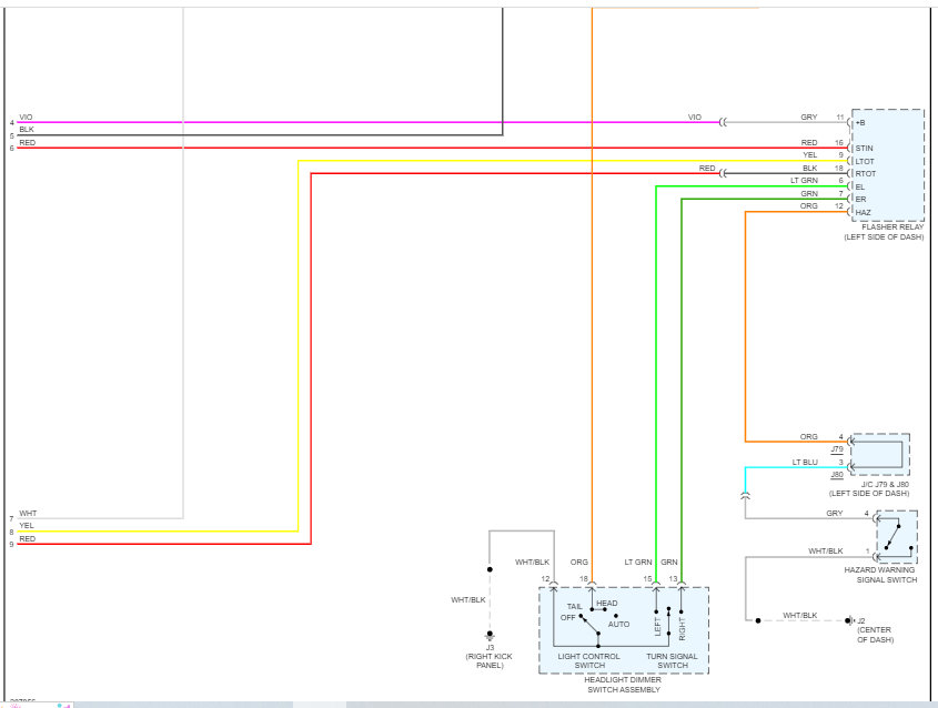

I attached the wiring schematic for the trailer tow circuit for you to reference. I have a question. You have the five-pin connector connected, correct? If so, do you get power for all the lights such as signals, brakes, backup, and parking lights? If so, my guess is that the two-pin connector would be for an electric brake controller. Are you installing one?

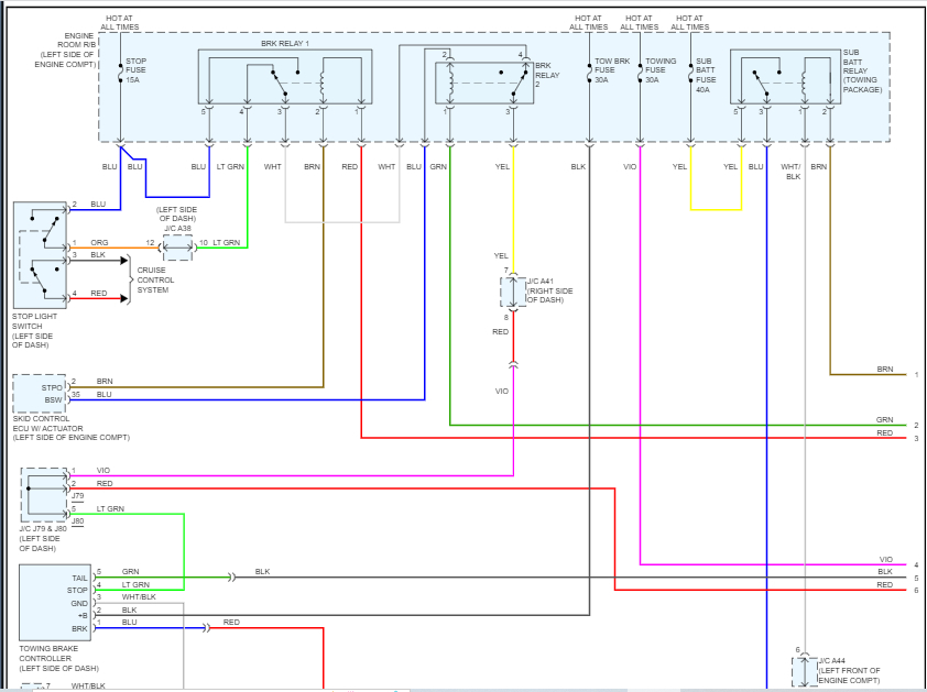

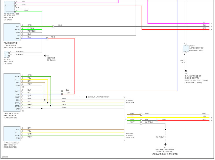

The schematic shows 2 connectors on the truck that connect directly to the 2 separate connectors on the wiring harness. I think the Tundra's with the complete tow package are equipped with the second connector. My Tundra doesn’t have the tow package. It does show that the blue wire included in the 2 wire connector controls the trailer brakes.
Aug 16, 2022 at 2:31 PM
  • 110,240 POSTS
I suspect you will need to run new wiring from the controller and power and make a connection to the one you have. If your vehicle didn't come with the trailer tow package, chances are that wiring just doesn't exist on your truck.
