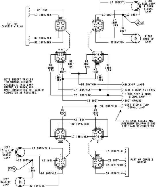

i am installing a wire harness on my vehicle and have not found wiring diagram. I need diagram for reference. thanks.

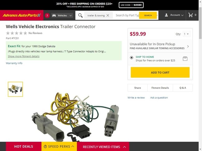

Thought I would pipe this in.
No real thinking/no splicing/no corrosion where wires might be cut/removable as if were never there.
Check out my picture below.

Those are great to add in the trailer harness. I have used at least fifty of them from different companies over the years. Simply plug and play. Dodge even sells a kit for your truck that plugs in that way.
This is the way the kit wires in.
