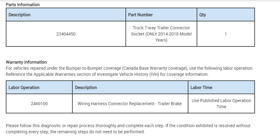

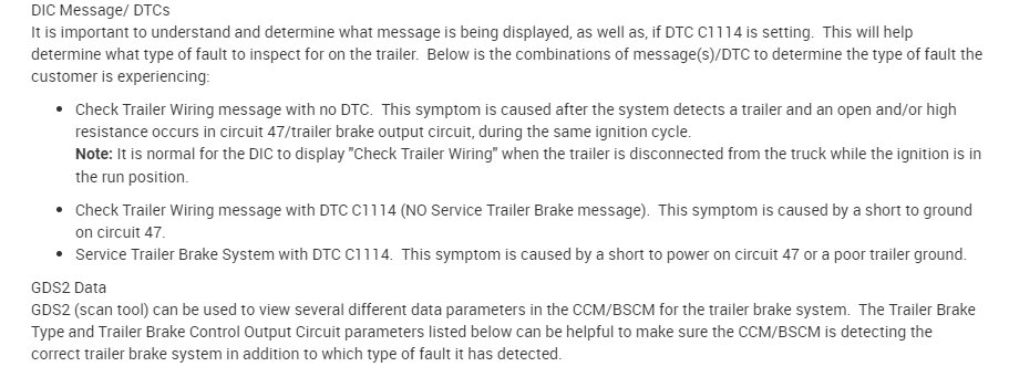

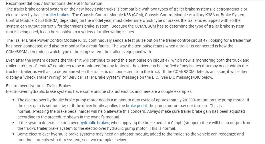

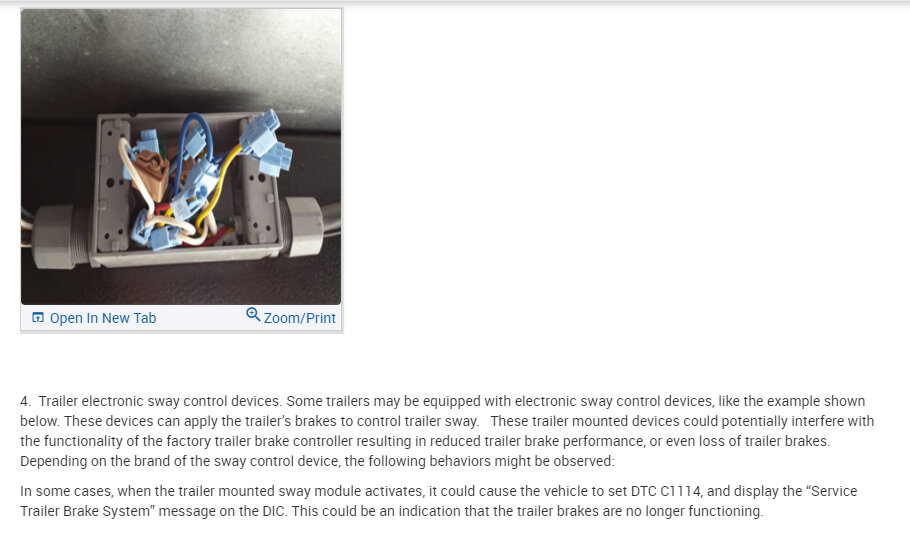

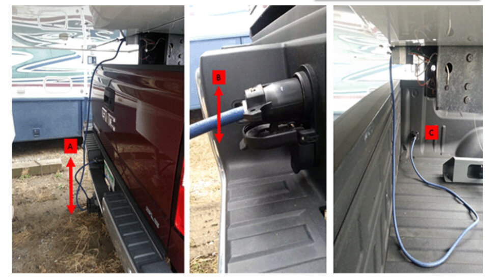

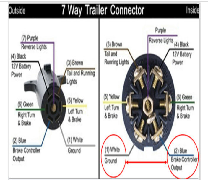

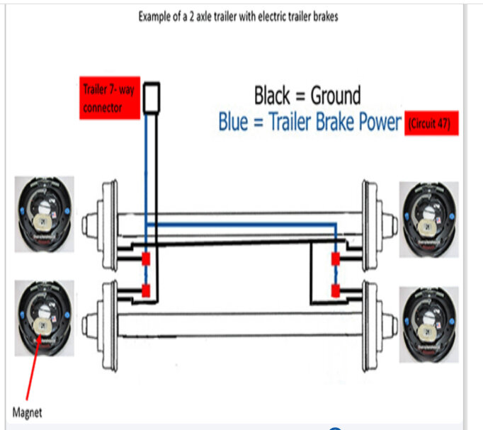

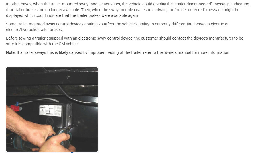

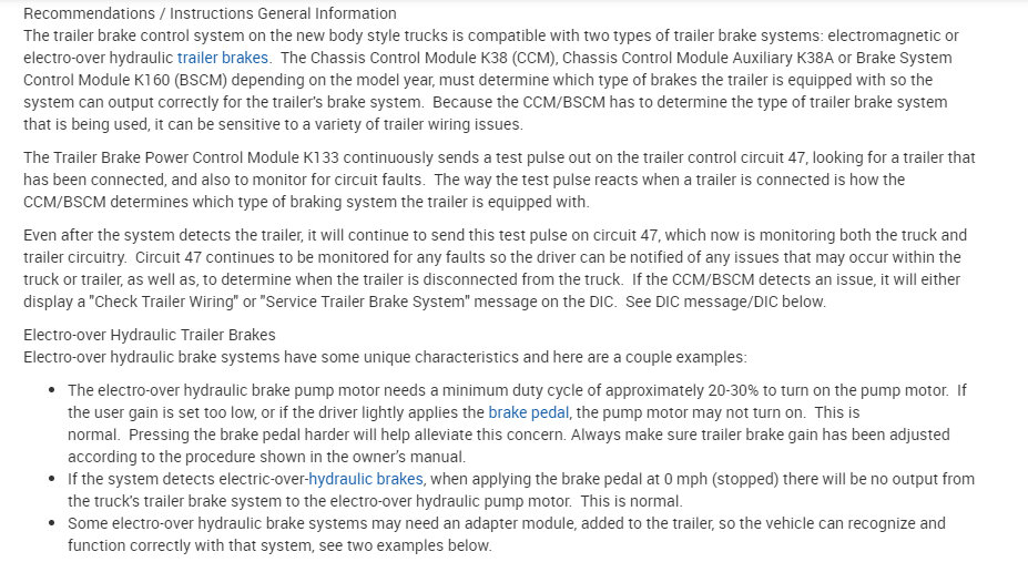

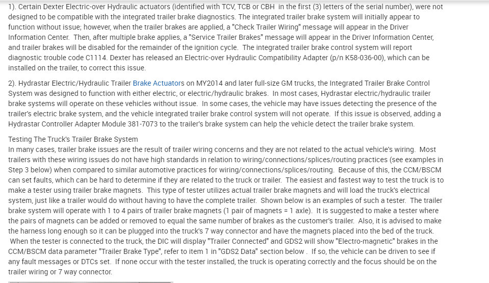

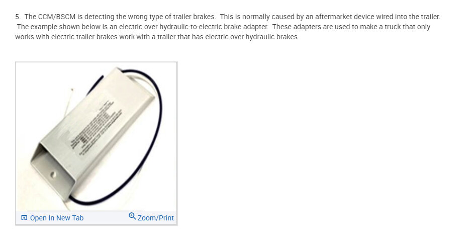

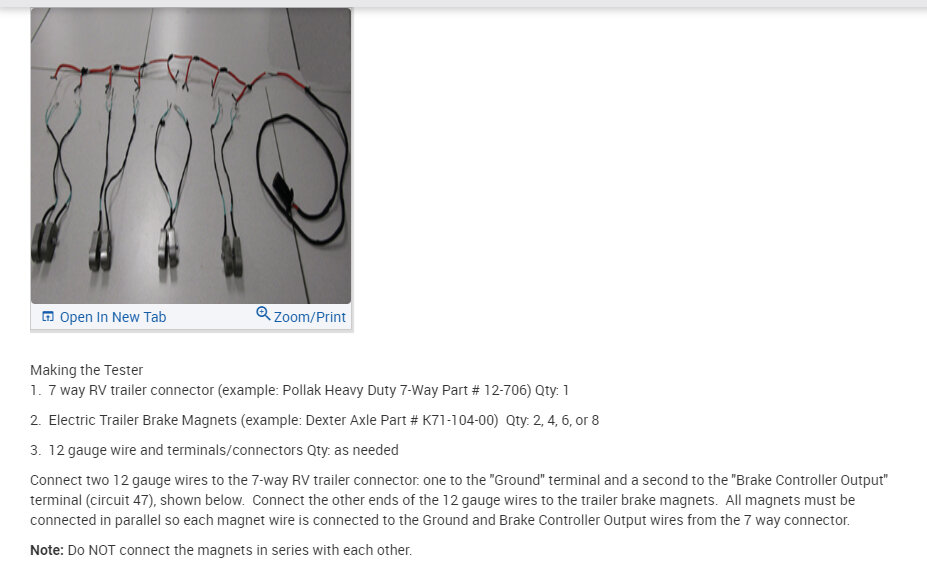

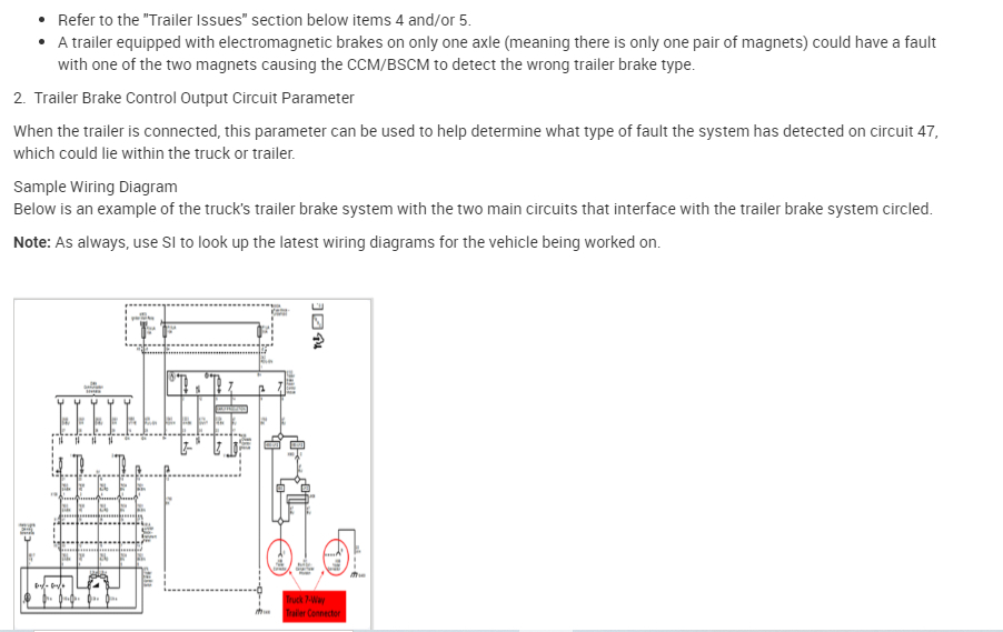

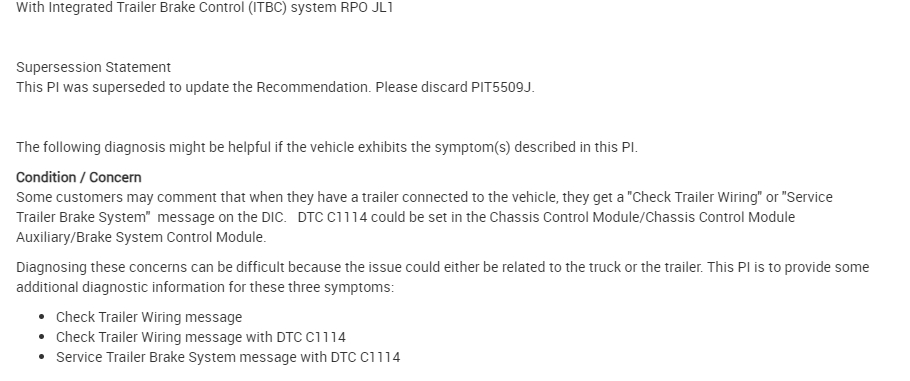

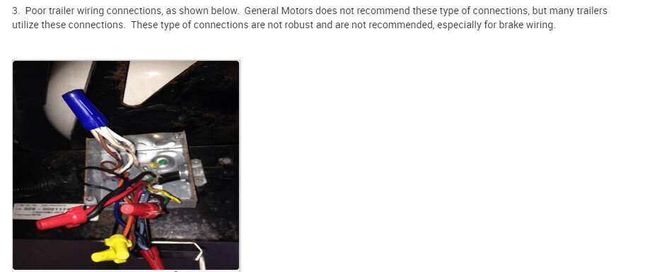

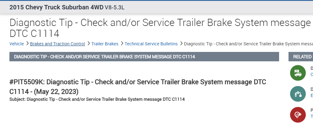

I'm aware of this indicator and the code C1114 (Check and/or Service Trailer Brake System). However, the code and warnings have always been with a trailer connected.
There have been a few issues with the wiring harnesses. I'm wondering if your truck is having the same issues without a trailer attached.

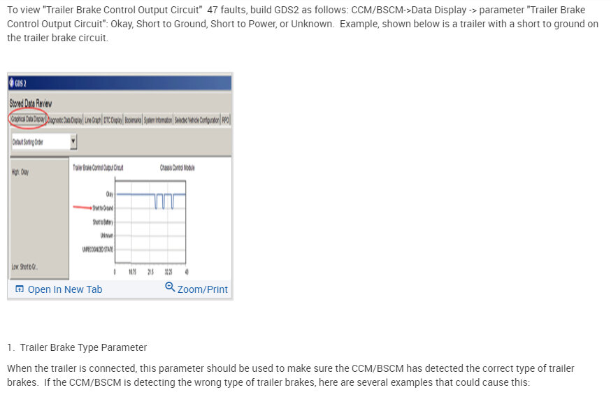

Here is what I recommend. I need to know if the C1114 code is present or if there are others present. To retrieve these types of codes, you will need to scan the can-bus system. CAN stands for controller area network.
Basically, all the different modules are tied together via a few wires. There could be an issue with the ABS module, a short in the wiring, or a damaged connector. This is what needs to be done to determine the correct diagnosis for your truck.
Here is a link that shows how it is done:
Let me know if that is something you can do or have done for you.

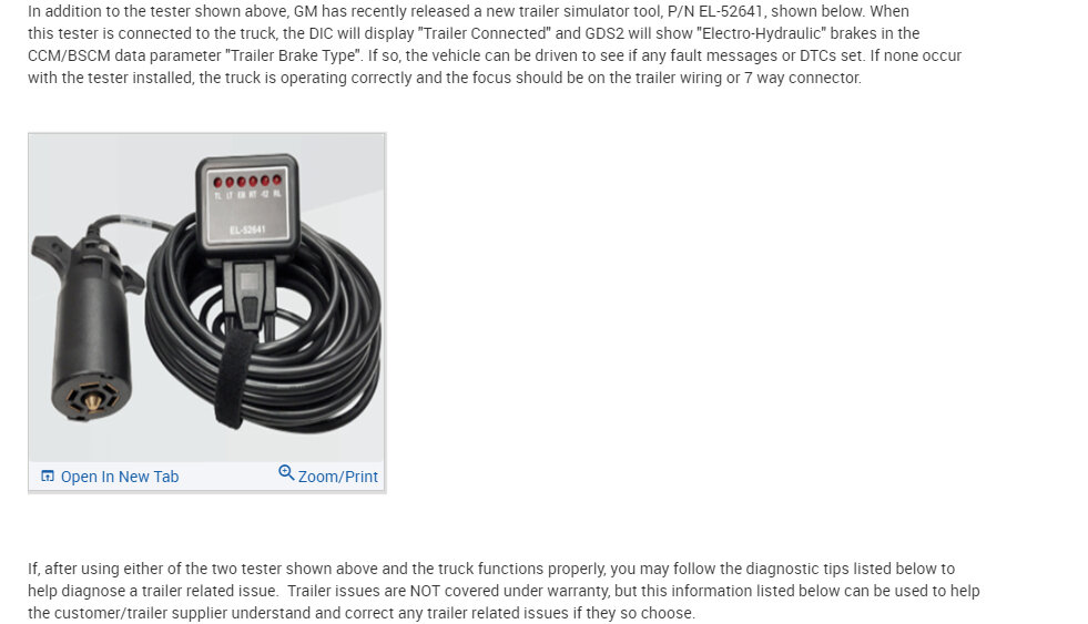

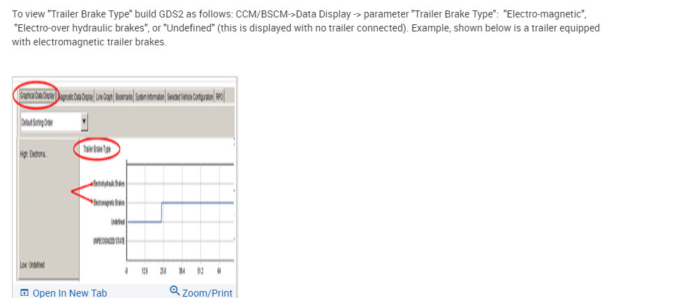

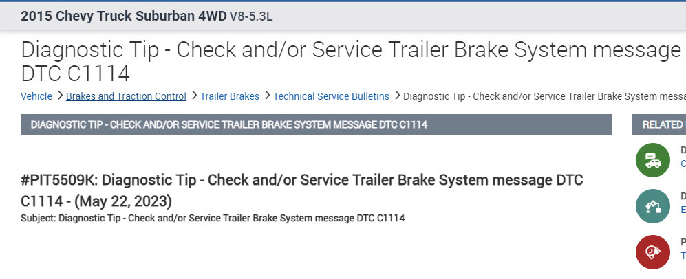

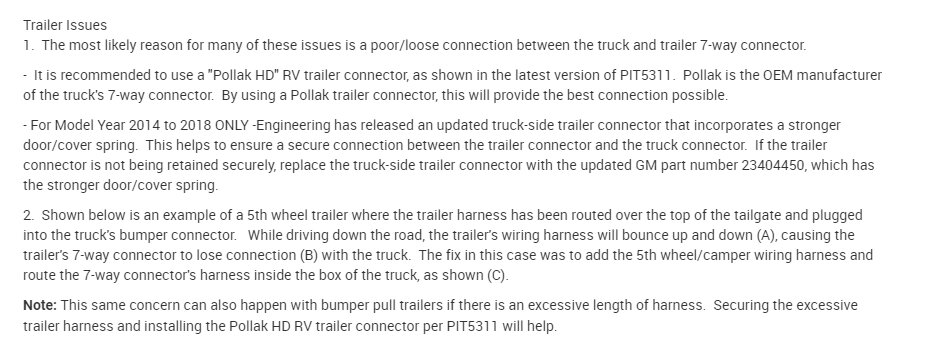

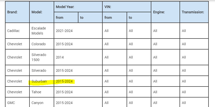

See pic below related to a technical service bulletin (TSB) for a C1114. I wanted to let you see the TSB and diagnostics.
