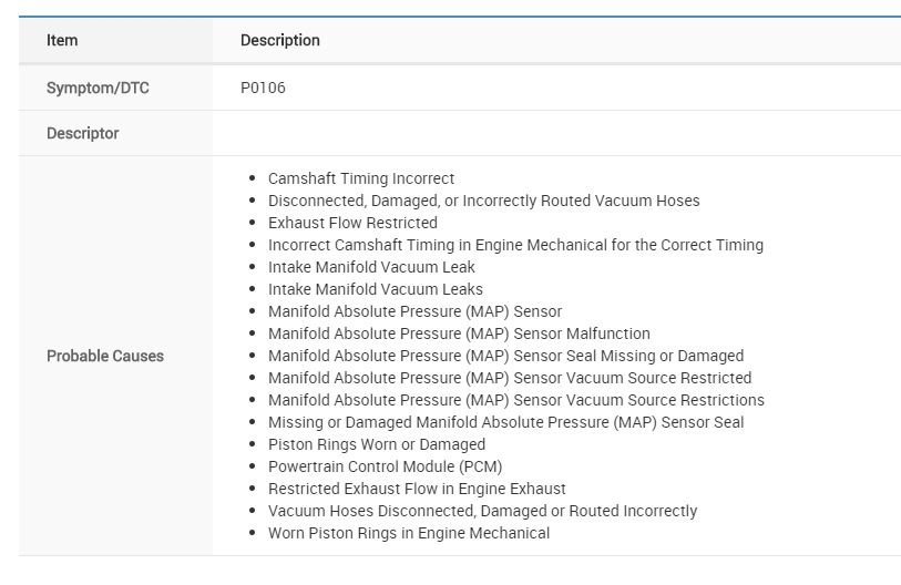

There is a lot to this code. It could be the sensor, vacuum leak to the sensor or another mechanical issue.

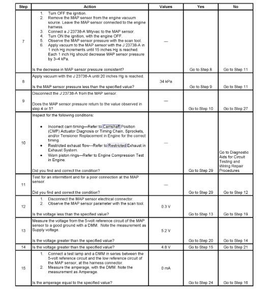

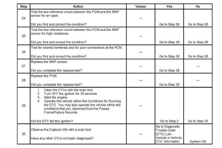

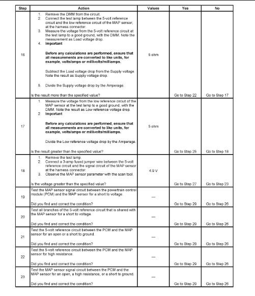

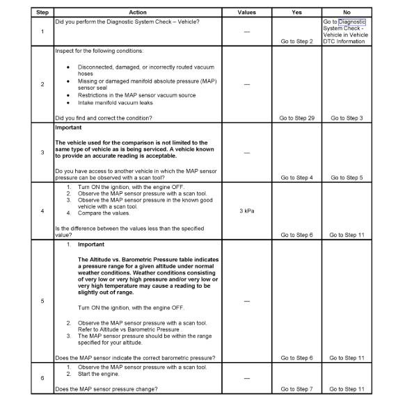

Did you follow the flow charts I posted? What were the results?

Follow the flow chart and let me know what happens.
