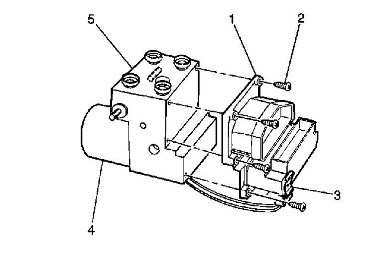

I have the car listed above supercharged. For quite some time now it has been throwing the traction control light and then immediately going into reduced engine power mode. I can pull over turn off the car wait until the emission lights go off and then start the car and it's fine again. Sometimes for a mile down the road sometimes it might not do it again for a day or two sometimes it might do it five times in a row within five miles. Seems to do it more when it is cold outside or raining or windy some type of weather, however it still doesn't when it is nice and warm just not as frequent. This has been going on for over a year now and I cannot figure out what it is. It has slowly progressively gotten worse. Please help thank you. PS: I am decently mechanically inclined just not an expert.

Good morning,
When the traction control goes active, it will limit the cars speed and engine RPM. If the wheels are not slipping or you are on dry pavement, the system has a fault.
Here is a video to help you
https://youtu.be/rTtAnsOlZU4
It is part of the ABS system. there should be a code stored in the module. You can go to a parts store and have the code read for free.
Let me know the code and we can continue.

Good afternoon,
When the trac light comes on, the engine will be limited to RPM and speed.
There is a fault in the ABS system for this issue.

Correct. You need to have the codes checked in the ABS section of the modules.
Most likely the ABS module is the issue for this condition.

No to the axle. This sounds like an ABS module issue.

No, it is not repairable. It has to be replaced.
Electronic Brake Control Module Replacement
Removal Procedure
Caution: Refer to Brake Fluid Irritant Caution in Service Precautions.
Notice: Refer to Brake Fluid Effects on Paint and Electrical Components Notice in Service Precautions.
Notice: To prevent equipment damage, never connect or disconnect the wiring harness connection from the EBCM with the ignition switch in the ON position.
1. Turn the ignition switch to the OFF position.
2. Remove the fuel injector sight shield, 3.8L engine only.
3. Remove the front fender upper diagonal brace.
4. Disconnect the accelerator and cruise control cable from the accelerator control cable bracket.
5. Disconnect the cruise control module from the left strut tower. It is not necessary to remove the cable from the module. Position the module and cables aside.
6. Remove the air cleaner intake duct.
7. Disengage the locking tab (1) from the electronic brake control module (EBCM) harness connector.
8. Disconnect the EBCM harness connector.
9. Remove any dirt/debris from the assembly.
10. Remove the 6 EBCM to brake pressure modulator valve (BPMV) retaining bolt/screws.
Important: Do not pry apart using a tool. Be careful not to damage BPMV surface.
Important: Care must be taken not to damage the solenoid valves when the EBCM is removed from the BPMV.
11. Separate the EBCM (1) from the BPMV (4) by gently pulling apart until separated.
12. Disconnect the pump motor connector (3) at the bottom of the EBCM.

You need to start somewhere. I would start with the ABS module.
