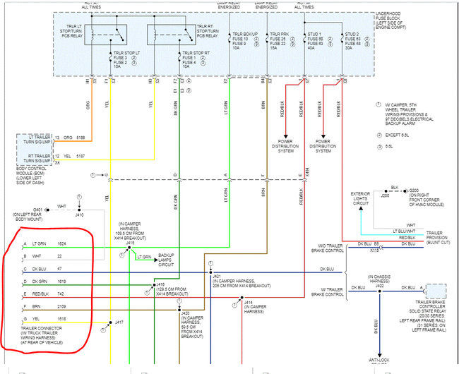

My trucks traction control and stabilitrak light comes on the dash along with the warning on the bottom saying service traction control and service stabilitrak. after about 5 to 10 minutes driving and it will reset it’s self after car is turned off for a period of time. . I tried using a code reader while the dash light was on and it says that there’s no codes and no dash lights on when I can clearly see that the traction control light is on. Not sure what it is.

Okay, I think we need to start at the beginning. I am going to attach a wiring schematic for the trailer wiring. What I need you to do is confirm that all the correct color wires indicated are going to the correct pin. The pictures are indicated by letters. On the connector you installed, they should be there to follow.
Let me know if this is how it was done. Also, let me know if you had to wire the truck as well as the trailer. Many of these trucks had a factory connection already installed.

It was a 4 way flat trailer and I have an adapter I used to turn it into a 7 pin.
Apr 22, 2020 at 9:56 AM
  • 110,248 POSTS
Did everything work properly on the trailer? Since it started when this was used, I'm thinking power was sent or ground was provided where it wasn't meant to be.
