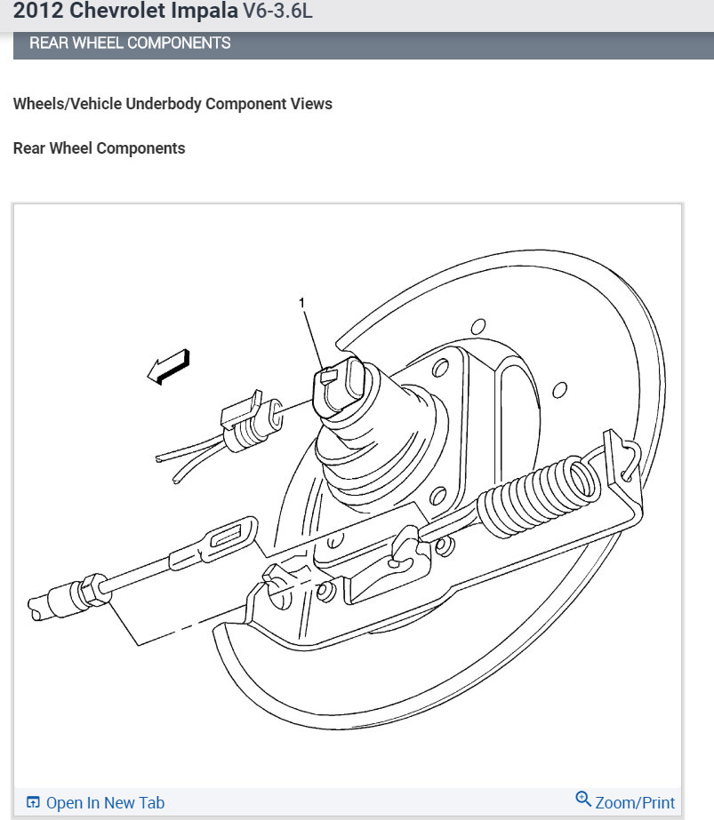

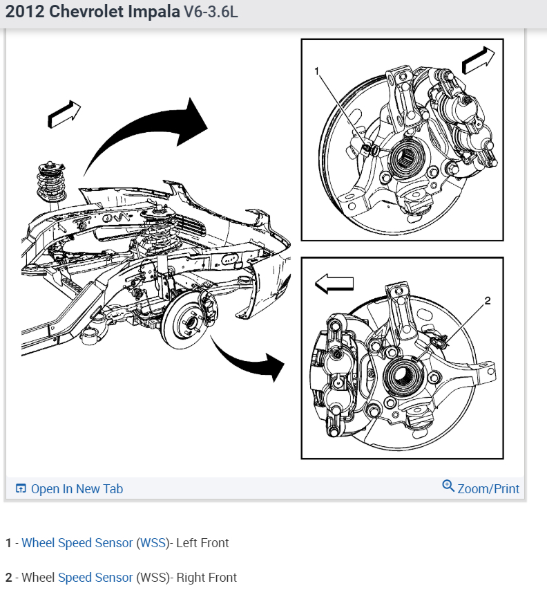

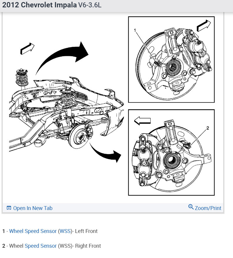

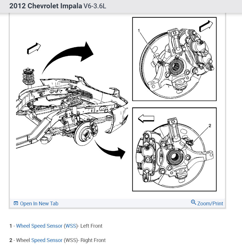

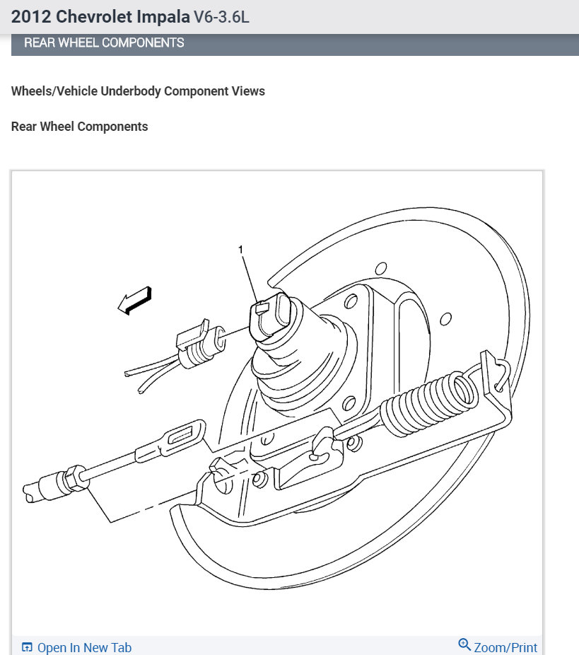

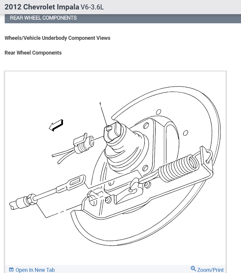

My car is shaking and feels like the brakes lock up, which then causes shaking of the car and the traction control light goes on and blinks while this is happening. What can be causing this ?
Sep 13, 2016 at 8:52 PM
HMAC300
  • 48,601 POSTS
This happens when one of the ABS wheel speed sensors goes out but to be sure here is ahow to scan for codes to see which one it is with diagrams below to help show you on your car.
https://youtu.be/rTtAnsOlZU4
Check out the diagrams (Below). Please let us know what you find. We are interested to see what it is.
Sep 14, 2016 at 7:13 AM
MICHAEL-BRENT1947
Thanks for this post, I had this problem and had to replace the right front wheel sensor, all fixed! I love this site
