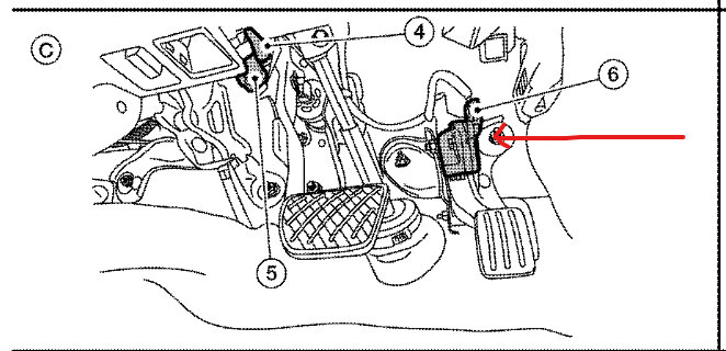

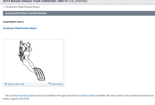

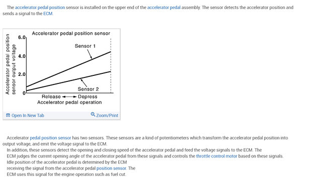

Yep, this happens when the throttle pedal position sensor needs to be replaced, here is information on the codes and I have included how to change out the sensor in the images below.
The P2135 code is a generic powertrain code that indicates a problem with the throttle/pedal position sensor/switch "A"/"B" voltage correlation.
Clear the codes once the repair is completed. Check out the images (below). Please let us know if you need anything else to get the problem fixed.
