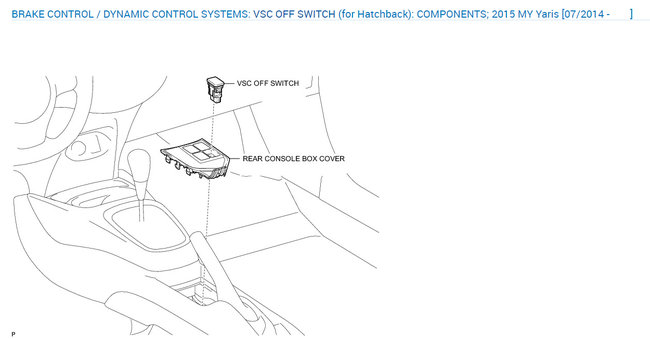

The track light is on the dash.
Feb 28, 2021 at 4:23 PM
NICKOLAOSF
  • 69 POSTS

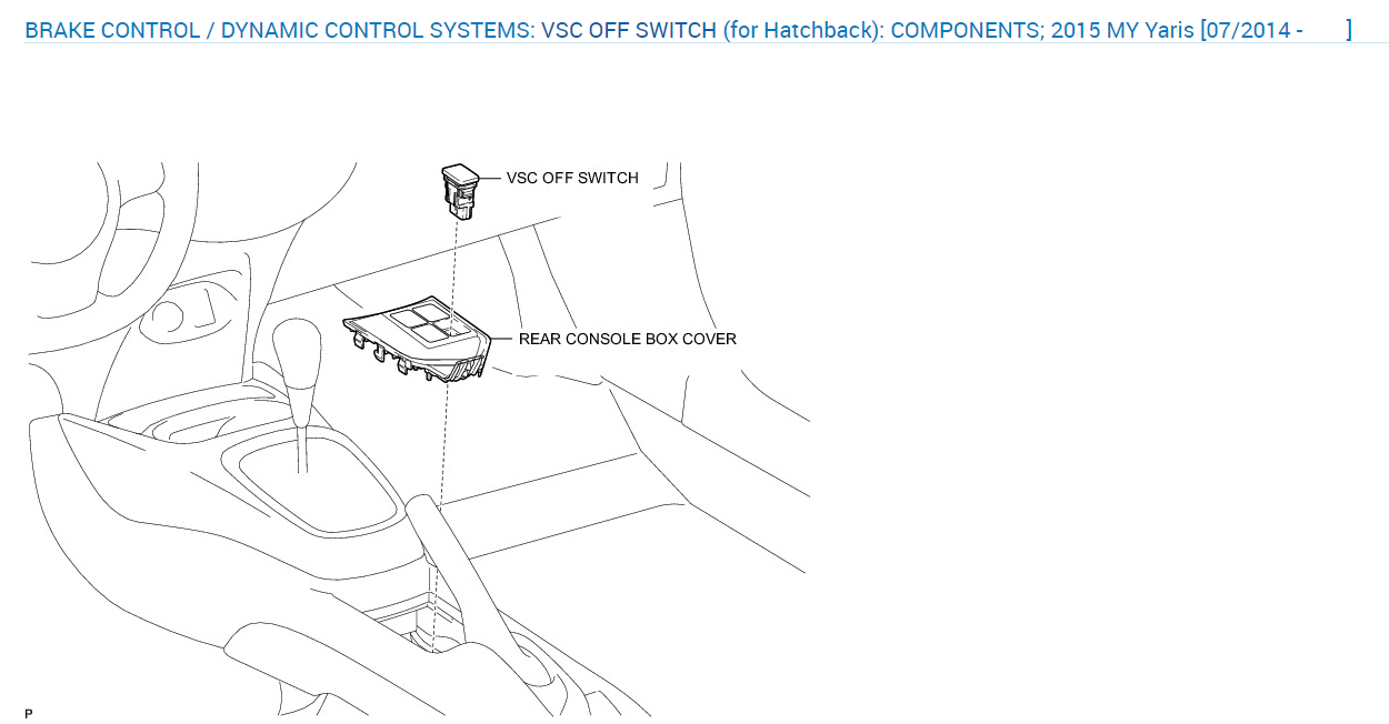

Hi SKOOTER24,
We can help you with this information. (Engine size do you mean 1.5?) On the Yaris you have a switch make sure it is not in the off position. Check out the diagrams (below).
(you will have to scan systems for codes) I am glad to help you, If there is anything else we can help you with please contact us again. This guide can help you with the codes.

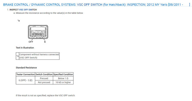

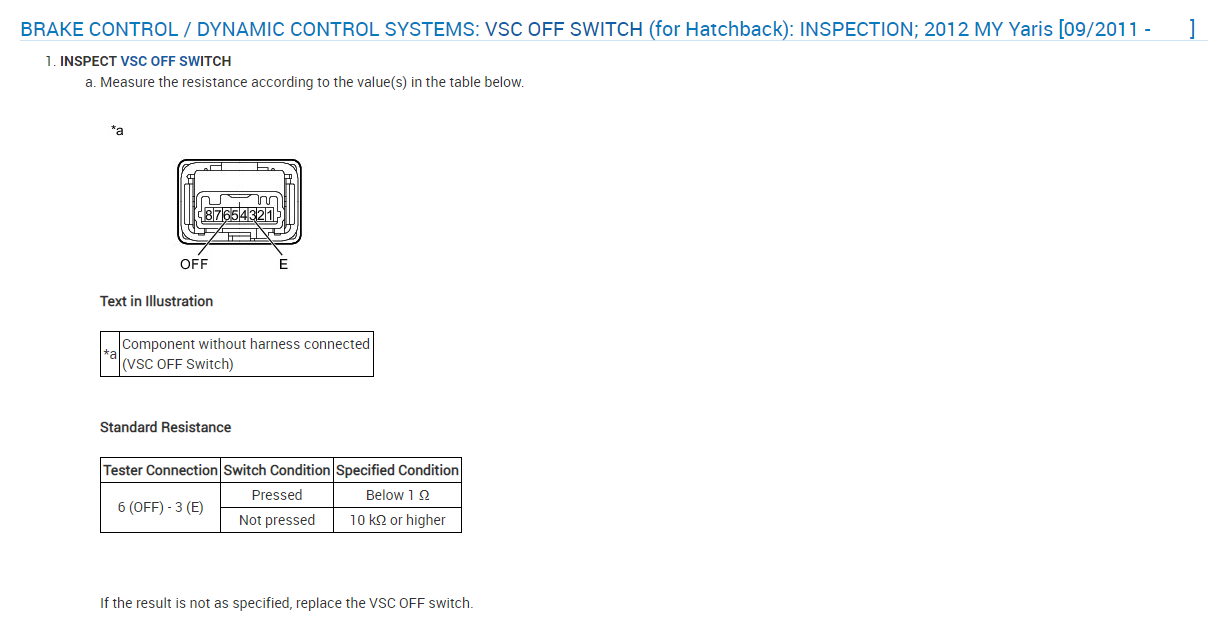

Okay, so I need to unhook the traction control switch and test those pins?
Feb 28, 2021 at 7:39 PM
NICKOLAOSF
  • 69 POSTS
The first thing is to scan systems for codes (if you don't have a scanner parts stores read it for you for free, if there is a code snap a picture with your phone, do not erase)
If there is no codes you have to remove switch and measure to verify if it is working.
