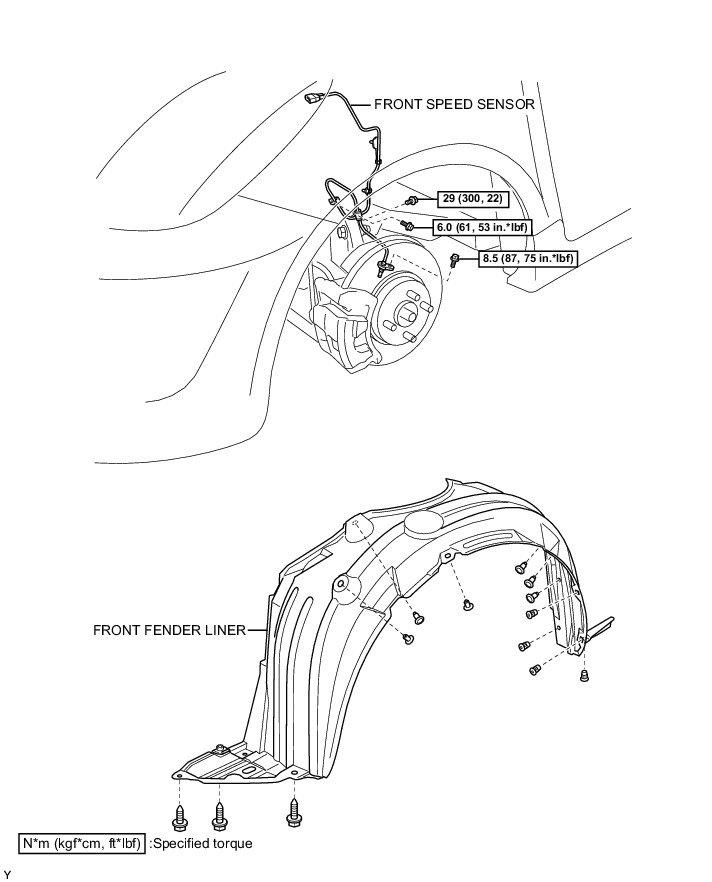

The track light is on the dashboard.
Feb 27, 2021 at 7:53 AM
  • 110,244 POSTS
Chances are one of the wheel speed sensors has failed. Here is what I suggest, you can scan the can-bus system to retrieve all codes or check each sensor to see if you can locate a bad one.

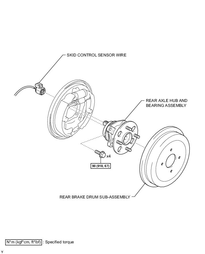

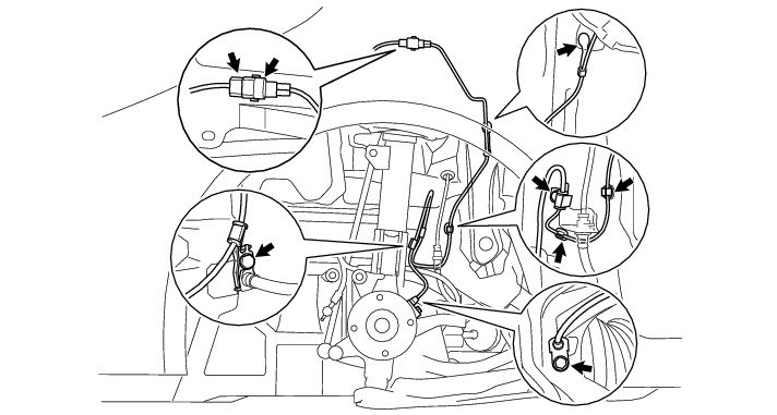

I attached two pics below showing the location of the front and rear sensors.
If you find one is bad, here is a link that shows in general how they are replaced.
https://www.2carpros.com/articles/how-to-replace-an-abs-wheel-speed-sensor
Here are the directions specific to your vehicle. The remaining pics correlate with the directions.

Front:
2012 Toyota Yaris Sedan L4-1.5L (1NZ-FE)
Front Speed Sensor (Sedan) - Removal [08/2011 - ]
Vehicle Sensors and Switches Sensors and Switches - Brakes and Traction Control Wheel Speed Sensor Service and Repair Removal and Replacement Front Speed Sensor (Sedan) - Removal [08/2011 - ]
FRONT SPEED SENSOR (SEDAN) - REMOVAL [08/2011 - ]
BRAKE CONTROL / DYNAMIC CONTROL SYSTEMS: FRONT SPEED SENSOR (for Sedan): REMOVAL; 2012 MY Yaris [08/2011 - ]
DISCONNECT CABLE FROM NEGATIVE BATTERY TERMINAL
REMOVE FRONT WHEEL
REMOVE FRONT FENDER LINER
Remove the 3 screws, 6 clips and 4 grommets and remove the front fender liner.
REMOVE FRONT SPEED SENSOR
pic 1
Remove the speed sensor clip from the body.
Disconnect the speed sensor connector.
Remove the 3 clips.
Remove the bolt and separate the clamp from the body.
Remove the bolt and separate the clamp from the shock absorber.
Remove the bolt and remove the speed sensor from the steering knuckle.
NOTICE:
Keep the speed sensor tip and installation portion free of foreign matter.
Remove the speed sensor without turning it from its original installation angle.
Install is the reverse of removal.

Rear:
Rear Speed Sensor (Sedan) - Removal [08/2011 - ]
Vehicle Sensors and Switches Sensors and Switches - Brakes and Traction Control Wheel Speed Sensor Service and Repair Removal and Replacement Rear Speed Sensor (Sedan) - Removal [08/2011 - ]
REAR SPEED SENSOR (SEDAN) - REMOVAL [08/2011 - ]
BRAKE CONTROL / DYNAMIC CONTROL SYSTEMS: REAR SPEED SENSOR (for Sedan): REMOVAL; 2012 MY Yaris [08/2011 - ]
REMOVE REAR WHEEL
REMOVE REAR BRAKE DRUM SUB-ASSEMBLY [ BRAKE (REAR): REAR BRAKE (for Sedan): REMOVAL+ ]
DISCONNECT SKID CONTROL SENSOR WIRE [ AXLE AND DIFFERENTIAL: REAR AXLE HUB (for Sedan): REMOVAL+ ]
REMOVE REAR AXLE HUB AND BEARING ASSEMBLY [ AXLE AND DIFFERENTIAL: REAR AXLE HUB (for Sedan): REMOVAL+ ]
