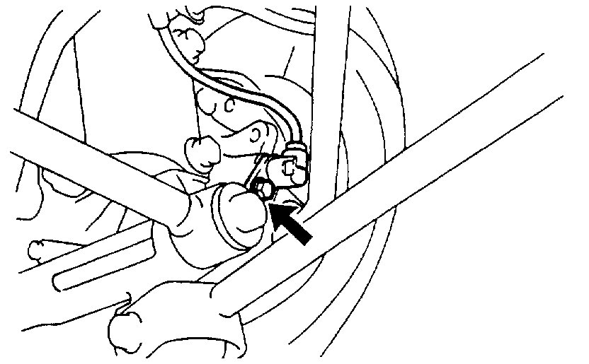

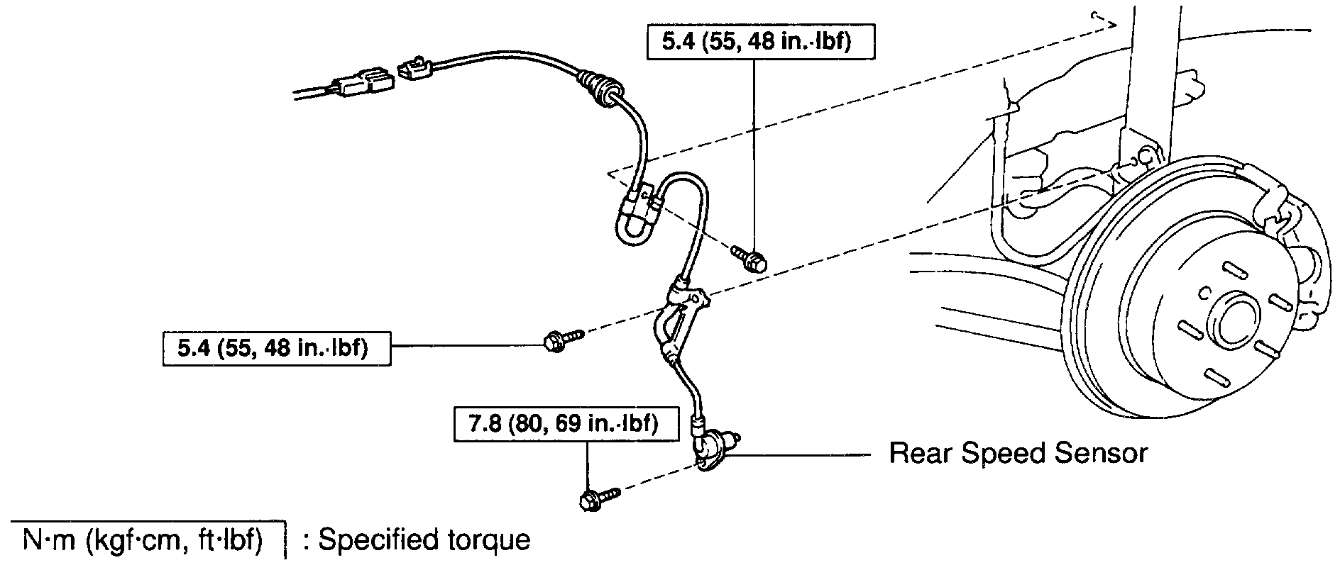

The most common cause of the two coming on together is a failed wheel speed sensor. What I would suggest is to check each one of them to see if one has failed. If you look at pic 1 below, it shows how they are located on both the front and back.
To check one only requires a voltmeter or multimeter. Here is a link that shows how it is done:
https://www.2carpros.com/articles/abs-wheel-speed-sensor-test
If you find one is bad, here are the directions for replacement. The attached pics correlate with the directions.

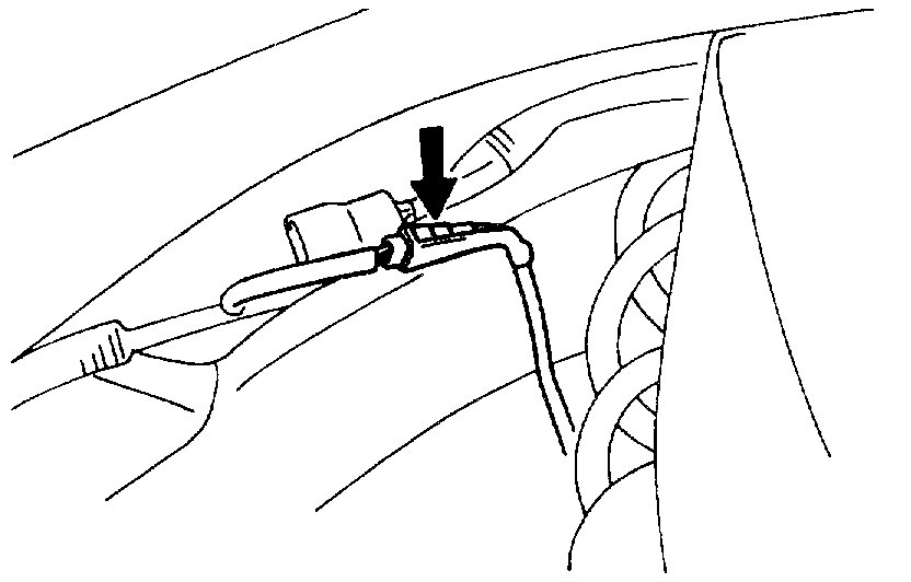

pic 3

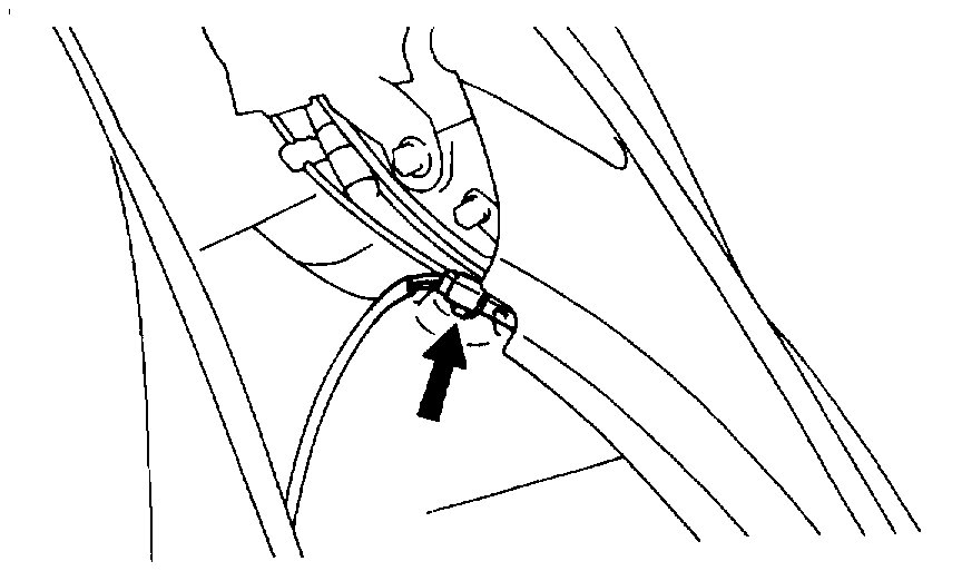

1. Disconnect speed sensor connector.
a. Remove the fender liner.

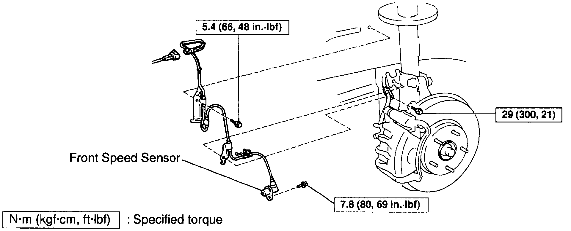

pic 4
b. Disconnect the speed sensor connector.

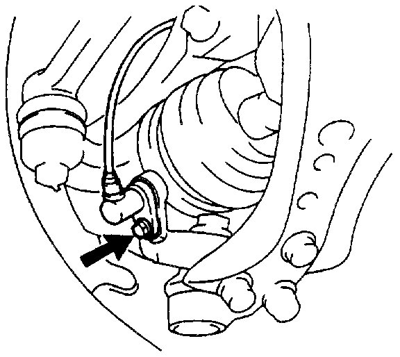

pic 5
2. Remove speed sensor.
a. Remove the bolt, flexible hose and speed sensor harness clams from the shock absorber.
Torque: 29 Nm (21 ft. lbs.)
b. Remove the resin clip and clamp bolt holding the sensor harness to the body.
Torque: 5.4 Nm (48 inch lbs.)
c. Remove the speed sensor from the steering knuckle.
Torque: 7.8 Nm (69 inch lbs.)

Rear Sensor
1998 Lexus ES 300 V6-3.0L (1MZ-FE)
Speed Sensor, Rear
Vehicle Sensors and Switches Sensors and Switches - Brakes and Traction Control Wheel Speed Sensor Service and Repair Procedures Speed Sensor, Rear
SPEED SENSOR, REAR

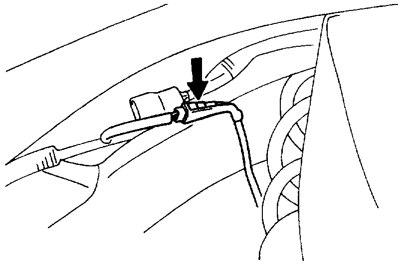

pic 6
REMOVAL
pic 7
a. Remove the seat cushion and seatback.
b. Disconnect the speed sensor connector, and pull out the sensor wire harness with the grommet.
pic 8
a. Remove the 2 clamp bolts holding the sensor wire harness to the body and shock absorber.
b. Remove the speed sensor from the axle carrier.
INSTALLATION
Installation is in the reverse order of removal.
After installation, check speed sensor signal.
