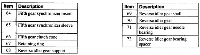

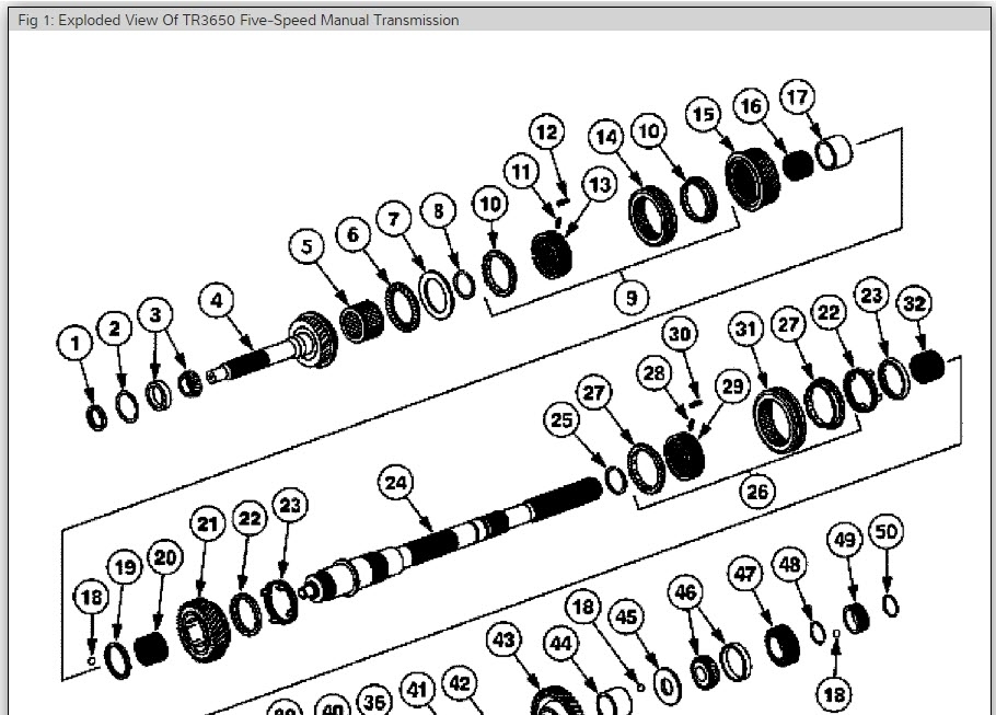

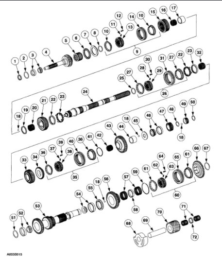

any chance you guys have an exploded view of the transmission that I can print out and see the numbers? thanks. attached is what I'm working with and it's too small.

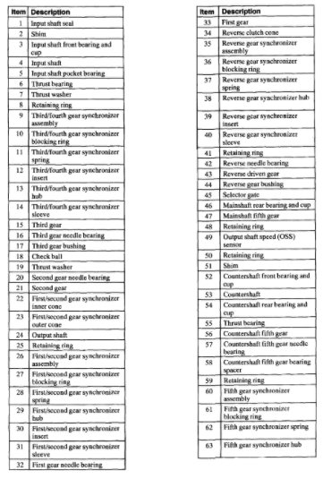

Here you go, let me know if you need the description chart.

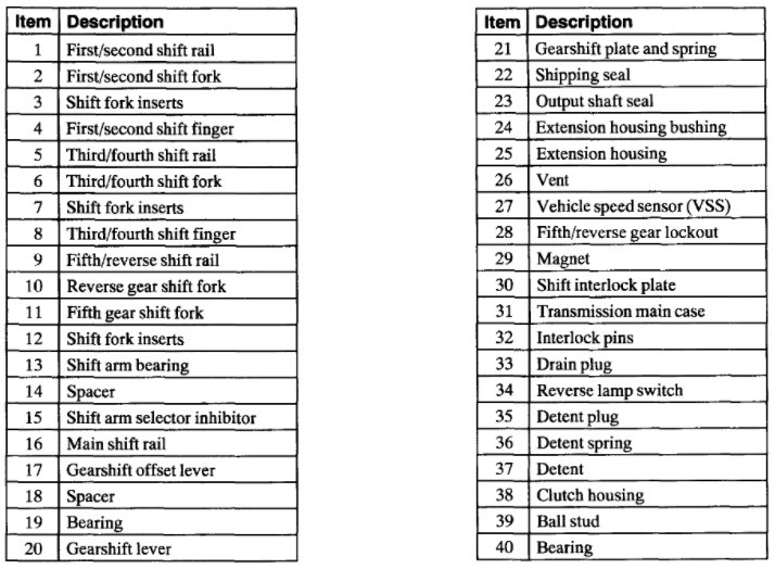

if you don't mind, I'd appreciate the description chart too. Thanks so much.

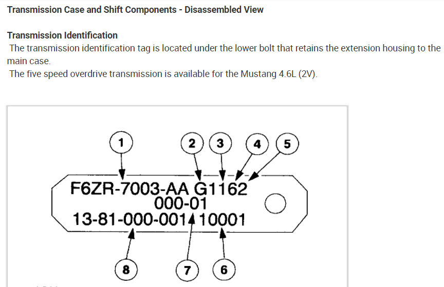

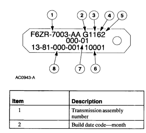

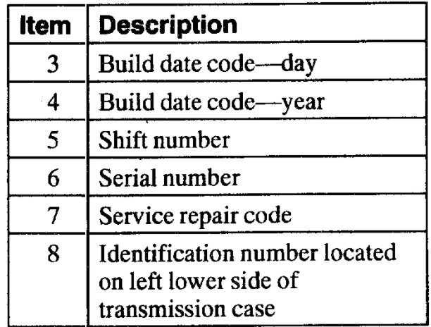

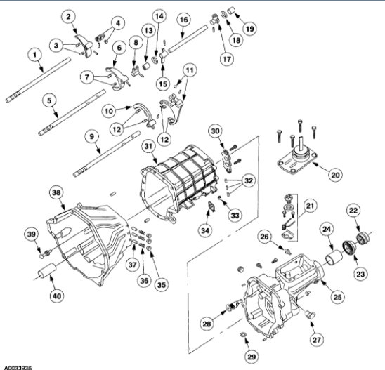

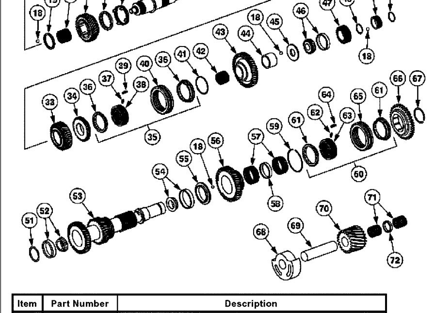

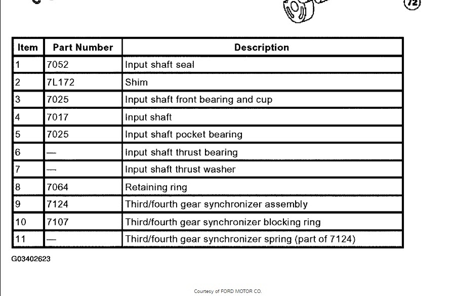

Here is the information you requested.This is all the info for the TR3650. I've attached all the pictures below and their description below.Hope this helps and thanks again for using 2CarPros.

Those little check balls got us, break her back down to put them in. Thanks so much for your help. You guys are surely the best!! Enjoy your weekend.
