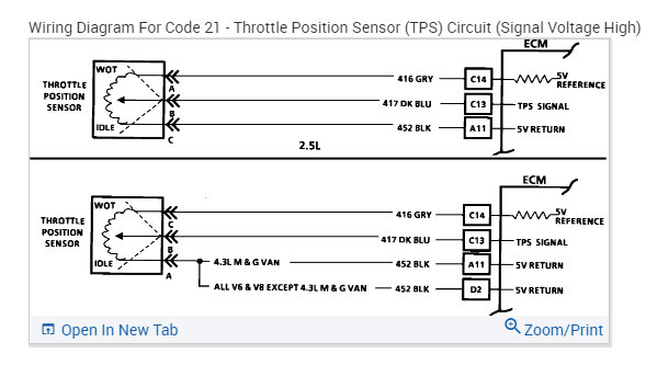

Getting one code 21 TPS voltage high. Tested the TPS with voltmeter across blue and black wire and with ignition on throttle closed got like 4.6. i then gradually opened the throttle and the numbers were coming down. Is this a bad TPS because i just replaced it like 2 weeks ago. Any and all help would be appreciated.

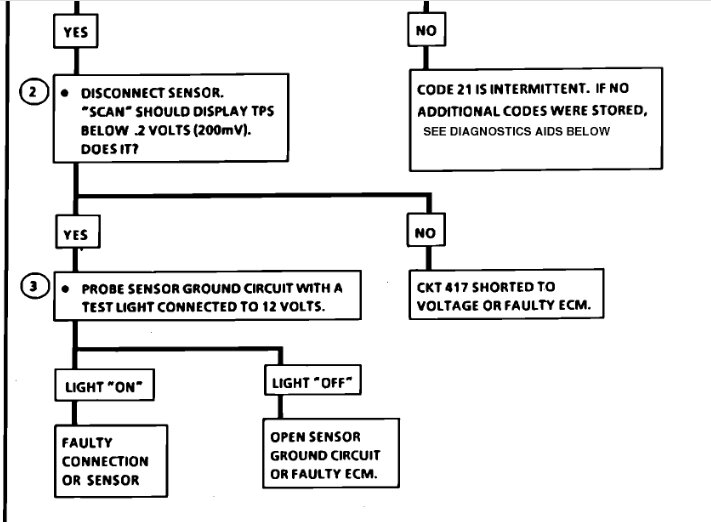

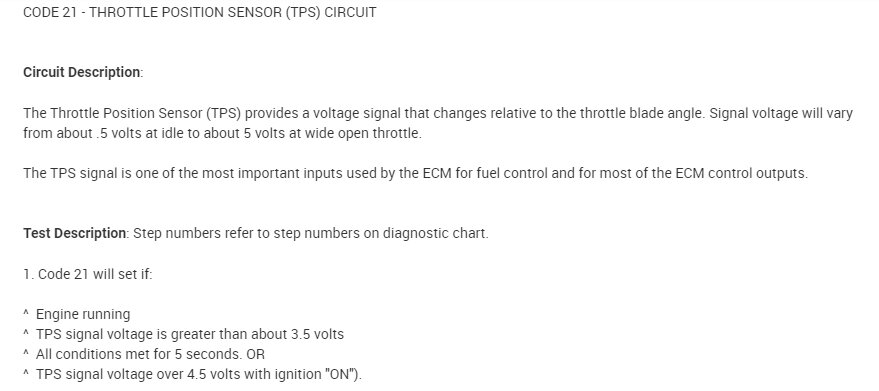

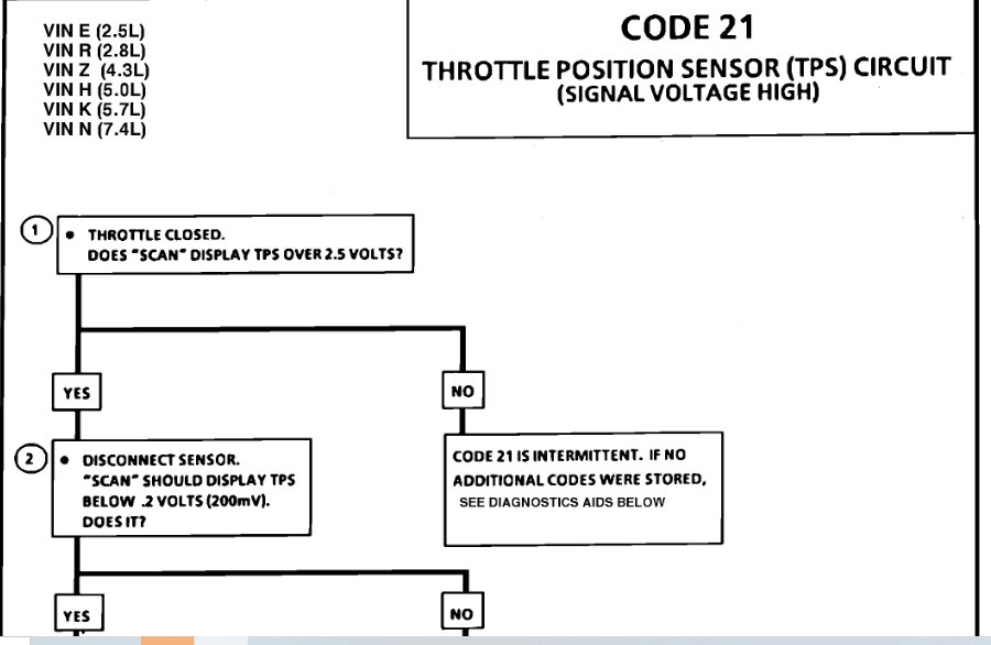

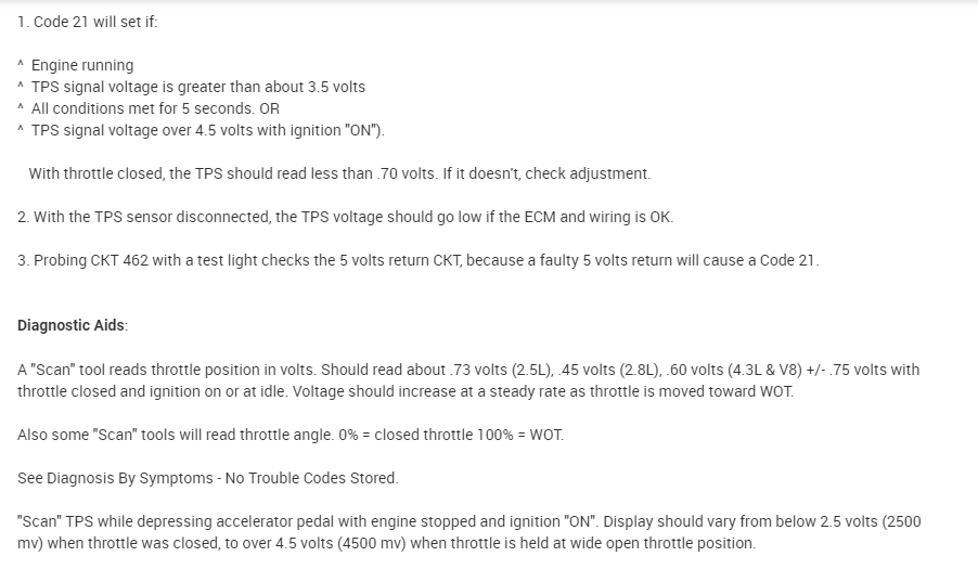

With the throttle closed, it shouldn't be over 2.5v. We may have a short to power or the new part has failed. I have seen a lot of aftermarket parts either not work at all, or they fail after a short time.
I attached the diagnostics below for this code. Take a look at them and let me know if you are comfortable performing them.
Let me know what you find.

See pics below. Just a note: With the throttle closed, you should be at approximately 70v.

That means a scanner is used. If you have a multimeter/voltmeter, check the gray wire first for a 5v reference signal. The dark blue wire is the signal return, so that is the one that should be near 0v when the throttle is closed.
When you check for the 5v reference, you can have the connector disconnected. When you check for the TPS signal, it needs to be connected and you need to back probe the dark blue wire.

With the ign on not running i got 5.04 volts on gray wire back probed blue wire n got 4.17 with throttle closed. I slowly opened the throttle and the numbers decreased to 0.3. I also checked for continuity on ground wire back to battery and there is.
