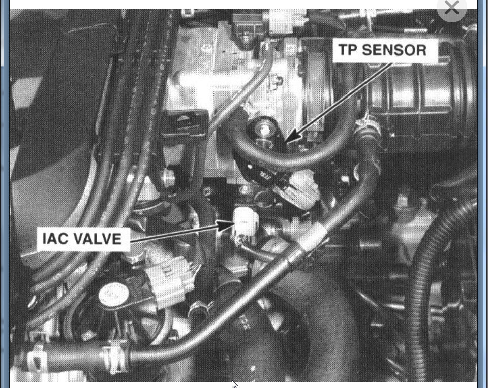

I need to know step by step how to put a new TPS sensor on my car. I don’t know how to do the voltages and all. please and thank you.
Feb 19, 2021 at 2:46 PM
HUNTER JOHNS
  • 9 POSTS

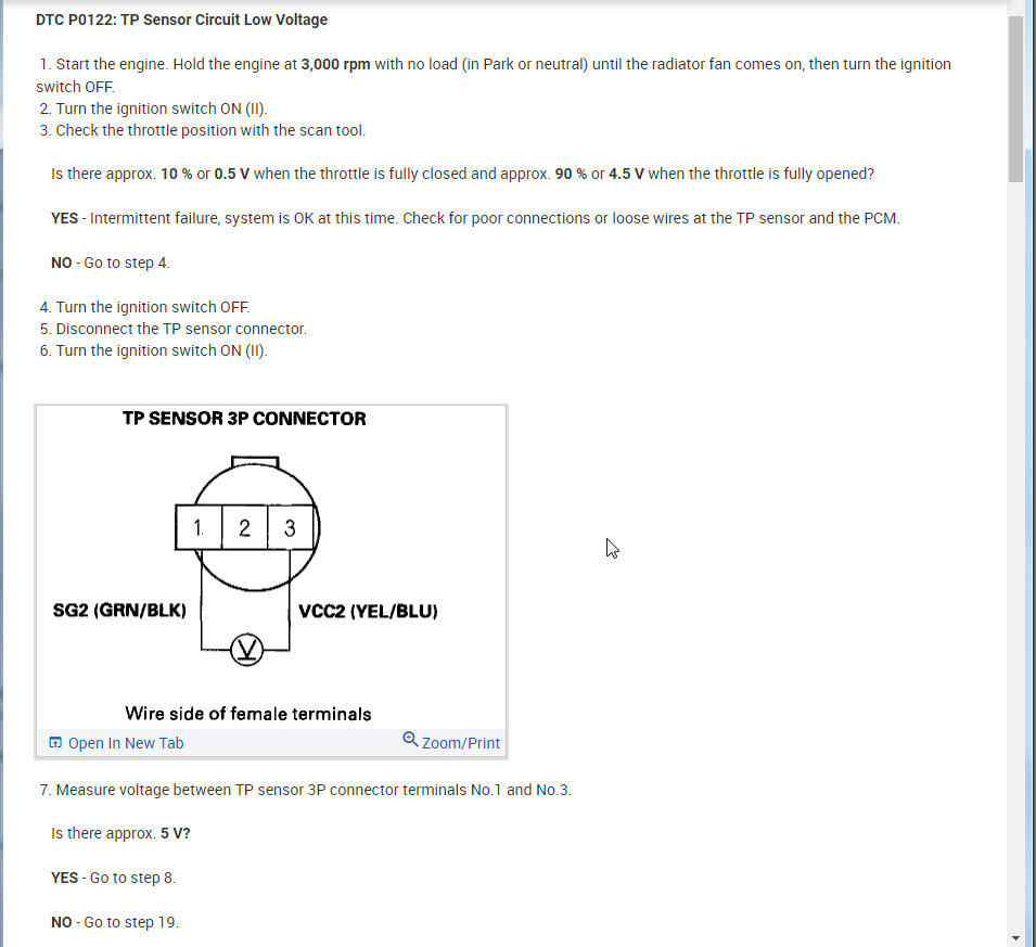

I’m just having a code P0122 circuit low code after I put it on.
Feb 19, 2021 at 3:48 PM

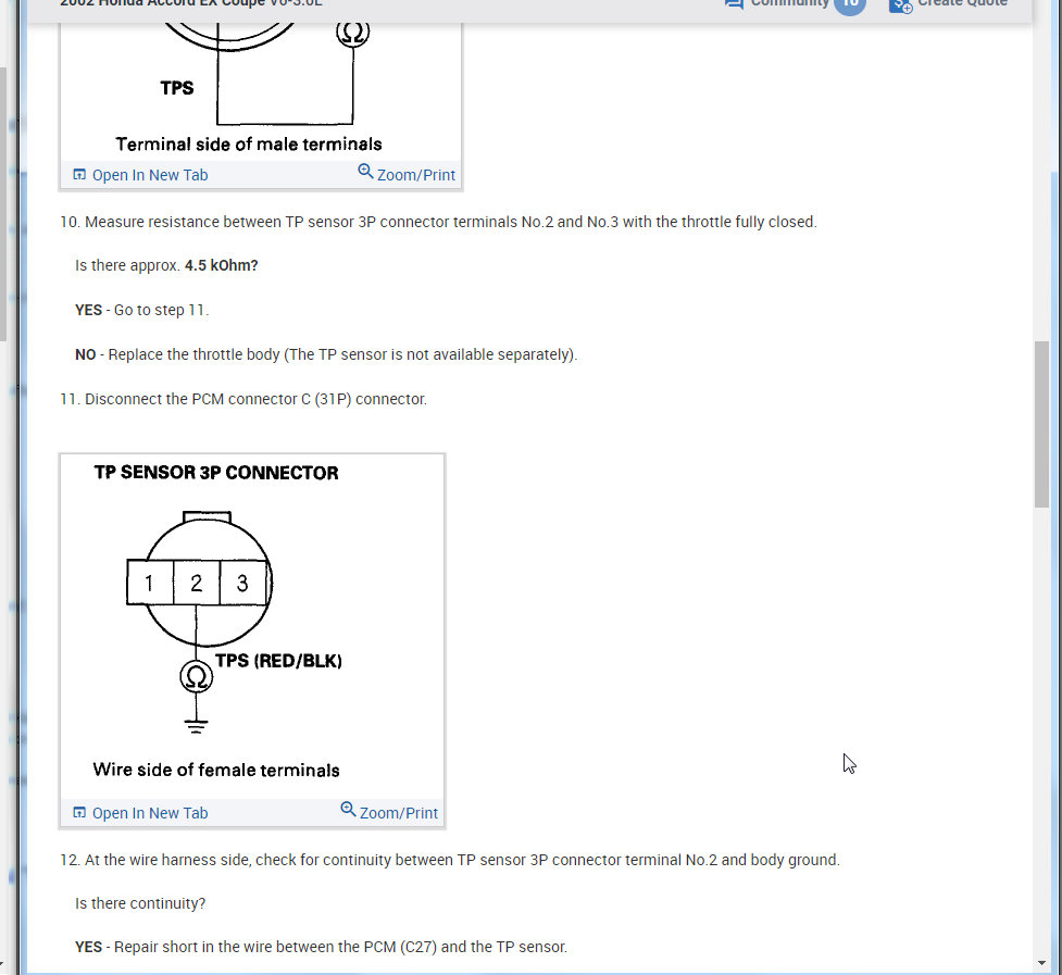

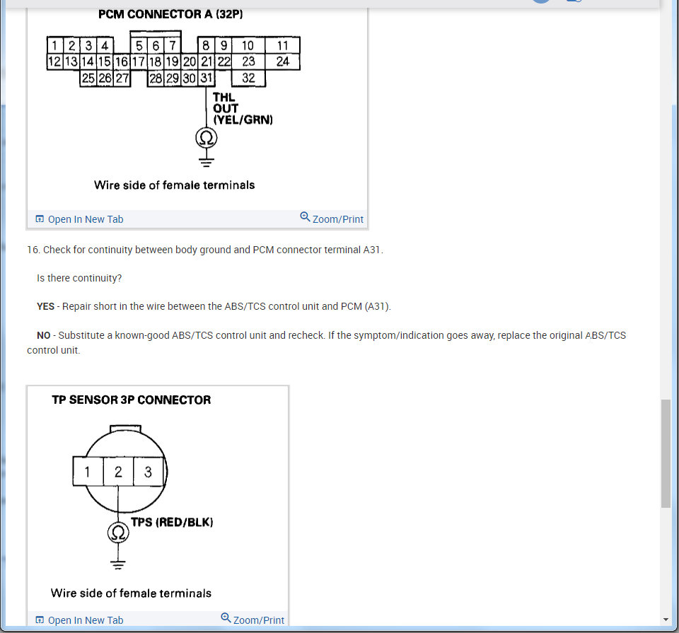

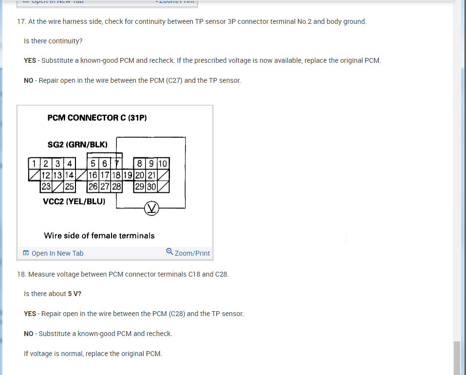

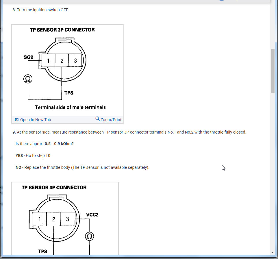

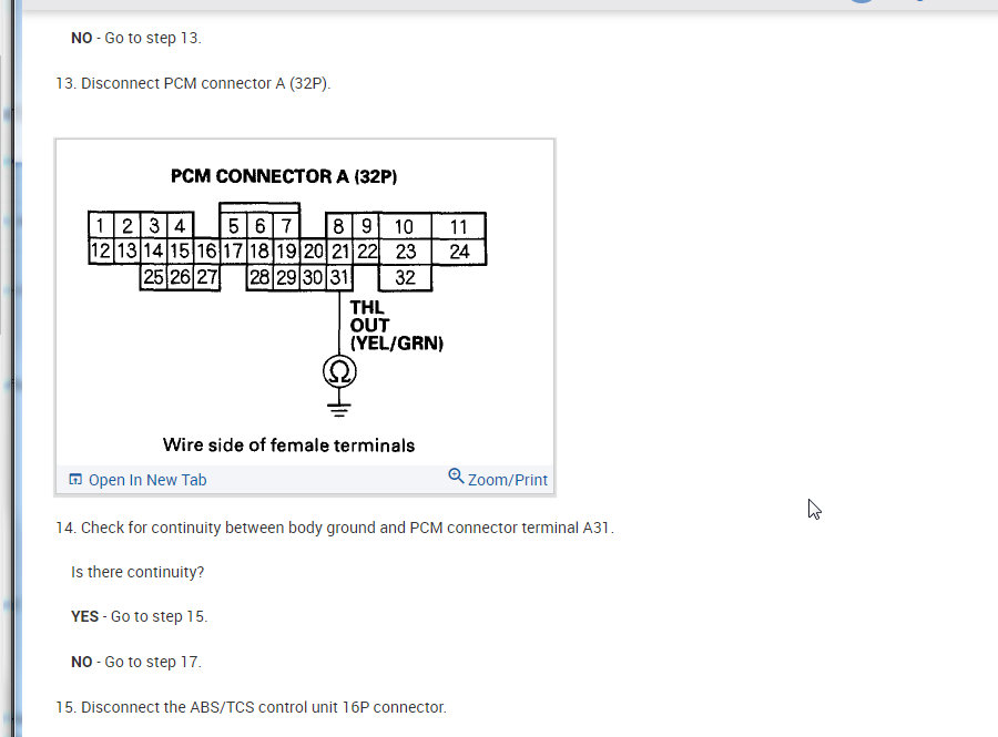

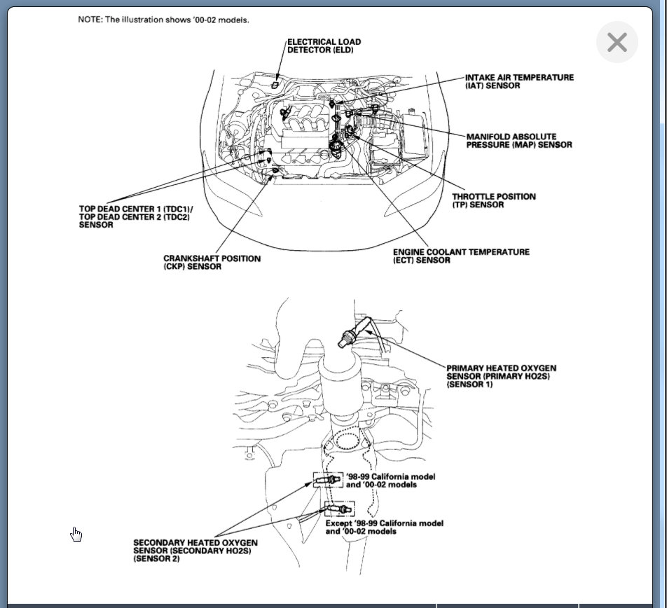

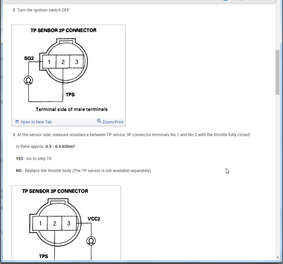

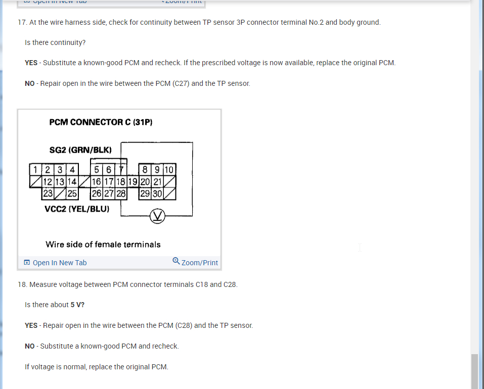

This could be the sensor but there are some other possible causes as well so it is a good idea to run through this testing to find out for sure.
Here is a guide that will help with this:
Below is the testing that we need to do and the location of the sensor which should give you what you need.
Let us know what you find with this and we can go from there. Thanks
