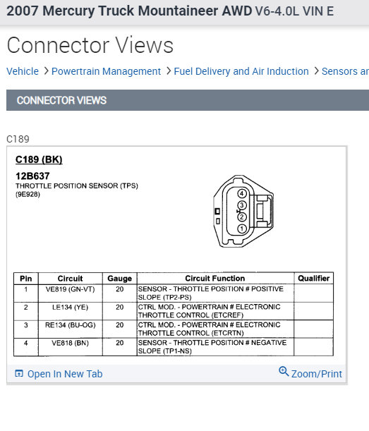

I replaced my vehicle's TPS sensor.
Now the car starts up but when I depress the accelerator pedal car does not rev up . I can just hear the engine running.

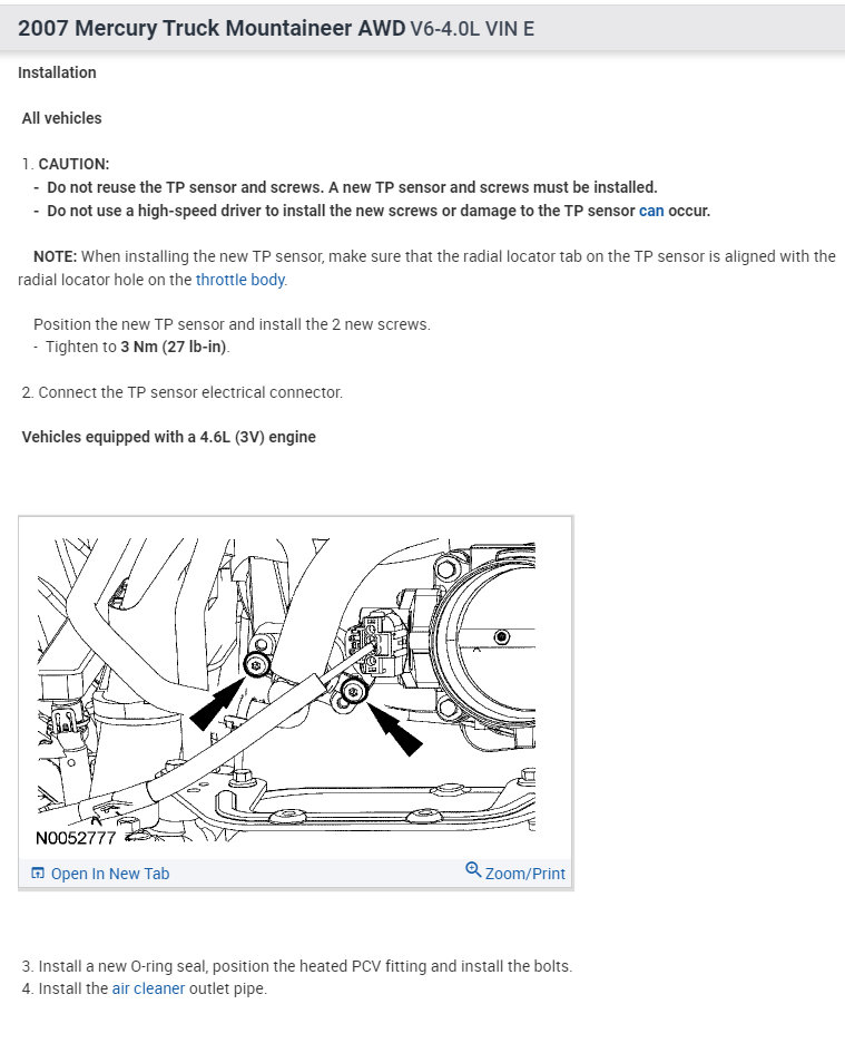

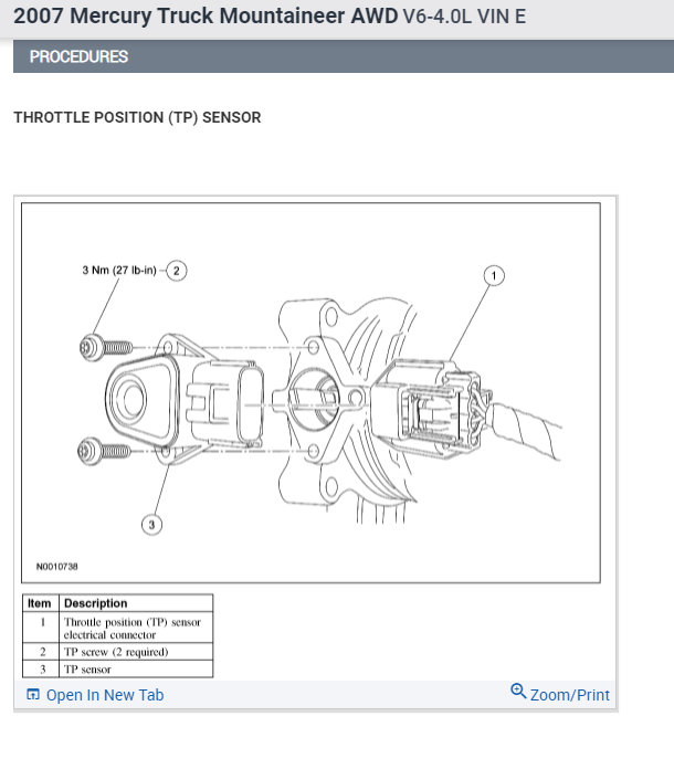

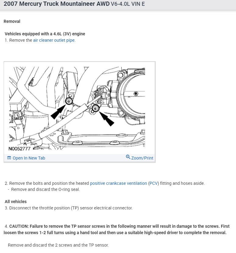

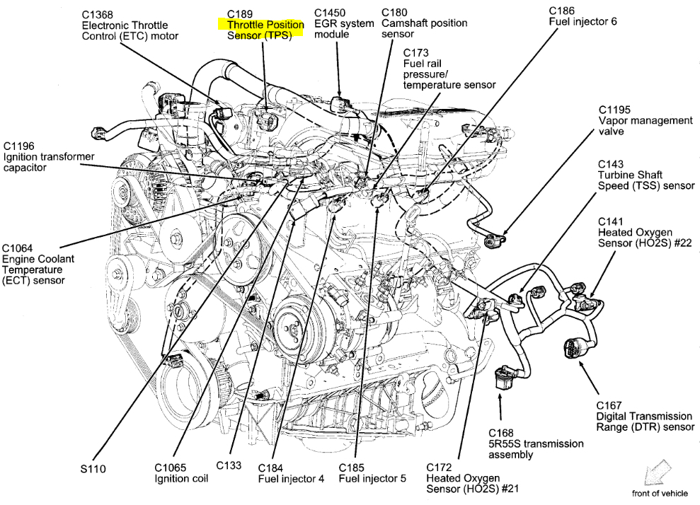

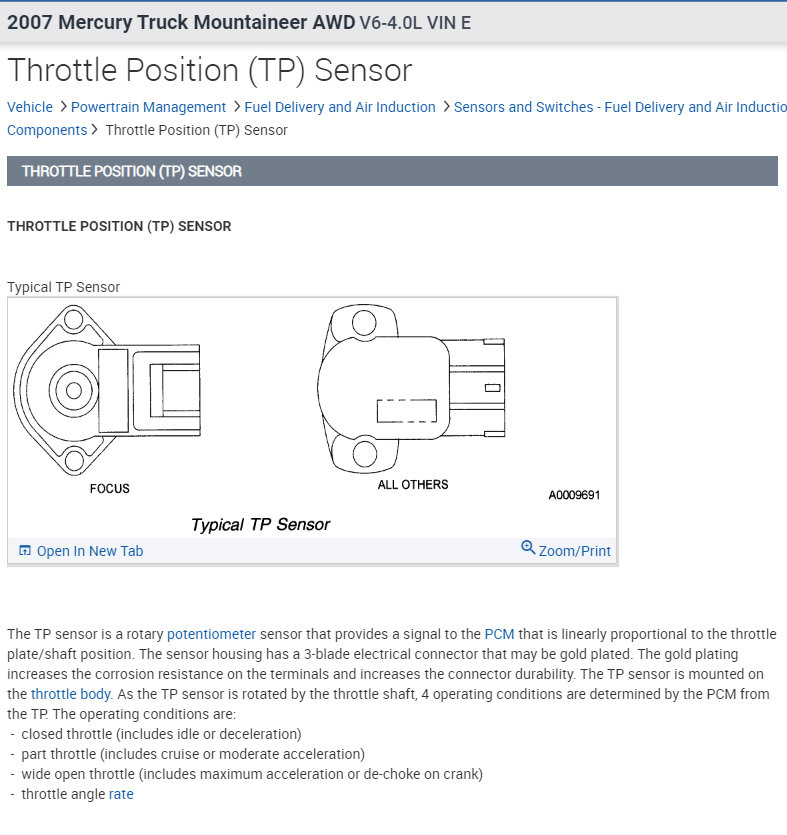

Did you have this issue before the replacement of the throttle position sensor?
If you did not, then the problem is likely the new sensor.
First make sure that it is connected properly and secured.
This vehicle is equipped with an electronic throttle actuator, and if it is unplugged, the accelerator pedal input will not be received by it and the engine will not rev up.
https://www.2carpros.com/articles/how-a-throttle-body-works
I have attached diagrams for the replacement procedure below for your reference.
