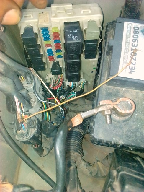

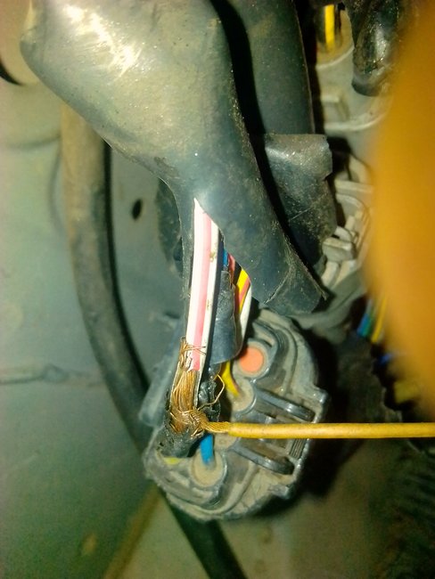

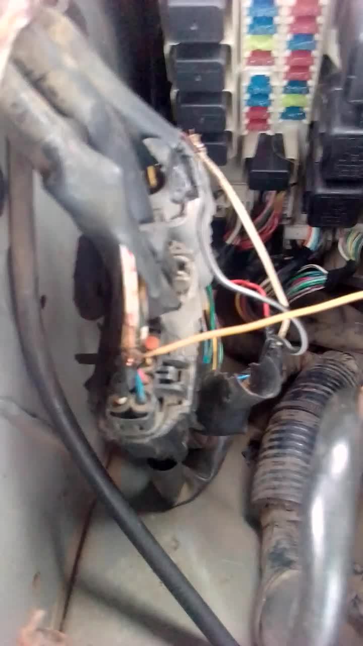

While I was checking the ECU grounds I divorced that there was a connection form the bunches of wires beside the battery, clipped to the chassis. I do not know what that wire is for but it is an ignition line.
This line was used to feed the cooling fan with ignition current. So what I did was to disconnect the fan from that line and everything was okay.
And I will like to know what that wire is for.
The car works great now even though there are other problems with the car but my main concern was that of throttle body reset and it is working now even without throttle body reset.
Thanks once again and God bless.
Nov 7, 2018 at 6:45 AM
Wow, nice shots. that is a real butcher job.
My concern is why it was done. do the fans work correctly? That wire was added to bypass something? Make sure everything works as it should. If something does not work, let me know.
Nov 7, 2018 at 6:49 AM
CHRIS SMART
  • 6 POSTS
What I noticed was that the fan was replaced with another fan that was not for the And the relay for the fan was powered through this wire.

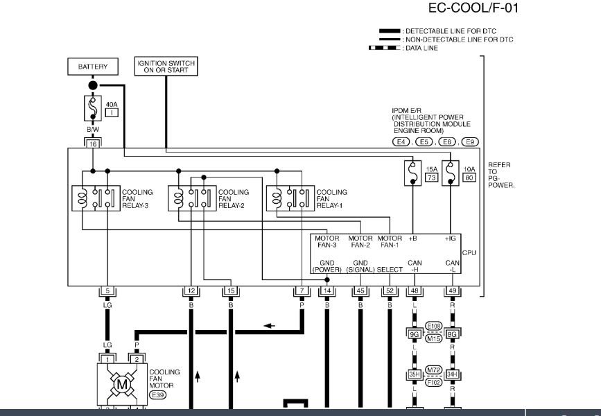

I attached a diagram for you to view. Check all three fuses for power on both sides with the key on.
Check the black wire, I believe for power to the relays as it feeds all three.
