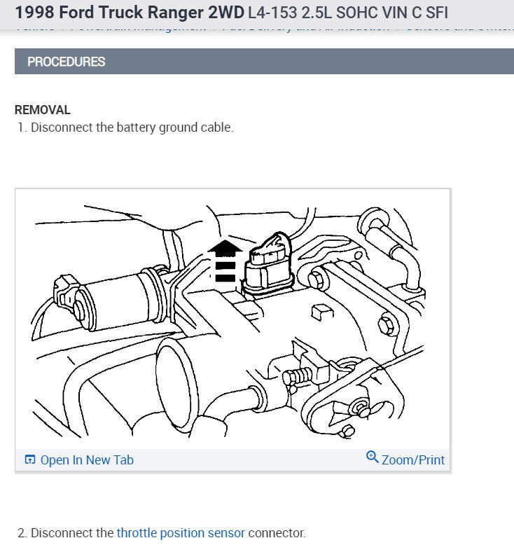

Where is the TPS located?
1998 FORD RANGER
150,000 MILES • 2.5L • 4 CYL • 2WD • AUTOMATIC
BDOGTHEBEAST
It randomly jerks between 50 to 60 MPH, and it stalls randomly sometimes. I believe it’s a Throttle position sensor, but I don’t know where it’s located.

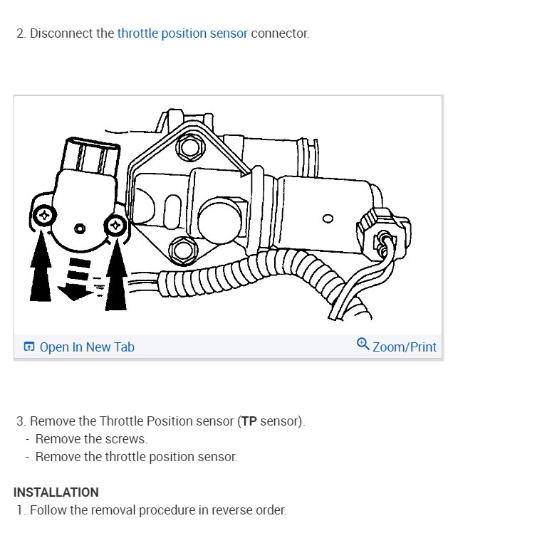

The TPS is located on the throttle body. Here are the instructions on how to change it out. Check out the images (below). Please let us know if you need anything else to get the problem fixed.
