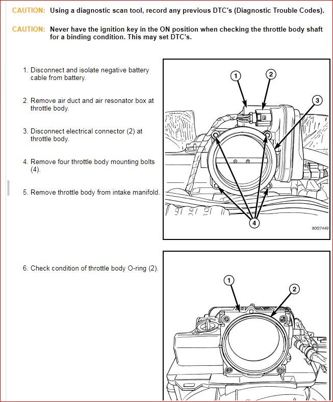

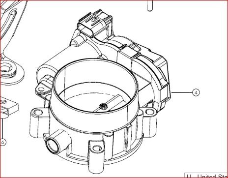

Do I have to change out my whole throttle body or can I just change out the sensor?
Saturday, June 8th, 2019 AT 11:47 AM
MECHANIC
18,907 POSTS
Hi Pheniox,
Unfortunately you need to change the entire throttle body. The sensor is part of the assembly.

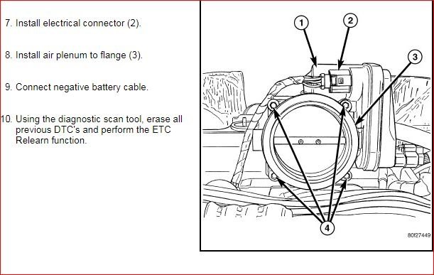

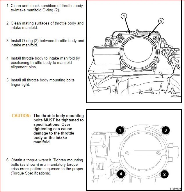

I attached the process for removing it and installing it. Also, a screen shot of the part itself that shows the TPS on the side of the throttle body.
Let me know if you need more information. Thanks
