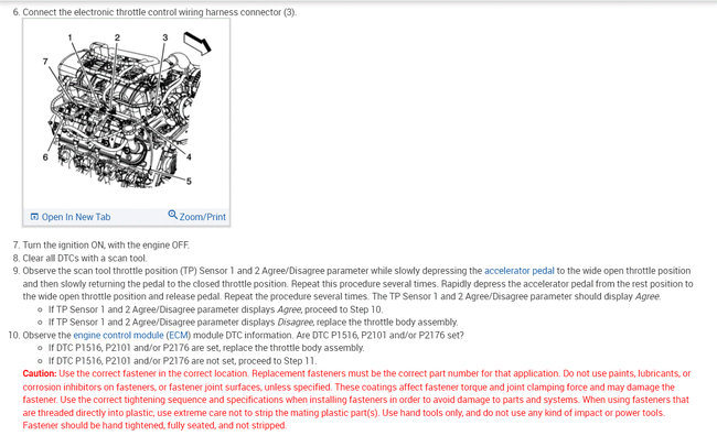

I changed my TPS and now the truck won't shift out of second.
Jan 25, 2022 at 11:58 AM
  • 110,248 POSTS

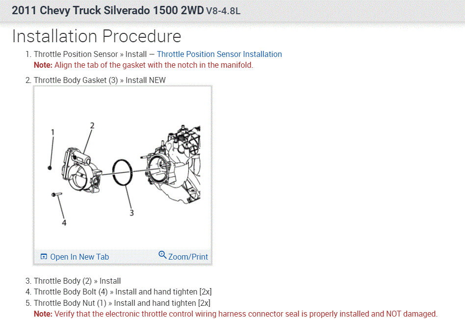

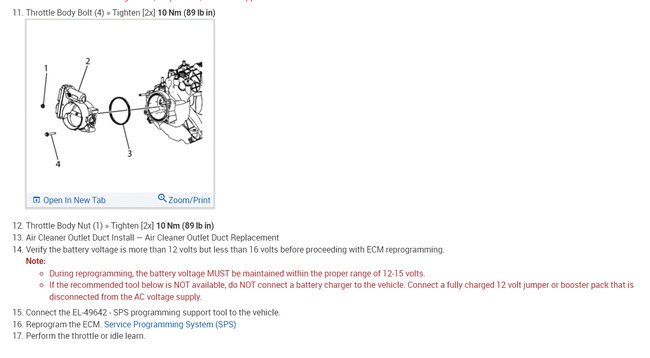

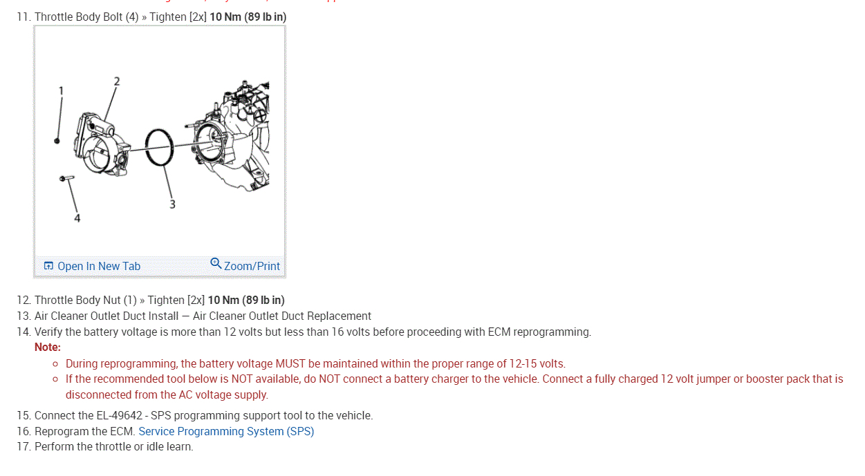

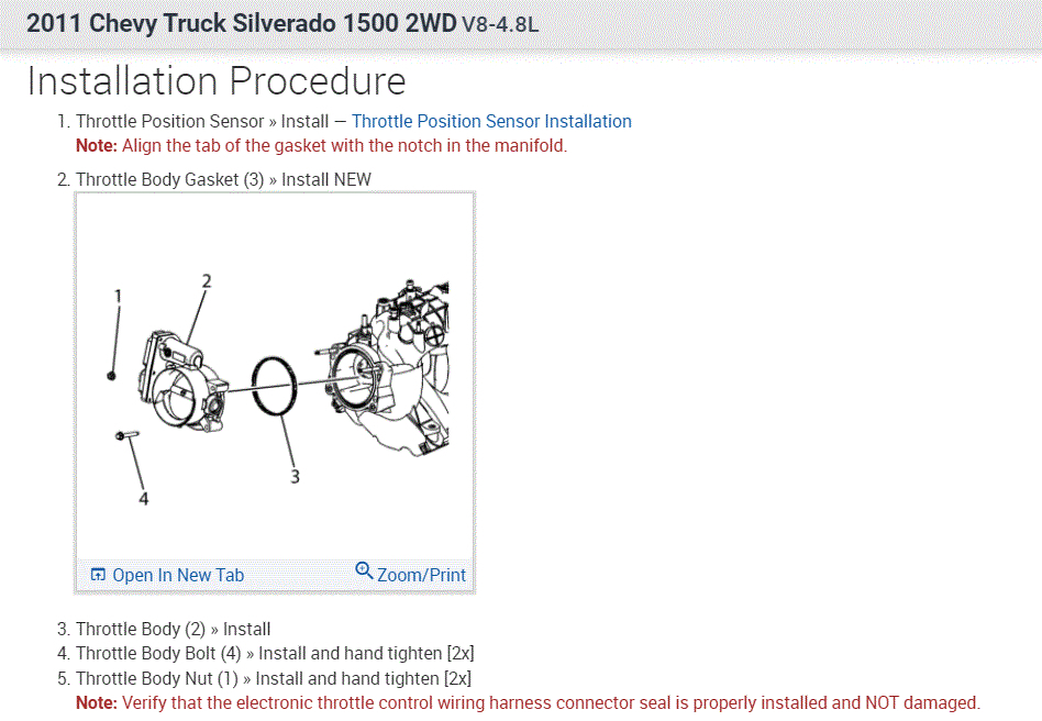

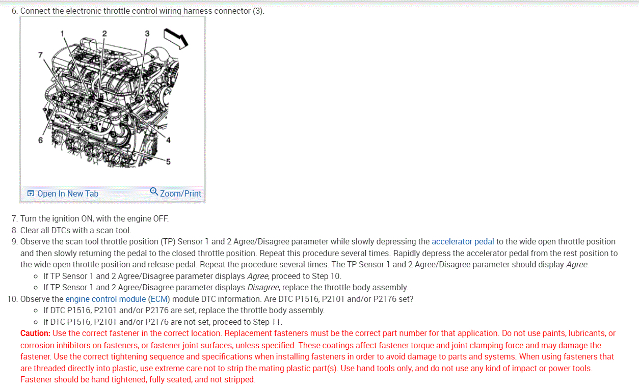

The replacement needs possible programming. The first thing you need to do is confirm that TPS 1 and 2 parameters agree. If they do and it still won't shift, chances are you will need to reprogram the ECM.
I have attached information below showing the procedures for replacement. Note that there is a section that asks you if diagnostic codes are present. Based on that, you will follow different procedures.
Let me know if this helps or if you have questions.
