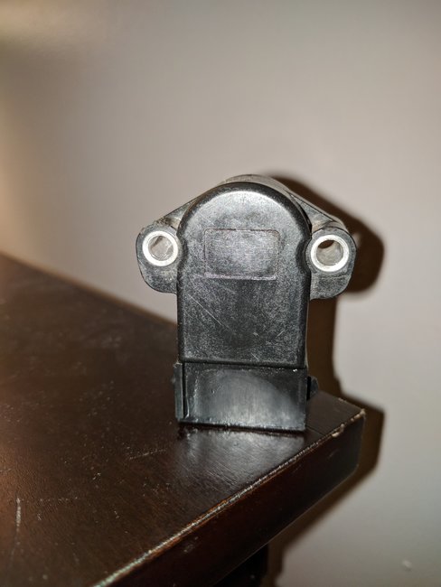

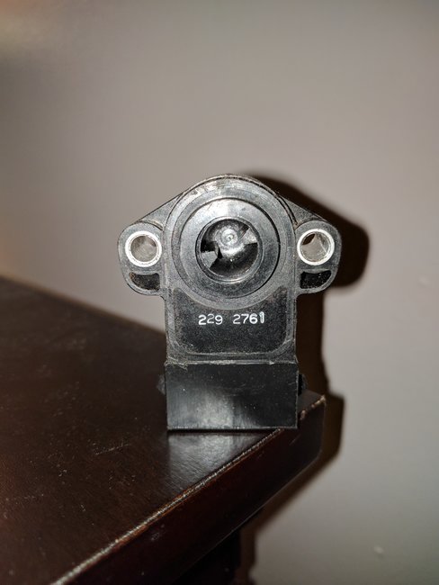

Here are the pictures of the TPS.

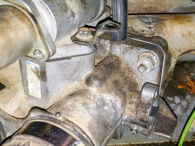

A picture of the TPS location (bottom right) on the throttle body.

The TPS just bolts on the throttle body. there is no adjustment. if there was, there would be elongated bolt holes.
Just bolt it back on and connect it up. replace the IAC assembly.
