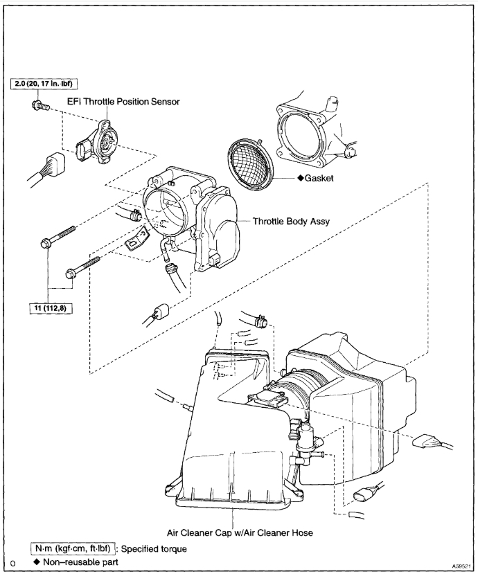

car is idling at 300 RPMs and almost shuts off when I put it in gear.
Feb 25, 2025 at 10:30 AM
  • 55,433 POSTS

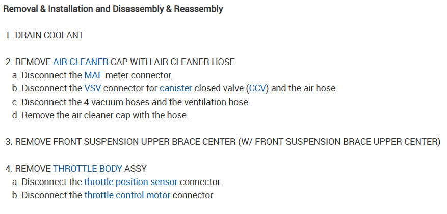

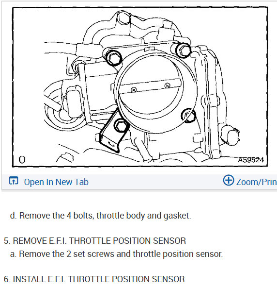

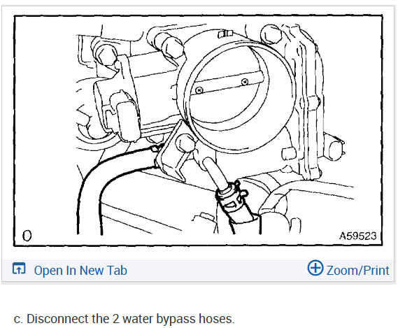

This is common when the throttle bore needs to be serviced, here are guides to help us fix the problem with instructions for your car in the images below.
and
https://www.2carpros.com/articles/low-engine-idle
Also, is the check engine light on? Check out the images (below). Please let us know what happens.
