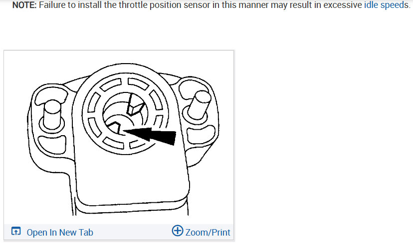

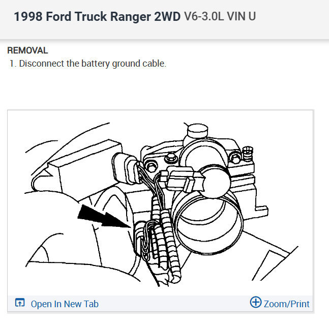

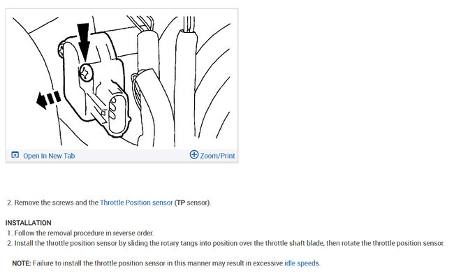

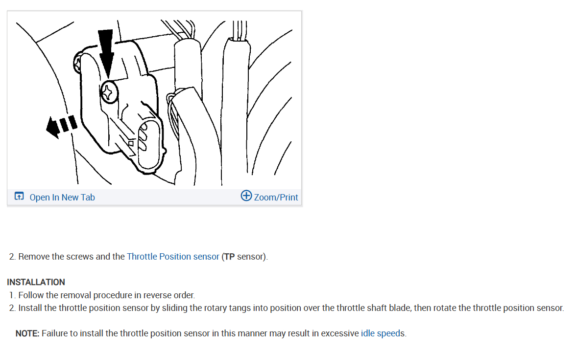

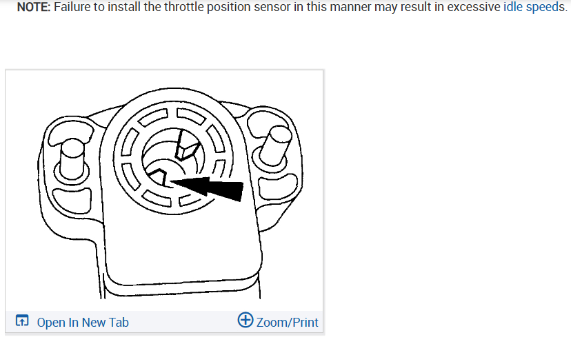

new replacement only last 15 minutes.
Oct 24, 2024 at 6:07 AM
Experienced Mechanic
55,604 POSTS
What is the trouble code? Here is the correct way to change out the TPS sensor in case you need it, but we need more information to help you. Check out the images (below). Please let us know what happens.
