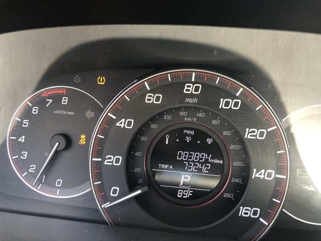

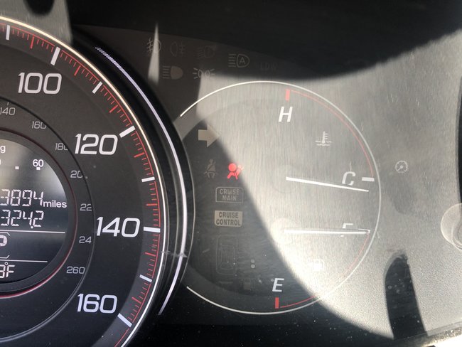

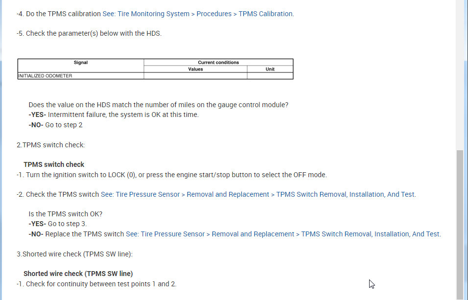

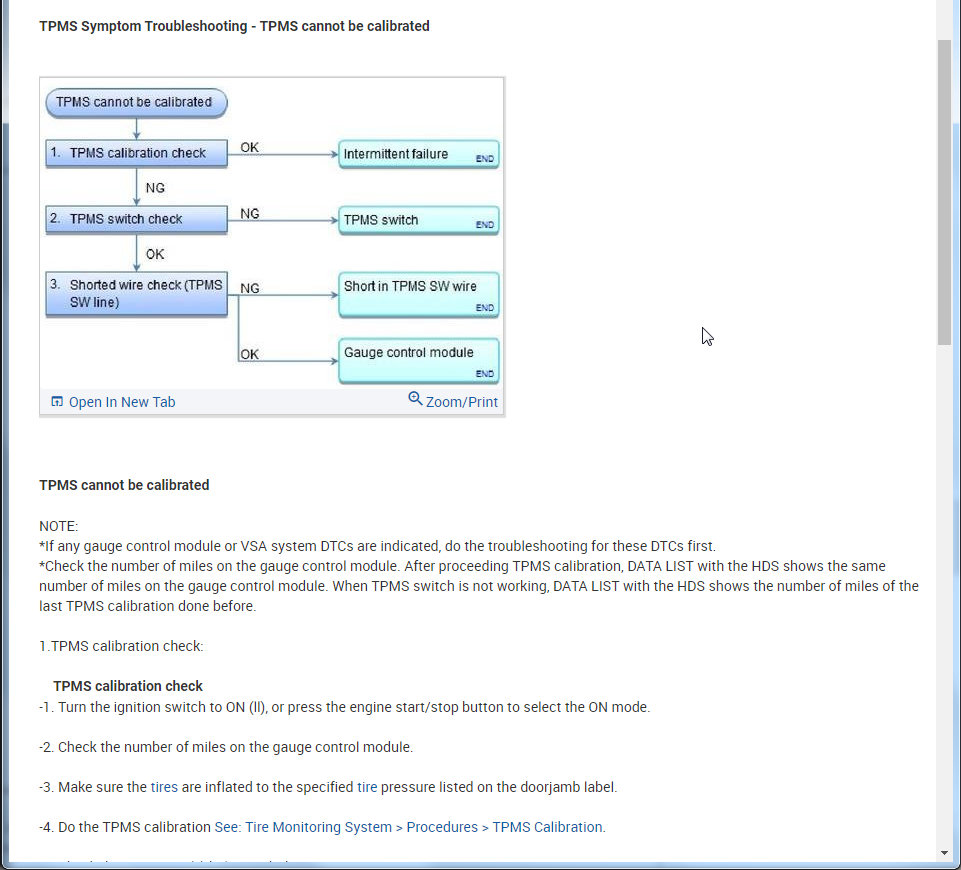

my TPMS light, VSA light, and SRS light are on and I don t know why. It has been like that since I have had the car. Every time I try to reset the TPMS/calibrate it, it never does. The TPMS just comes back. When I took it to American tire depot they said they did not know why it was on and that the wheels did not have TPMS monitors in within them that my car has it within the body. How would I fix this problem? Not sure how to approach it. please help!
Apr 30, 2021 at 3:24 PM

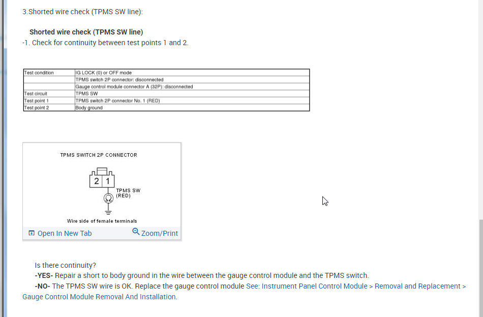

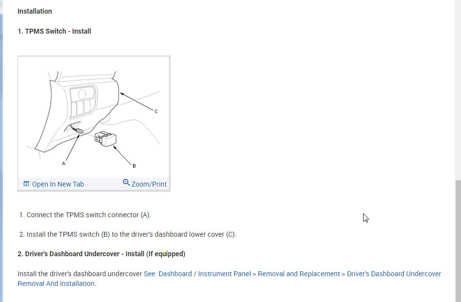

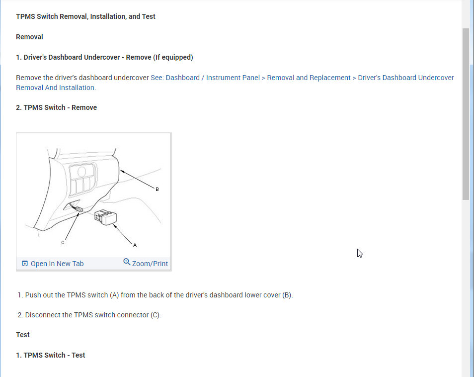

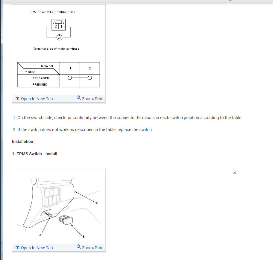

More then likely this an issue with the TPS switch. I am attaching the testing and process on how to replace this if this proves out.
Please run through this material and let us know what you find with it.
As for the other lights, we need to know what codes are in the modules.
Please get the codes and we can go from there on those.
More then likely they are not related to each other so we need to solve each issue one at a time and if it happens to solve another then that is just a bonus.
Thanks
May 2, 2021 at 1:39 AM
JPEREZ489
  • 26 POSTS
Hello! Sorry, I have taken so long to reply. The only code I’m getting is 61-11 code.
May 28, 2021 at 7:58 AM
No problem. We are always here. That code may be the issue so we need to start with running through this testing as that is for the VSA system.
It has you check the battery as well in this so here is a guide that will show how to load check it as just using a meter on the battery may not show an issue:
I attached the info below. Please let us know what you find with this.
