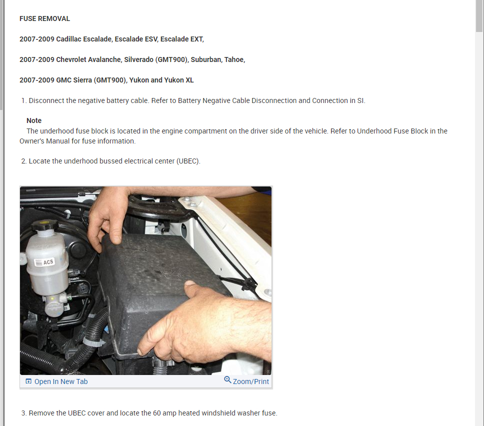

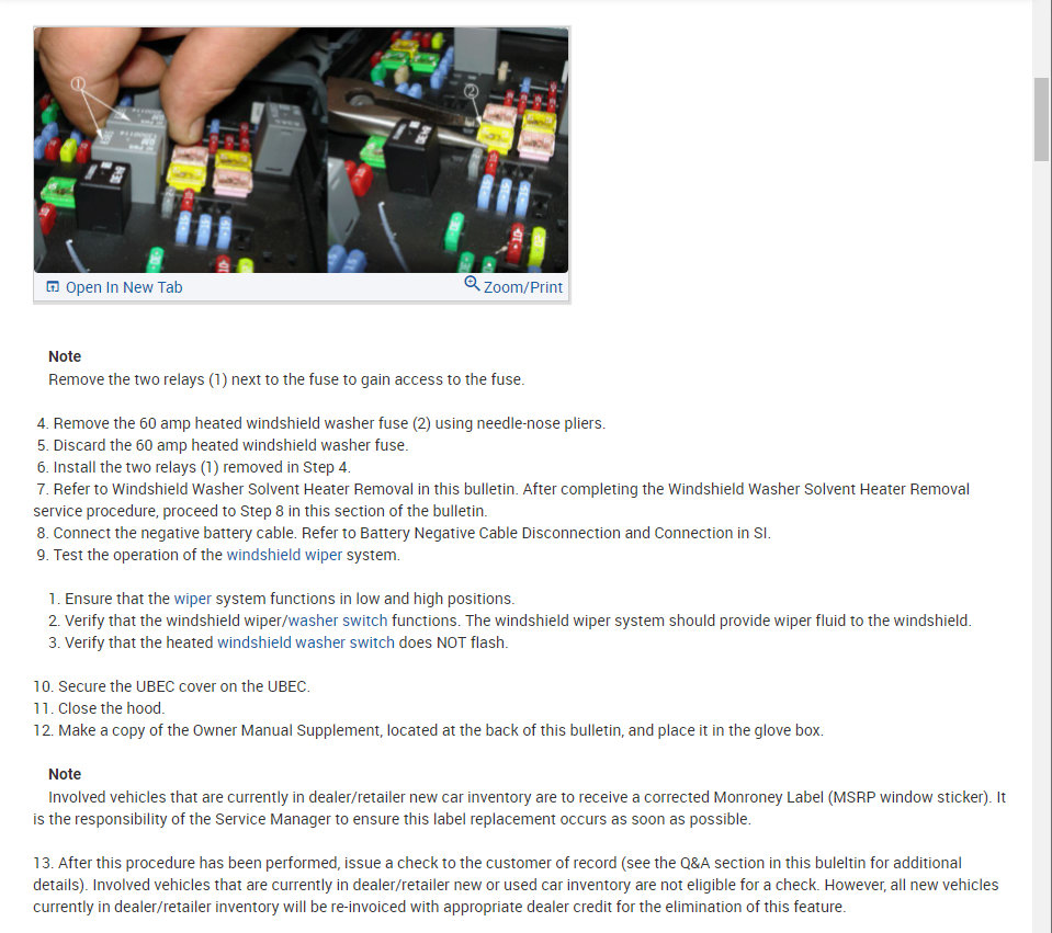

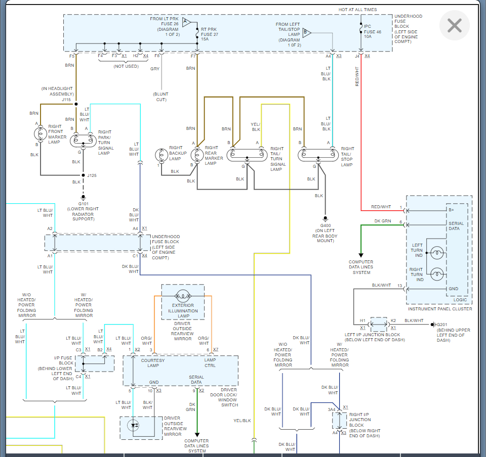

In addition, I have no brake lamps, both bulbs have been changed and still not working. I need to check the fuses.
Jun 2, 2016 at 12:44 PM
If you have no brake lights at all, then this could be a brake lamp switch as well, so that is something we need to check.
However, here are a couple guides that will help with testing and replacing fuses:
Below you will find the info about the fuses from the manual and the wiring diagram for the brake lights that will help as well.
Please run through this info and we can go from there. Thanks
