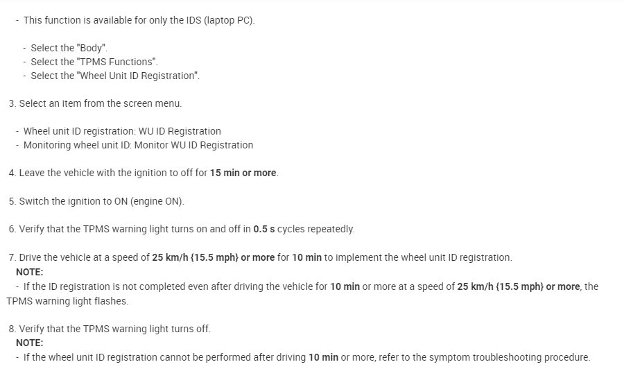

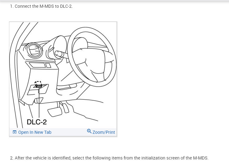

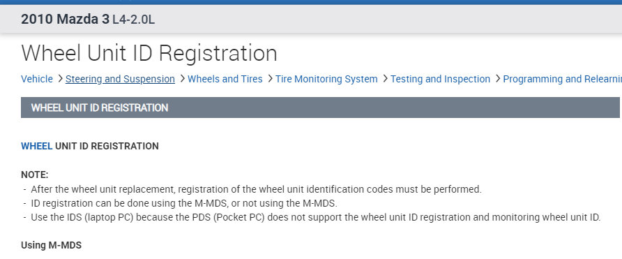

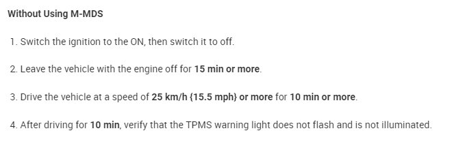

I'm not familiar with the tool you purchased. The TPMS registration can be done with or without a scan tool. Pic 1 explains how to do it without.
The remaining pics are directions using a scan tool.
Take a look through them and let me know if you are comfortable trying them or if you have other questions.
See pics below

Thank you for replying. I already the first instruction by driving the car. That didn't resolve the light going off. As for the VXDAS EL-50448 Auto TPMS Reset Tool, it was recommended by Mechanic Base.com. “The reason this makes it at the second place of our list is the simplicity it offers. With just a click of the button, you can begin testing your car pressure. If you are new to TPMS tools then this is the right model, to begin with. Operation is through a simple three-step process. Firstly, you set the device at Learn mode then place it near the sidewall where the valve stem is. Once you press the learn button, the sensors will be reprogrammed. The TPMS tool is compatible with most GM cars, but you can still use it for an Audi, Ford, Honda, BMW, Mazda, Mitsubishi, Subaru, Renault, and Toyota. This is because the device is compatible with all tires having 315 and 433 MHz TPMS. The downside is that the device does not work with trucks”.

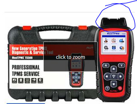

I tried to find a pic of the old tool I had and can't find it. I have updated and the new one works differently. I attached a pic below of a different tool that in general appears the same. The slot that I circled is where I would first place the old sensor to copy it, remove it, and install and program the new sensor.
I hope in some way this helps. Let me know.
See pic below.

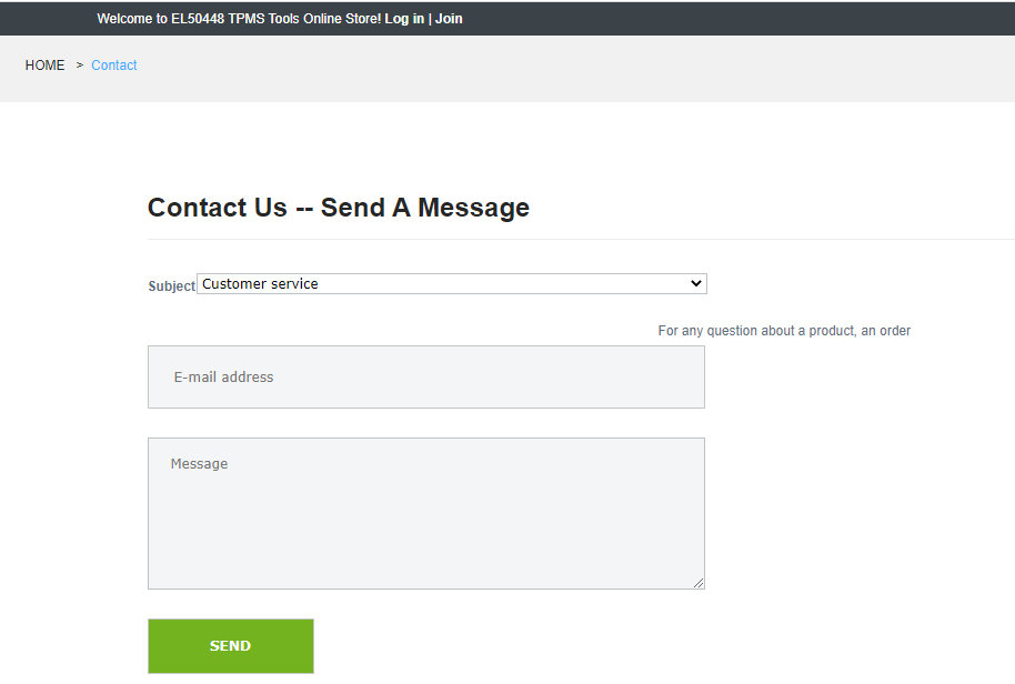

What do the directions indicate as far as programming? There has to be a way it's done. Also, is there a customer assistance number you could call? I found their website, but where it says contact us, they want an email. See pic below
Let me know what you find or if I can help in any way
See pic below.
