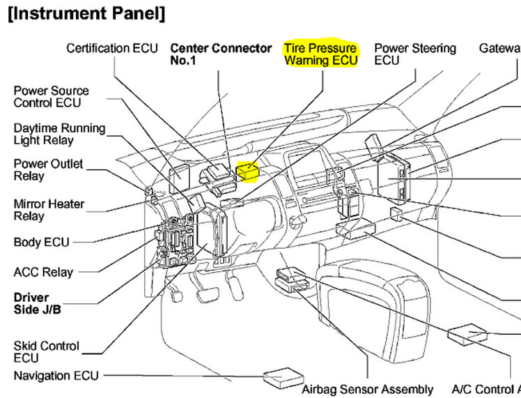

I was told my TPMS module is broken. I was going to change it myself, but I cannot find it. It wasn’t behind my glove box or in the hatch rear side panels. Does anyone know where it’s located and how to get to it? Thanks
Jun 4, 2023 at 2:56 PM
BORIS K
  • 836 POSTS

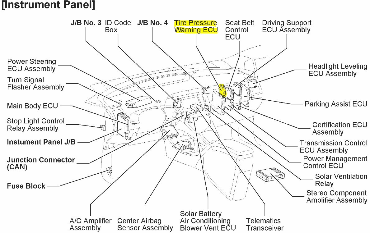

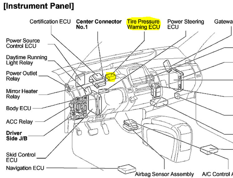

The TPMS module is located behind the passenger side dash panel or behind the instrument cluster.
See images below, marked in yellow.
Cheers, Boris
