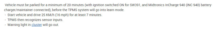

Low pressure tire light, the light flashes yellow for a bit then goes solid, TPMS light?
2010 VOLKSWAGEN JETTA
152,000 MILES • 2.5L • 5 CYL • 2WD • AUTOMATIC
SBMISRY
  • 60 POSTS
This didn't start until after I did a vacuum pump delete. (Has battery out). When reinstalling battery, I arched out. So, I'm wondering if this could cause this.
Jan 12, 2024 at 7:54 AM
  • 110,244 POSTS
I know that to reset the TPMS system, it is important to maintain battery voltage to prevent issues. Do me a favor. Take a look at the directions I attached below for resetting the system. Let me know if you are comfortable performing what it explains.
Note that it indicates to keep a battery charger on while doing this because the key is on for a long time to perform the procedure. If you have a charger, make sure to do it. Also, let me know what you arced when installing the battery.
See pic below.
