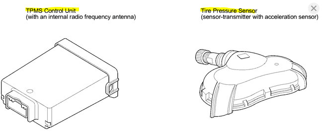

So, I've occasionally seen the low tire pressure light come on (looks like a flattened U with "!" In the middle) and I just top up the air and it goes away. But today a different light came on that plainly says TPMS. I checked and all four tires were a bit low due to cold weather, but the light didn't go away when I topped them off with air. I even drove it for a bit thinking it needed time to detect the air pressure, but still it stays on.
What does this light mean and how can I start diagnosing this?

Each wheel has its own sensor in it which is a part of the valve stem where you place the air. These sensors send a radio signal that is received by the TPMS control unit which is mounted above the throttle pedal.
Since the light is staying on, the first thing I recommend is having the sensors checked. The battery life in each sensor is approximately 5 years. If one fails, the TPMS loses signal, and the light turns on.
To test these, I use a tool designed to indicate a signal from the wheel being tested. It doesn't require taking things apart to check, so I would think a tire shop would be the best place to contact to see if they would take a few minutes and check if there is a signal from each wheel.
You could also have the vehicles can-bus scanned to determine if that is the issue. CAN stands for controller area network. Basically, all computers/modules are tied together via a few wires. This would indicate if there were diagnostic trouble codes stored in the TPMS control unit.
I attached a picture below showing the two components. This is really a lot easier than I likely made it sound. I check them as a courtesy if a customer asks.
Let me know if this helps. Also, please feel free to let me know if you have other questions or if I can help in any way.
See pic below.

Okay, the weather was a bit warmer today and now the TPMS light is off. Could the cold have affected the batteries in the sensors?
Jan 25, 2022 at 6:56 AM
  • 110,251 POSTS
If it came on when it got cold and off when it warmed up, that is a very common issue and nothing to worry about.
The air in the tires contracts when it gets cold. As a result, the pressure drops. If it is low enough, it will turn the light on. Once it starts to warm up and the air begins to expand, the pressure increases, and the light goes out.
This time of year, it is not uncommon for me to have 3 or 4 people stop in and ask why their light is on.
I have a feeling that is what happened. It could be a weak battery, but let's see if it happens again. If you open the driver's side door, there will be a label that has the recommended tire pressures. If the light is on, check and confirm all tires are at least to the manufacturer's specifications.
