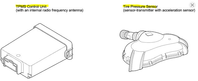

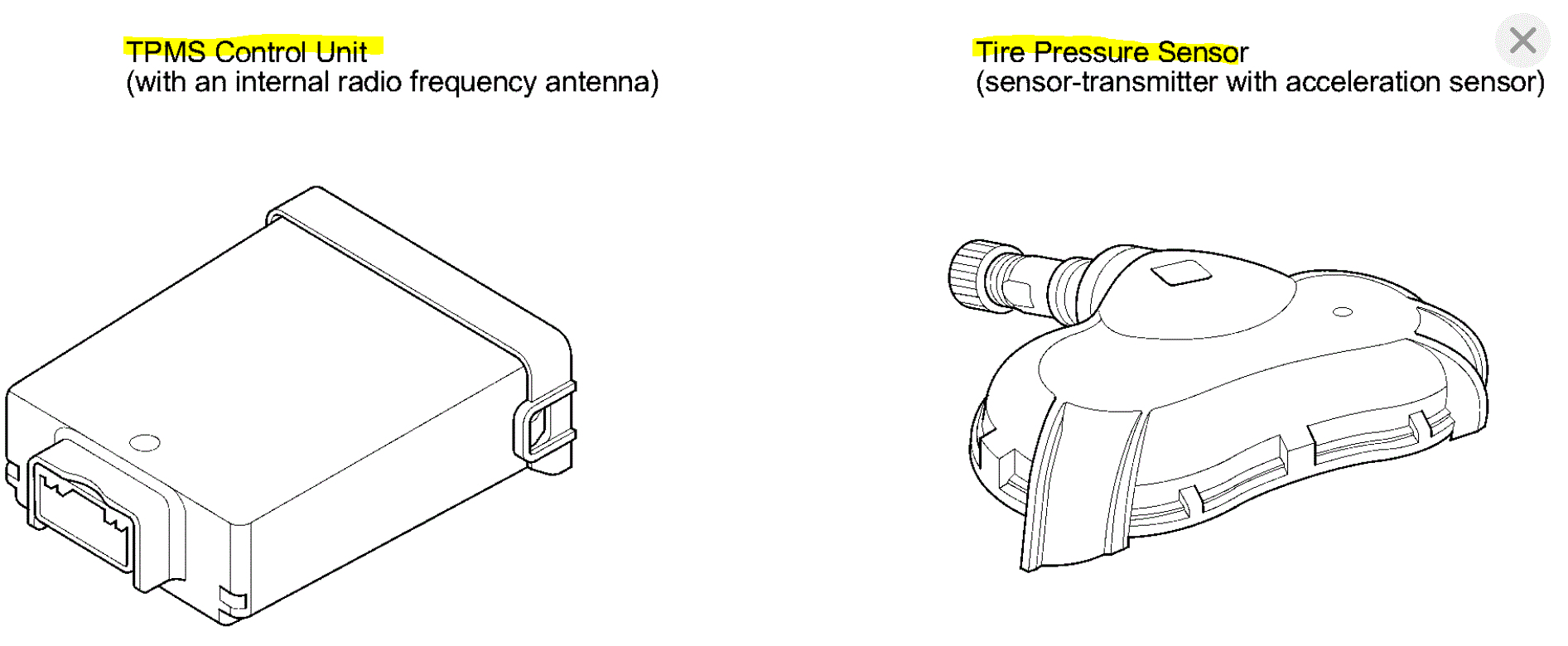

Each wheel has its own sensor in it which is a part of the valve stem where you place the air. These sensors send a radio signal that is received by the TPMS control unit which is mounted above the throttle pedal.
Since the light is staying on, the first thing I recommend is having the sensors checked. The battery life in each sensor is approximately 5 years. If one fails, the TPMS loses signal, and the light turns on.
To test these, I use a tool designed to indicate a signal from the wheel being tested. It doesn't require taking things apart to check, so I would think a tire shop would be the best place to contact to see if they would take a few minutes and check if there is a signal from each wheel.
You could also have the vehicles can-bus scanned to determine if that is the issue. CAN stands for controller area network. Basically, all computers/modules are tied together via a few wires. This would indicate if there were diagnostic trouble codes stored in the TPMS control unit.
I attached a picture below showing the two components. This is really a lot easier than I likely made it sound. I check them as a courtesy if a customer asks.
Let me know if this helps. Also, please feel free to let me know if you have other questions or if I can help in any way.
See pic below.
