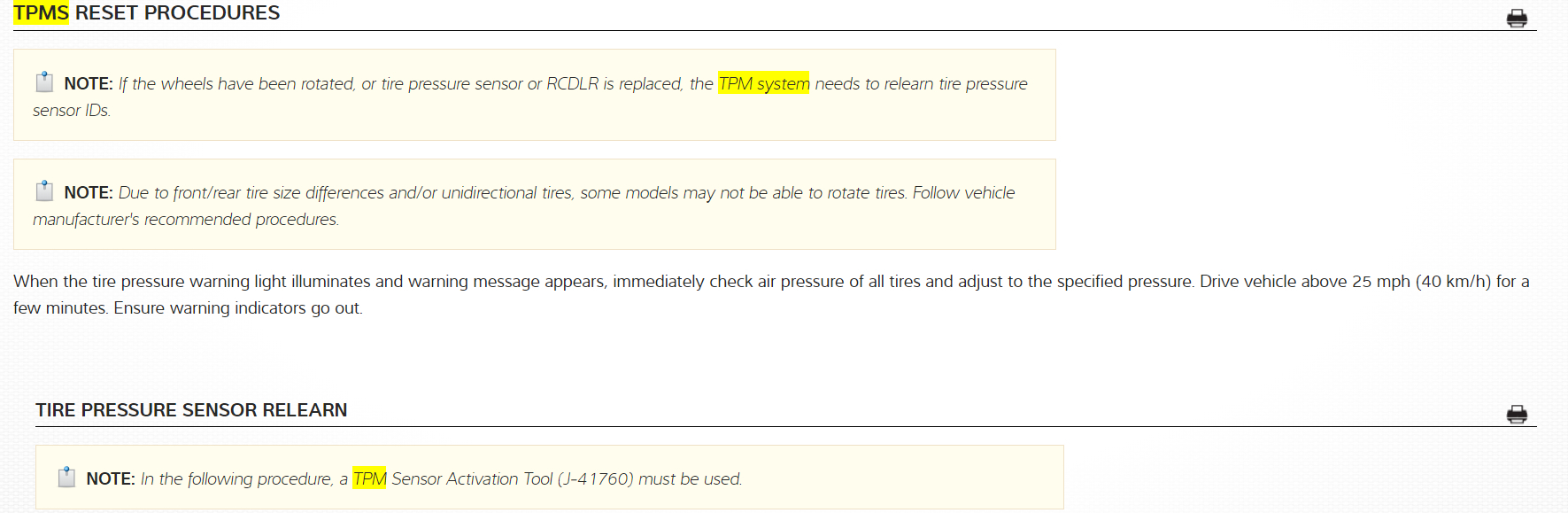

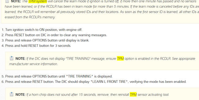

All web information says to turn key to "on" then press both lock and unlock buttons on key fob at same time for five seconds. Doesn't work. Different way on 2003 Corvette or something else?
Jun 17, 2019 at 3:13 PM
  • 54,832 POSTS

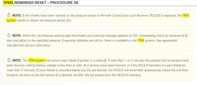

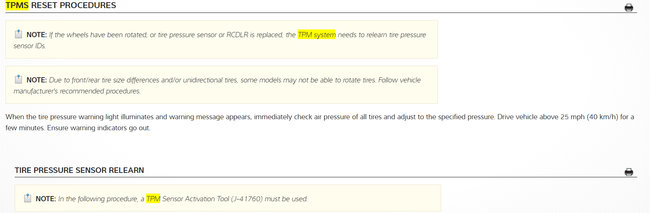

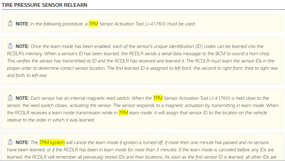

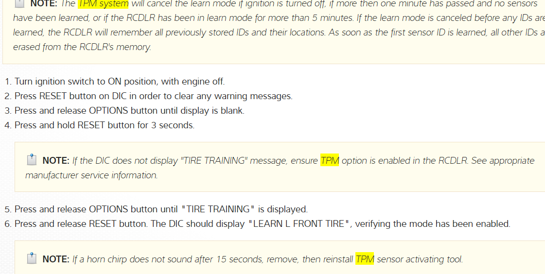

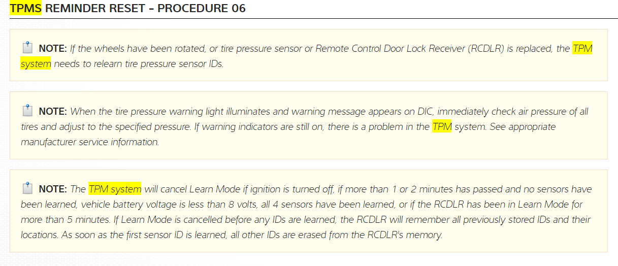

Here is the tire pressure monitoring system reset instructions with more in the diagrams below.
Set the tire pressure of all wheels to pressure specified on the tire and loading information label.
Turn ignition ON with engine OFF.
Press RESET button on DIC in order to clear any warning messages.
Press and release OPTIONS button until display is blank.
Press and hold RESET button for 3 seconds.
NOTE: If the DIC does not display "TIRE TRAINING" message, ensure TPM option is enabled in the RCDLR. See appropriate manufacturer service information.
Press and release OPTIONS button until "TIRE TRAINING" is displayed.
Press and release RESET button. The DIC should display "LEARN L FRONT TIRE", verifying Learn Mode has been enabled.
Starting with left front tire, hold a tire sensor activation tool against the side wall of the tire, within 3 inches of the valve stem. Activate tool until a horn chirp sounds.
After the horn chirp sounds, proceed to the next 3 sensors in the following order: right front, right rear, then left rear.
Turn the ignition switch to OFF position to exit the learn mode.
