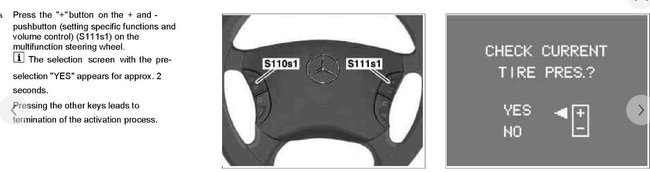

A couple of weeks ago, the battery in my car was low and I had to jump it off to start it. At first, some of the convenience features (cruise, automatic mirrors, etc) weren’t working, but as I drove it, those started working correctly.
The only thing not working now is my TPMS. When the car starts, the display says “Display Defective” and the TPMS indicator light is on.
Is there any way to reset this feature without a visit to the dealership?
Jan 24, 2019 at 3:01 AM
  • 110,248 POSTS

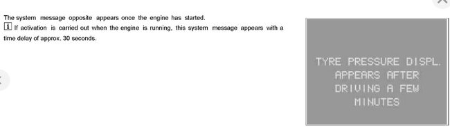

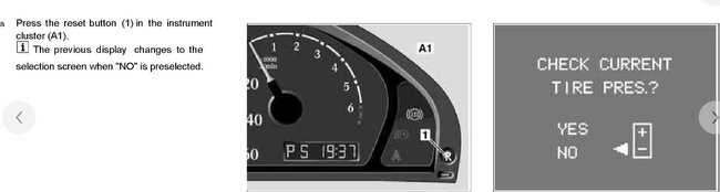

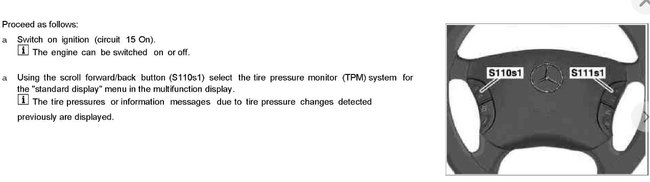

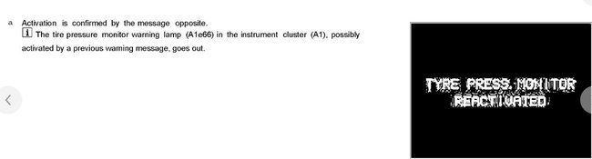

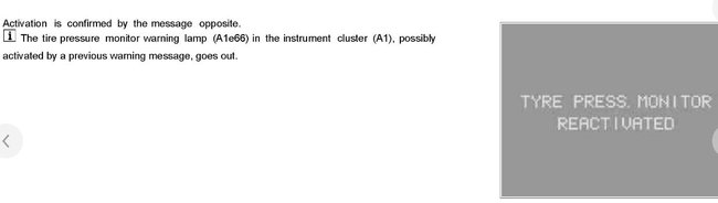

You can do this at home. I had to attach the directions in picture form. See them below.
