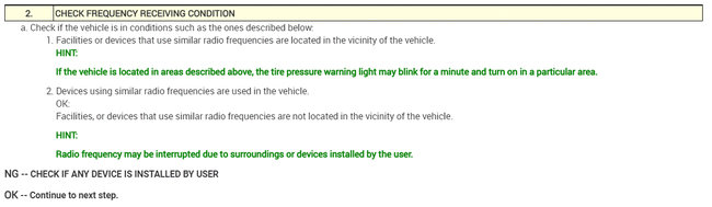

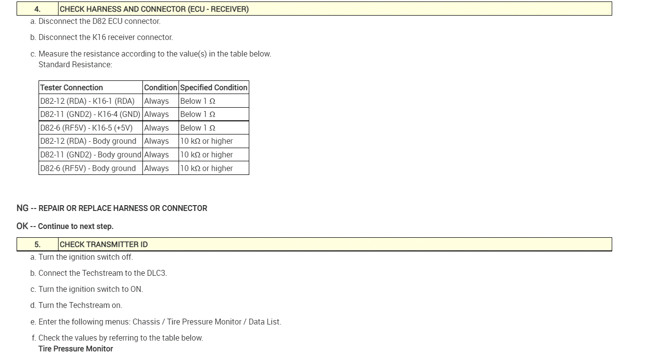

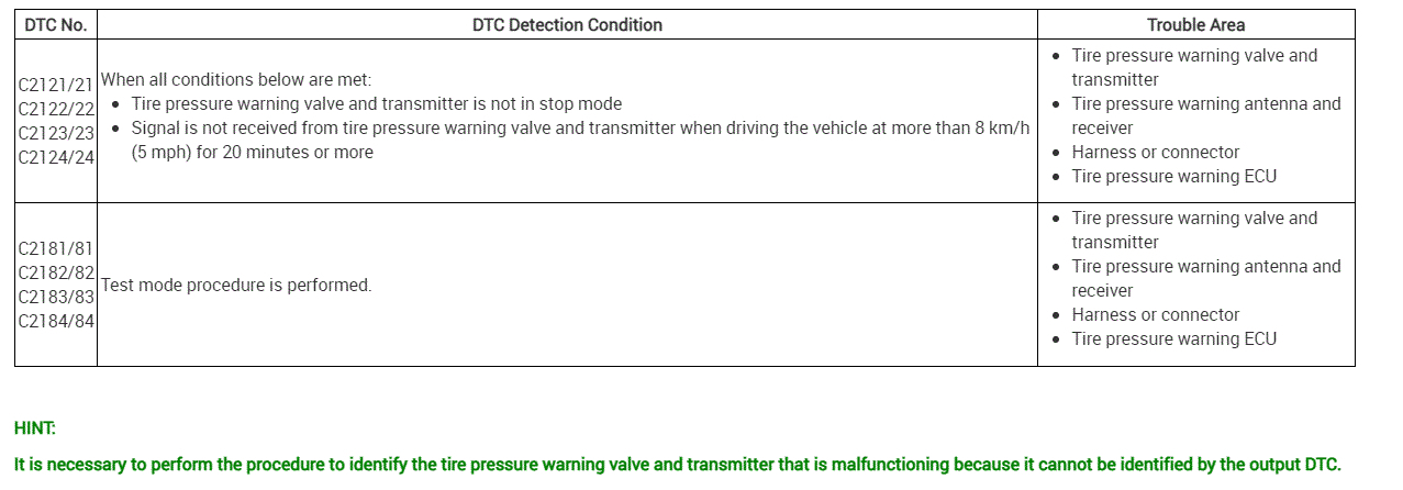

Codes C2122 and C2123
2013 TOYOTA SIENNA
271,000 MILES
DIVIDES
  • 903 POSTS

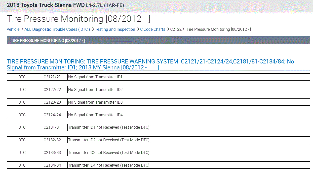

Are these for two of the wheels' TPMS sensors?
C2122
C2123
Nov 7, 2021 at 2:49 PM
  • 110,190 POSTS

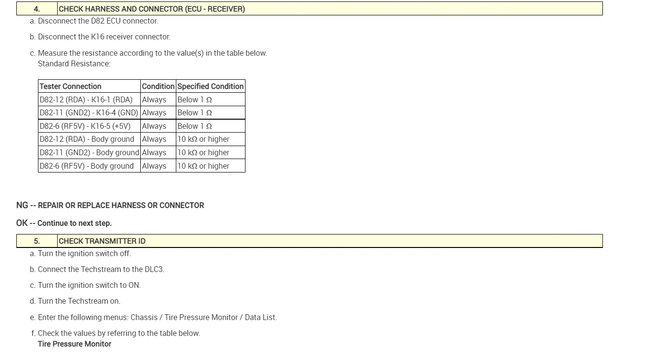

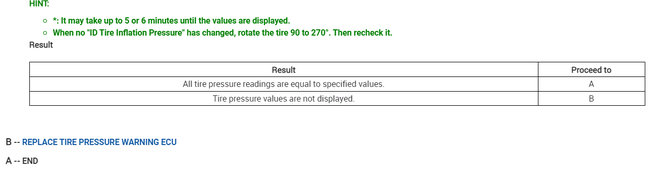

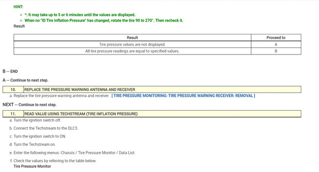

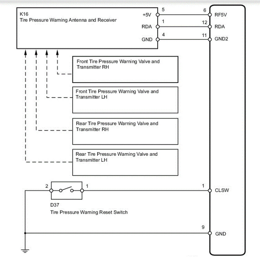

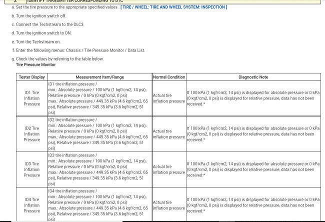

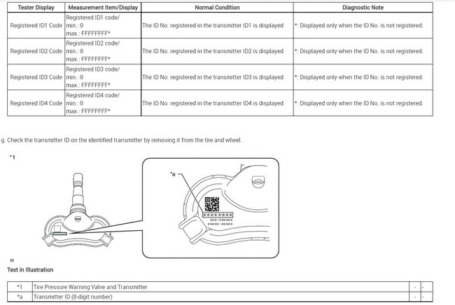

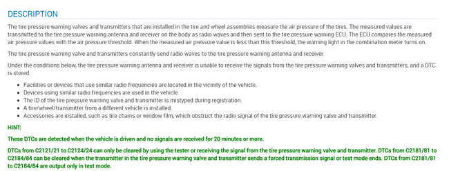

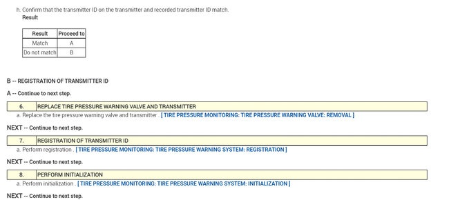

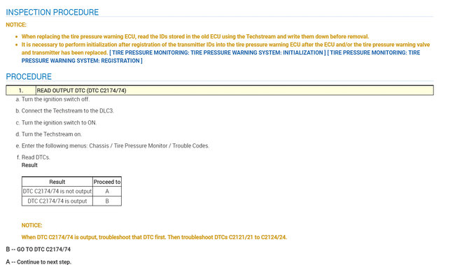

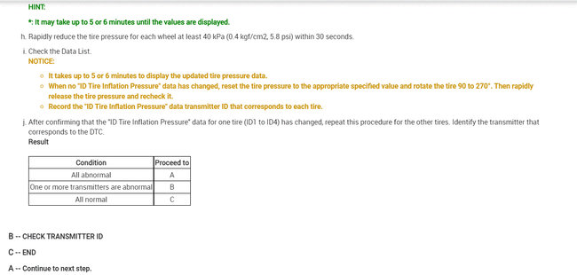

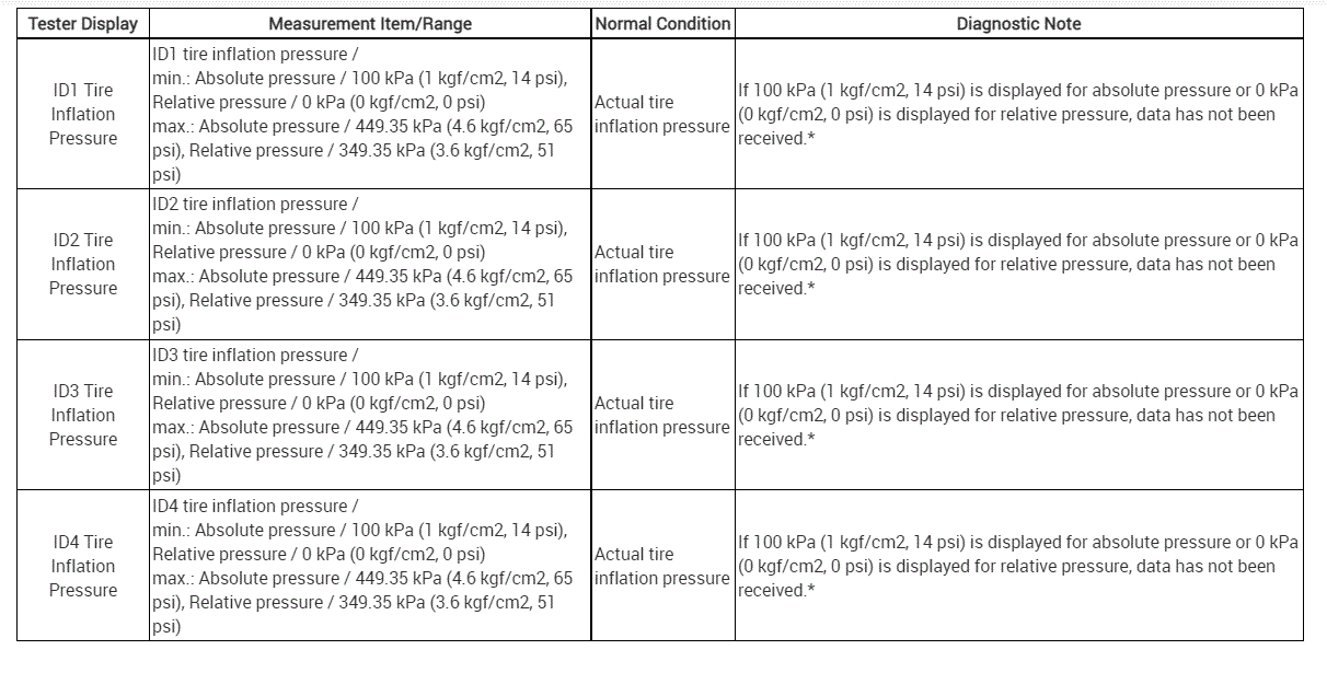

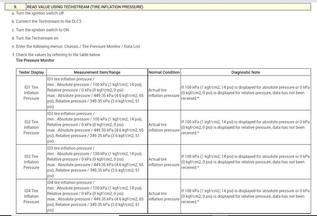

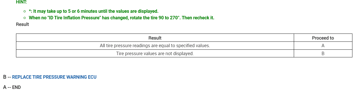

Both codes are related to the TPMS sensors, sensor 1 and sensor 2 (different wheels).

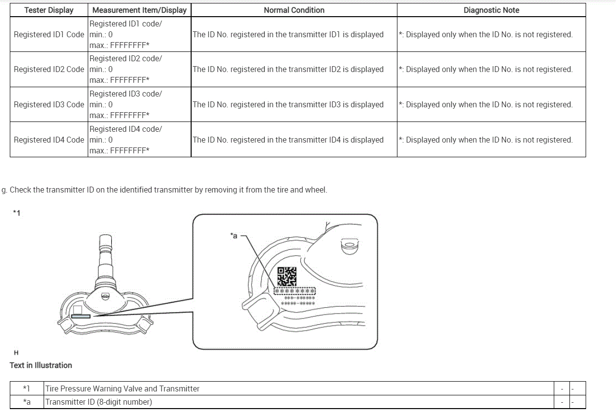

Sensor ID 1 RH Front Sensor ID 2 LH Front

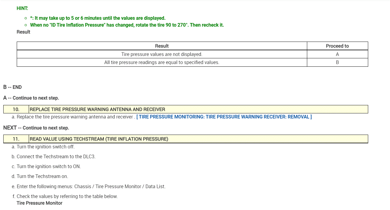

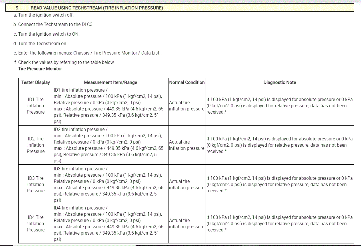

If you look below, I attached the diagnostics related to the codes.
Note: In most cases, these codes are due to a dead battery in the TPMS sensor mounted in the wheel. If you have a sensor tester, you can check to see if one of the sensors is not sending a signal.
