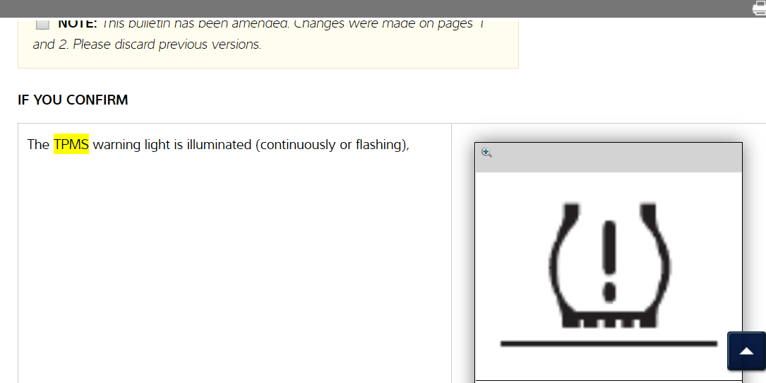

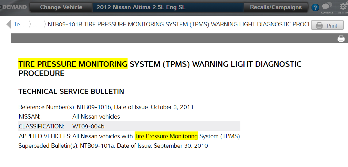

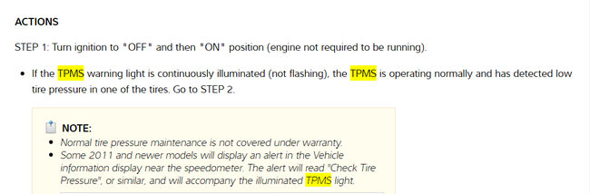

I have the TPMS light in addition to a triangular warning light saying to check tire pressure. I recently had a blowout. The TPMS went on and as soon as the tire shredded, the warning light came on. I have tried the reset procedure but it does nothing. Any ideas?
Apr 9, 2019 at 4:29 AM
SCGRANTURISMO
  • 4,897 POSTS

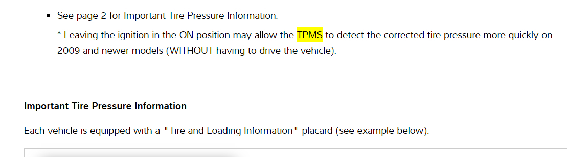

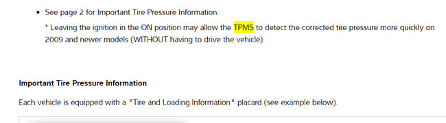

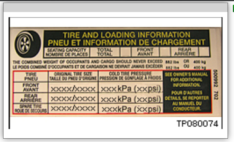

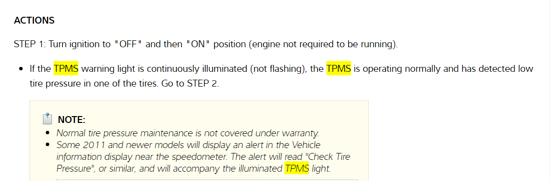

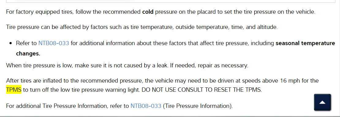

I have included for you in the diagrams down below a Technical Service Bulletin from Nissan Motor Company on an updated Tire Pressure Monitoring System troubleshooting guide. Please go through it and get back to us with what you find out please.

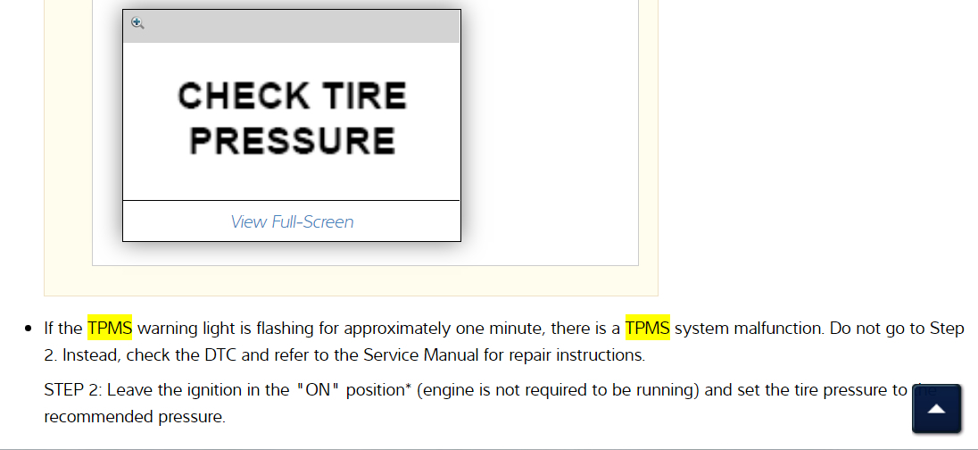

I read the pages you sent. Mine is flashing so there is a system malfunction and the instructions say to check the DTC. What is that?
Apr 10, 2019 at 12:48 AM
SCGRANTURISMO
  • 4,897 POSTS
A Direct Trouble Code (DTC) is set when there is a fault in a system of the vehicle. When a DTC sets the Malfunction Indicator Lamp (MIL) or "check engine" light will illuminate alerting the driver that there is a problem. You can hook a code reader up to the Data Link Connector (DLC) to retrieve the code. The code will tell you what is wrong with the vehicle. I have included a link below for you to go to:
Please go through this guide and get back to us with the DTC please. We will have more specific instructions for you if a DTC has set.

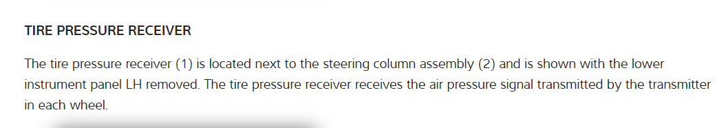

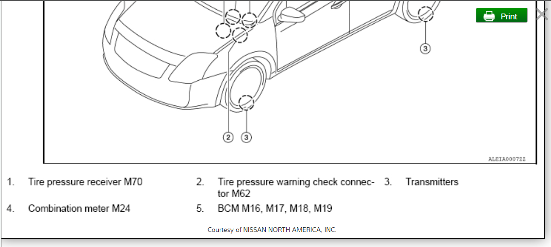

JAMESHYNES
  • 13 POSTS

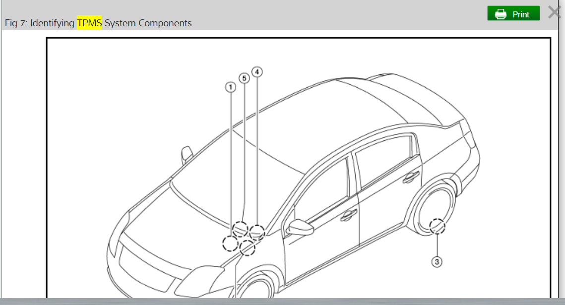

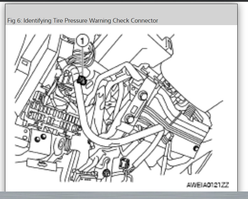

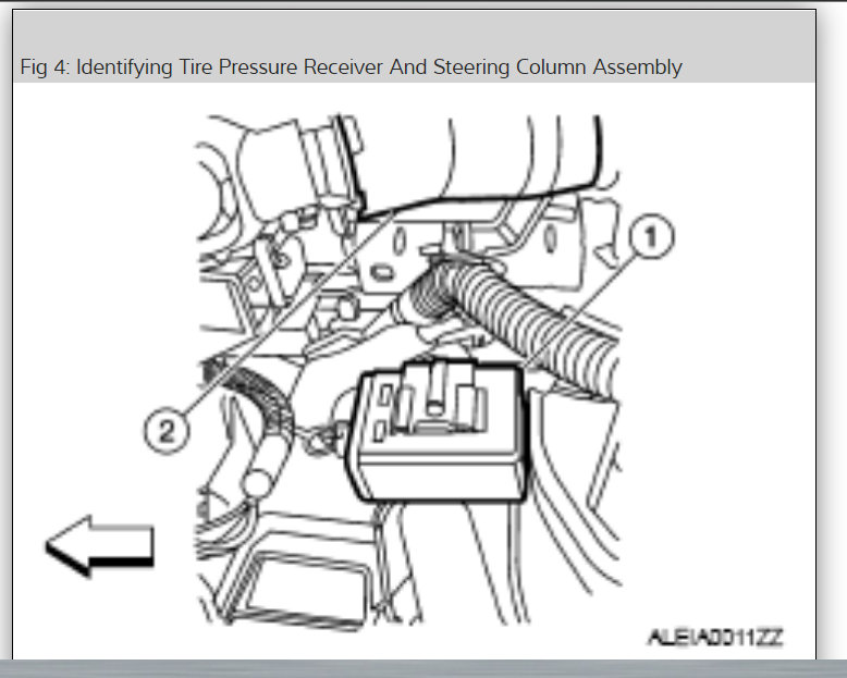

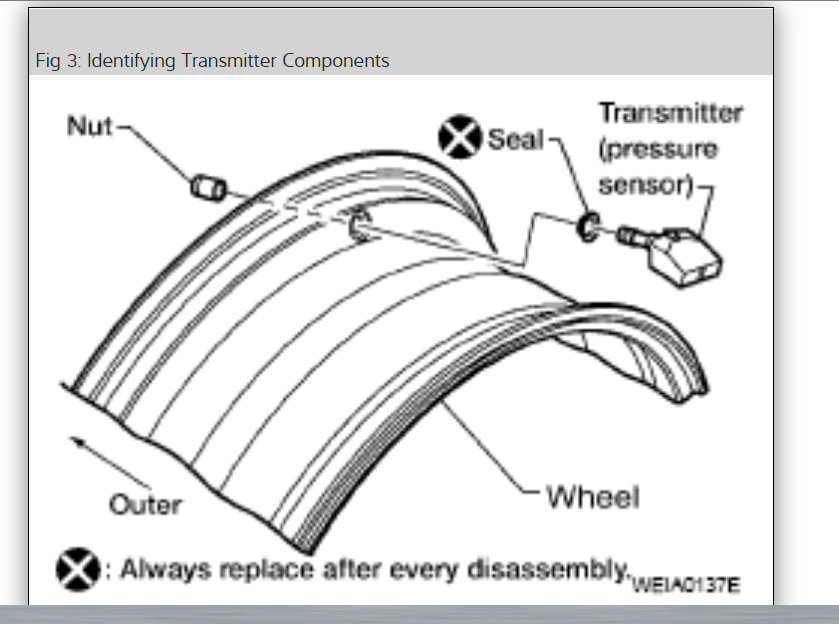

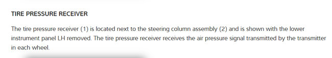

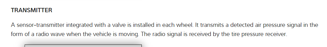

No DTC codes at all. I'm convinced it's the TPMS antenna. This all started when I had a tire failure on the freeway. It was the left rear. I have looked in the wheel well hoping to spot some damage but nothing obvious. I saw on ebay someone selling a TPMS antenna. It makes sense to me but I can't find it. Any idea where it's mounted?
May 19, 2019 at 4:56 AM
SCGRANTURISMO
  • 4,897 POSTS
I have included the information that you requested in the diagrams down below. Please go through this guide and get back to us with what you are able to find out.
