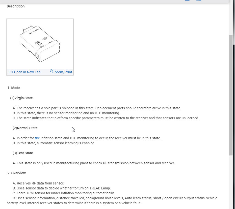

I need to replace my vehicle in learn mode so I can relearn the TPMS. I will be using a EL-50488.
OEC-T5 tool. Thanks
Dec 24, 2019 at 5:47 AM

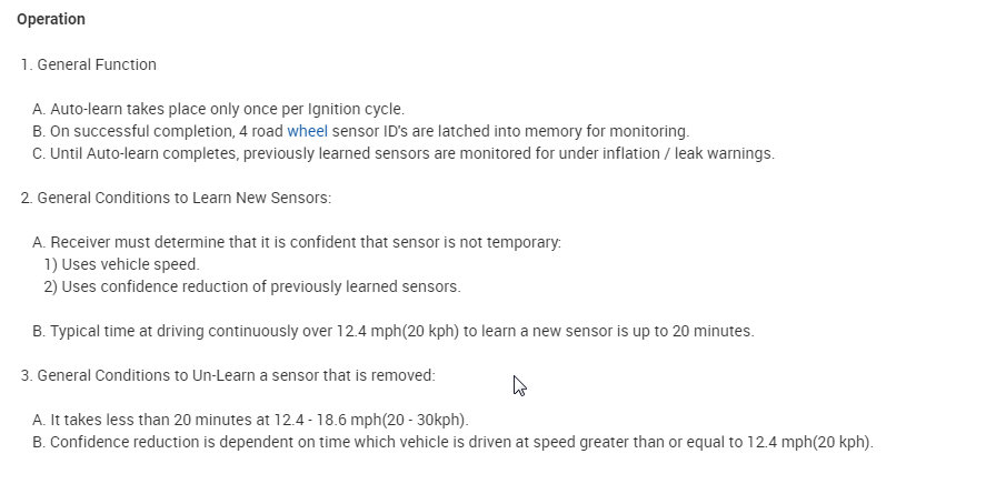

This system has an auto learn system. So it needs vehicle speed over 20 MPH for 20 minutes to learn new sensors. I attached the detail from the manual. Let me know if you have questions.
I am sure there is a way to manually enter the learn mode on the OEM scan tool but that detail is not in the service manual.

Been trying for the last couple of days still cannot make work. any other ideas?
Dec 30, 2019 at 9:09 AM
Is the tire light on? Have you checked for codes? If the light is not clearing then I suspect there is still another issue with the system.
