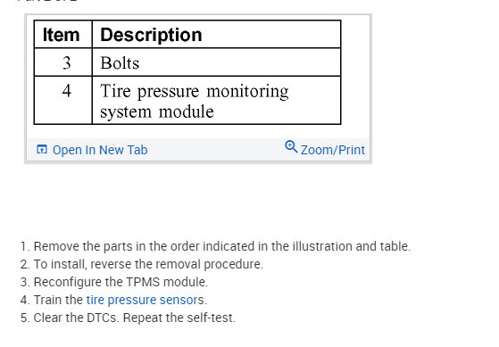

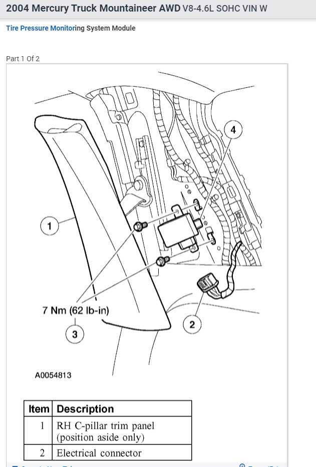

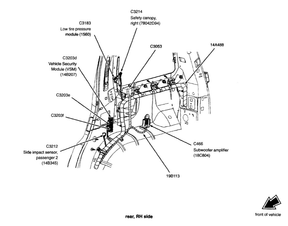

TPMS location needed.
Feb 7, 2022 at 12:07 AM
SQM
  • 6,383 POSTS
The TPMS module is located behind the trim on the rear passenger side C- pillar trim.
The C - pillar should pop off and that will expose the module. Which is mounted with two screws.
https://www.2carpros.com/articles/low-tire-indicator-warning-light
