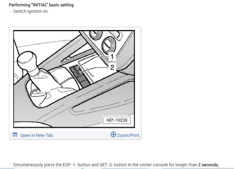

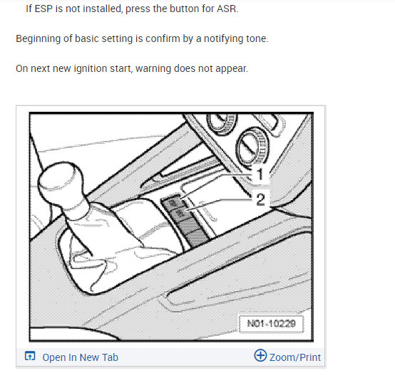

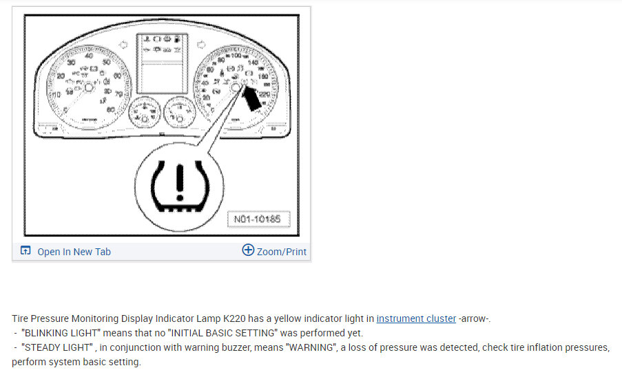

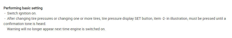

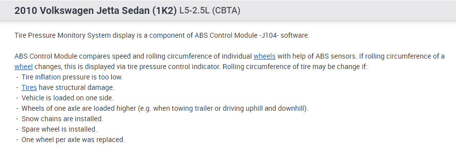

That is the likely problem. As far as the coding, you need the code. It usually can be found on a label attached to the side of the radio. The serial number is also stamped on the side of the radio. If the code isn't there, I believe the code can be retrieved using the serial number of the radio. Do you still have the OEM radio? Does the radio work?
I'm seeing a connection between the code you provided and the aftermarket radio. However, I am still trying to link them together with the TPMS issue.
I attached the basic reset for the TPMS system. I suspect you have already tried this.
