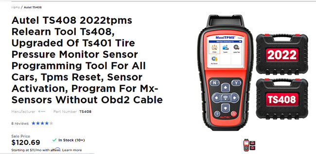

I don't currently have access to a TPMS tool, do you have any recommendations for one that should work for my jeep?
May 8, 2023 at 1:47 PM
  • 110,244 POSTS
There are a lot of different ones. I attached a pic of one below that would do what you need. They aren't cheap. For this model, this was the lowest price I could find. See if you can find a less expensive one that does the same things.
I hope this helps.
See pic below.

Thank you for the recommendation. Is this a tool I should be using every time I rotate my tires as well?

I finally was able to get the tool you recommended and checked the tires. Four of the five tires read just fine, and the batteries are in good condition. The fifth tire (Drivers Rear) would not read after multiple attempts. Is that one sensor the root of all the codes?
