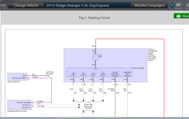

TIPM diagram
2010 DODGE AVENGER
167,000 MILES • 2.4L • 4 CYL • 2WD • MANUAL
RICHARD WHITMAN2

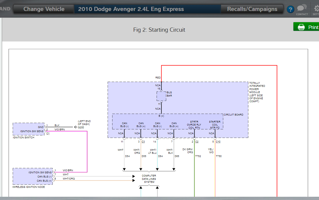

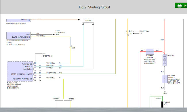

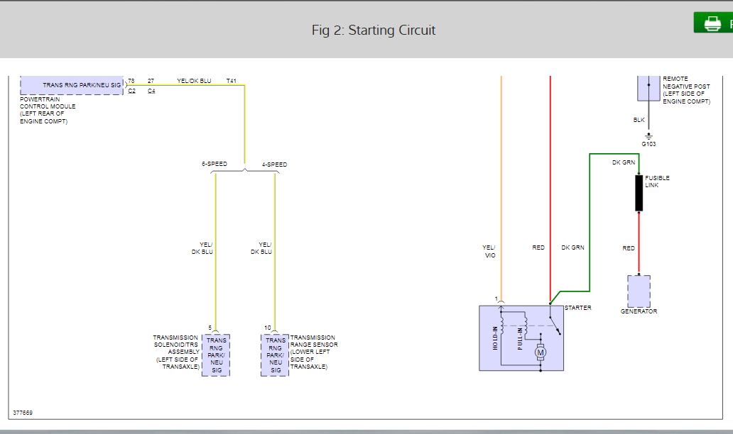

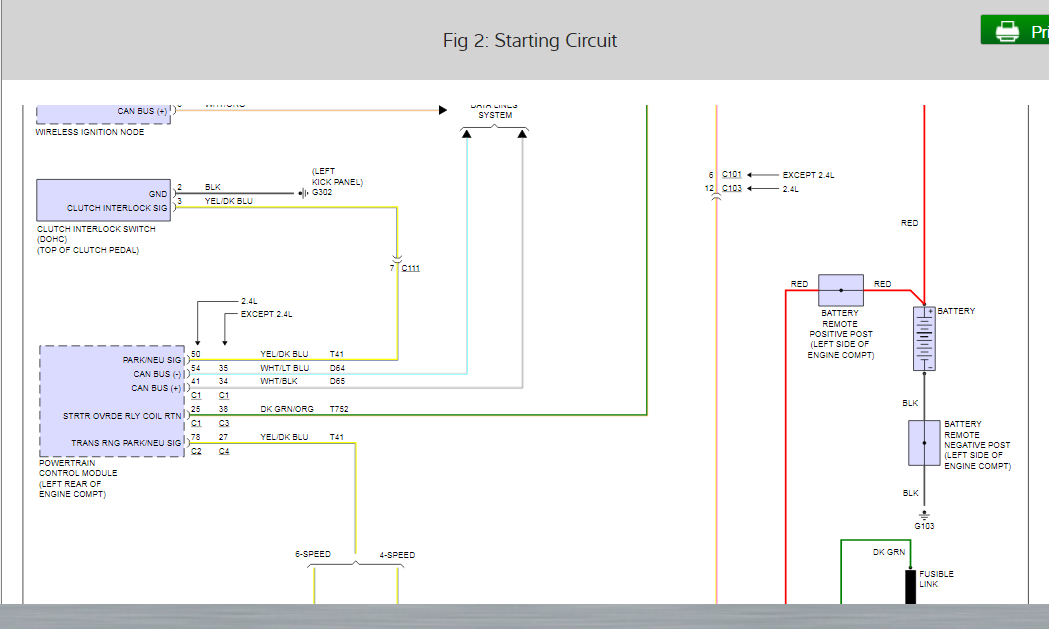

No crank no start. Stater good. Need to trace wires from ignition to TIPM to starter for testing.
Apr 22, 2019 at 8:20 AM
SCGRANTURISMO
  • 4,897 POSTS
I have included the information that you requested in the diagrams down below. If you should have any other vehicle related questions, please feel free to ask. That is what we are here for.
