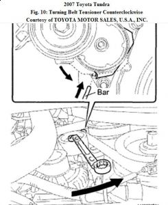

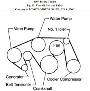

2007 Toyota Tundra V8 Four Wheel Drive 45000 miles
Where is belt tensioner located and is used with drive socket and if so what size
Aug 9, 2009 at 2:04 AM
KHLOW2008
  • 41,814 POSTS
Hi Mannr, Thank you for the donation. Here are the diagrams for the serpentine belt. I do not have the data of the bolt size and it should be either 14mm.
https://images.2carpros.com/forum/automotive_pictures/192750_BeltTensioner07Tundra3UZFEFig10_1.jpg
https://images.2carpros.com/forum/automotive_pictures/192750_BeltRouting07Tundra3UZFEFig011_1.jpg
REMOVE V-BANK COVER SUB-ASSEMBLY REMOVE NO. 1 ENGINE UNDER COVER REMOVE FAN AND GENERATOR V BELT. While turning the belt tensioner counterclockwise, align the service hole for the belt tensioner and the belt tensioner fixing position, and then insert a bar of ø 5 mm (0.197 in.) into the service hole to fix the belt tensioner in place. HINT: The pulley bolt for the belt tensioner has a left-hand thread.
