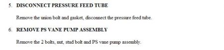

2003 Toyota Tundra V8 Two Wheel Drive Automatic
i have loosened all the bolts but the power steering wont allow me to remove it. do i need to remove the ps pump to get it off and if so how do i remove the ps pump

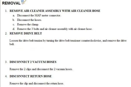

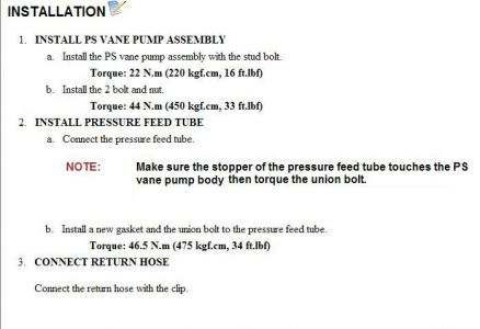

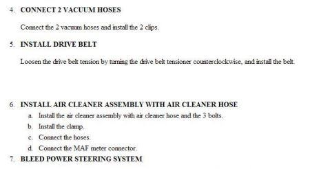

yep, power steering pump must be removed first..
https://images.2carpros.com/forum/automotive_pictures/261618_Noname_1328.jpg
https://images.2carpros.com/forum/automotive_pictures/261618_Noname2_399.jpg
https://images.2carpros.com/forum/automotive_pictures/261618_Noname3_149.jpg
https://images.2carpros.com/forum/automotive_pictures/261618_Noname4_72.jpg
